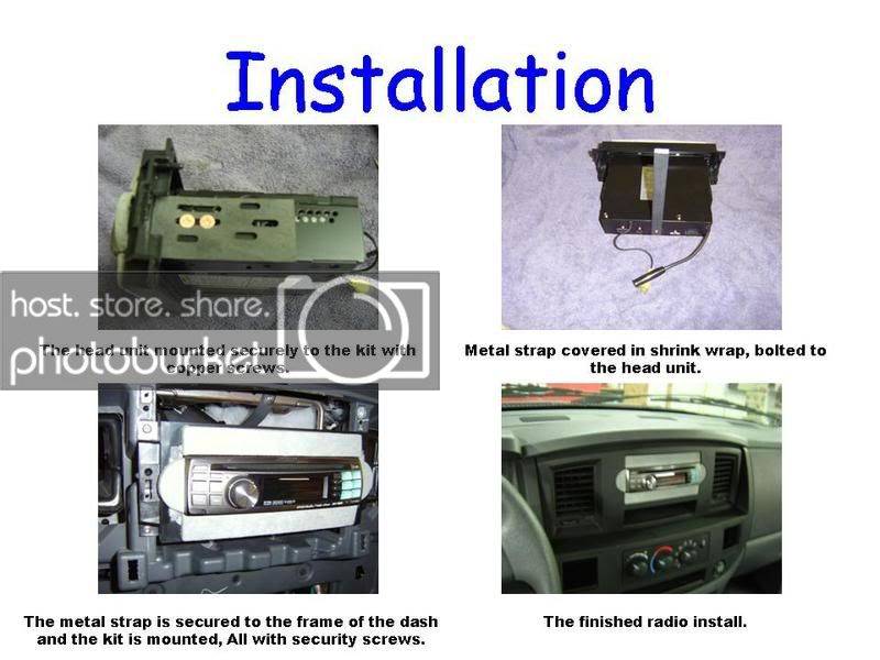

If it's that easy to steal then you might consider adding a steel strap and security screws to the HU to keep it locked down to the car so a crack head can't just pull it out.
Its all plastic around it, no where to really screw to that you couldn't just rip out, I would rather have the least damage if someone were to steal my deck.
Alarms For the Win.
HU's all have a screw thread somewhere on the body, not the face. Attach a steel strap with a security screw to the body of the HU and attach to the truck, not around the face.
A stereo that easy to remove can be jacked in seconds even with an alarm. A security system is more than just having an alarm.
Check this out, world champion SQ system with alarm... stolen. Next time he strapped in the HU:
