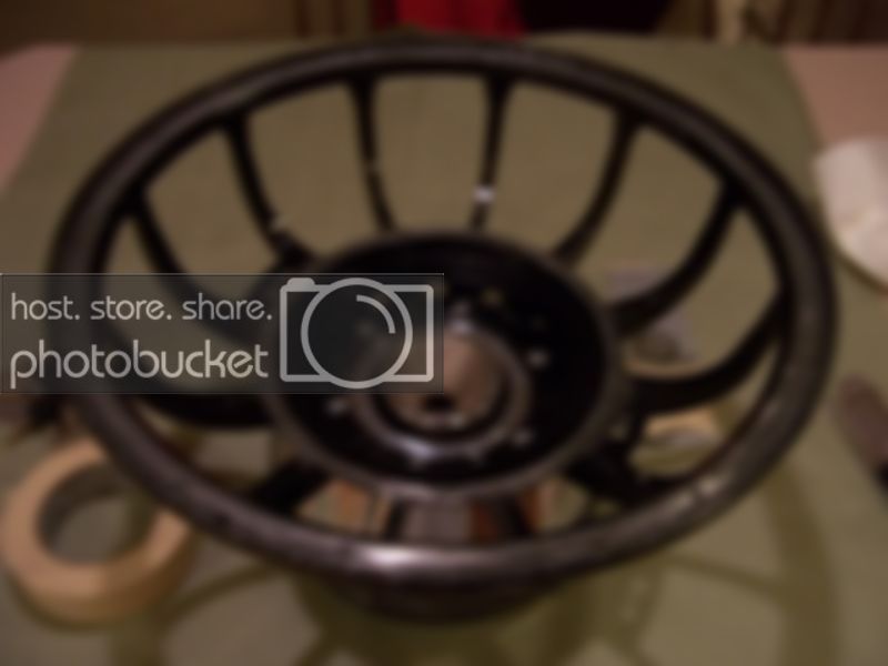

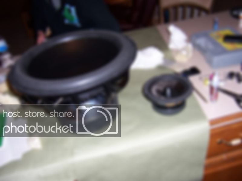

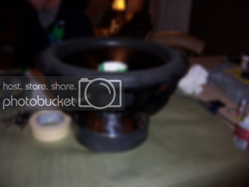

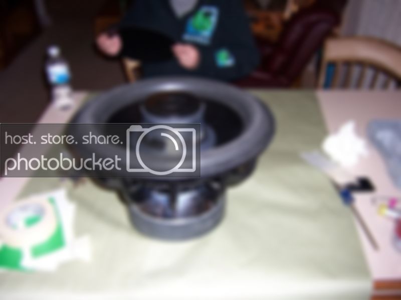

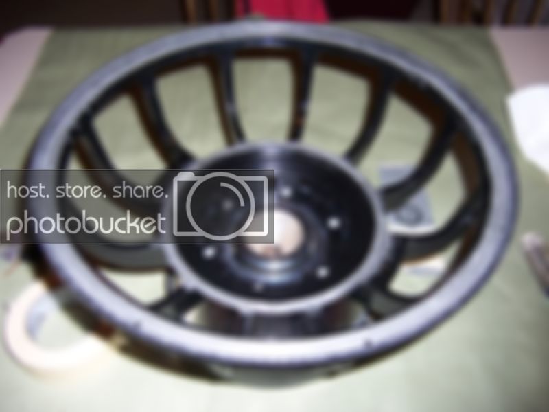

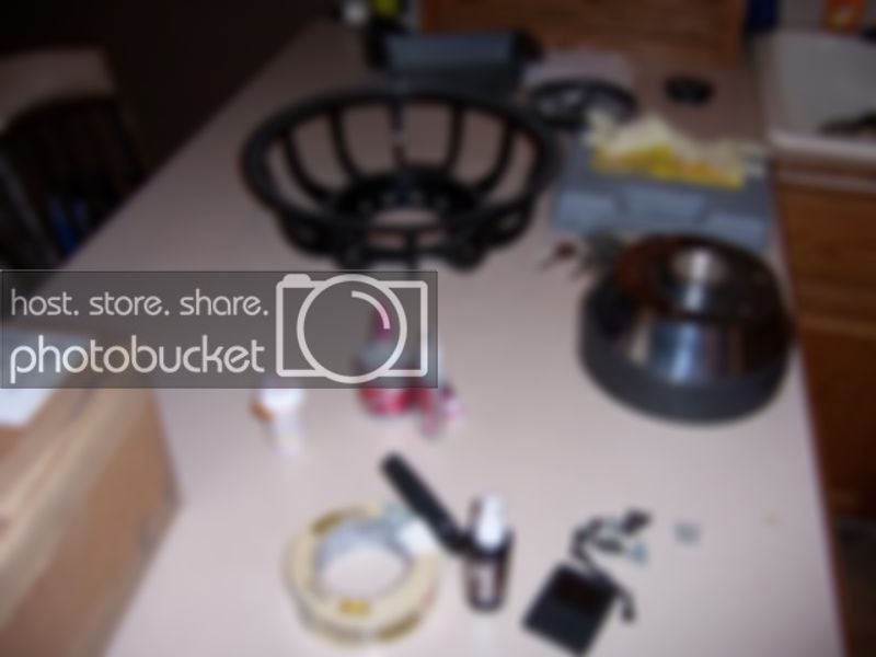

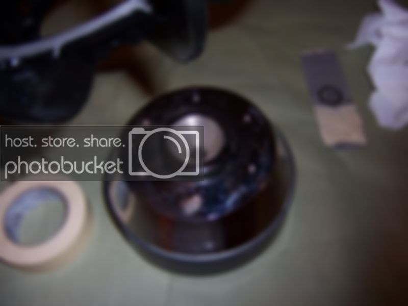

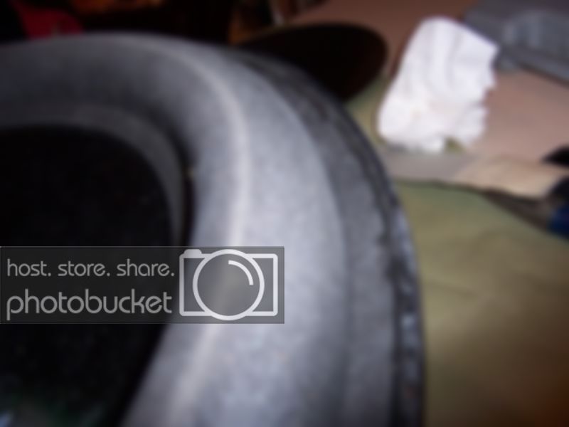

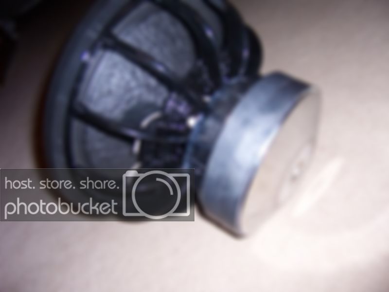

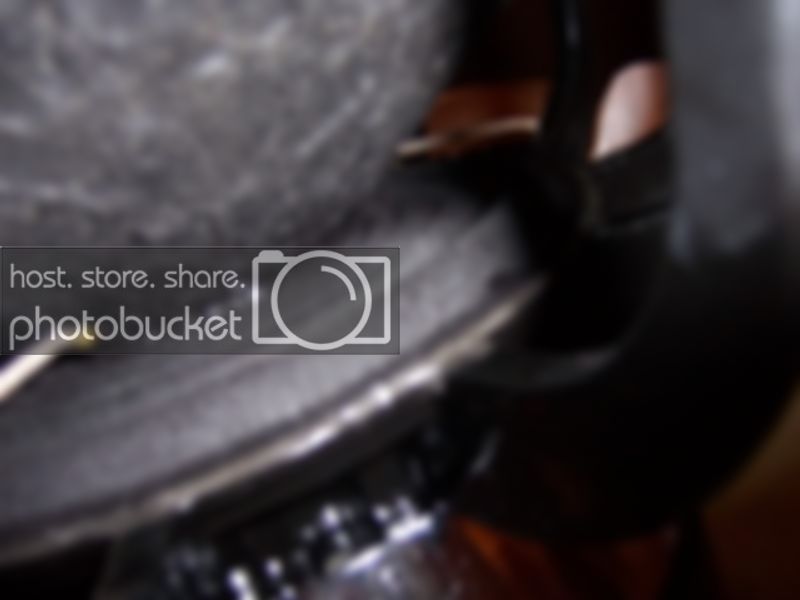

Well I was bored today so I decided to recone my XXX. Now, to cut to the chase, I need some opinions from some experienced guys.
Ive done a handful of recones but Im no expert.
Well, I cleaned up the basket, cleaned the gap, test fit the recone, shimmed it up tight, pulled it back out, laid down some glue, and dropped the recone back in and shimmed it.
Now, I shimmed it pretty **** tight, definitely tight enough, finished glueing it together, and then placed a mid on top of it for a minute while I waited to glue on the dust caps.
I cycled the suspension of the sub back and forth at this point and everything was perfect. I was very pleased, no rub, everything was great.
Then, I proceed to glue on the initial dust cap for the XXX, its the cap at the top of the coil former. At first I was a little leary about this cap, but proceeded to glue it on. I used a little bit of glue, but enough to hold it good. I was worried it might run down inside the former but I glued it on and everything seemed fine. Then I proceeded to glue on the **** cone and then I was done.
Well, I let it sit for a minute, I come back to push on the cone a little and make sure everythings still okay and guess what?
Somethings rubbing......//content.invisioncic.com/y282845/emoticons/crying.gif.ec0ebefe590df0251476573bc49e46d8.gif
This is what I think happened, I think the glue for the top cap ran down inside the former and is at the top part of the former, right near the gap.
Obviously with this rub the sub sounds terrible, and initially I couldnt even move the cone, the glue must have started to dry, I pushed it a little and broke it loose. Then I free-aired it off a small amp to see what was going on.
I shot a vid incase anyone wants to see it.
Give me some opinions here guys, Im hoping I can drop this thing in, hook it up to the KX2500, and beat the crap out of it for a bit to heat it up and hopefully burn this glue off.
I dont want to wait another month and have to recone this sucker again //content.invisioncic.com/y282845/emoticons/crazy.gif.c13912c32de98515d3142759a824dae7.gif
And Im pretty **** sure its not the coil itself rubbing in the gap, it was fine initially and it doesnt sound like a coil rub would quite sound.
And 10-20hz cycles it almost sounds fine, but above that is when it gets real scratchy, which is what has lead me to my conclusion.
Let me know what you think, pics in a minute.

Well thats the thing. I laid glue on the spider landing and surround then set the recone in and shimmed it. Pushed down firmly around the spider and surround. And came through with a little activator as I did so, put on some more glue, more activator once I was done.
Everything was shimmed fine and the glue was hard enough at that point that nothing was moving around at all. Period.
I set a mid on top for a little bit as I was waiting. And I pushed the cone up and down a little to make sure the gap was shimmed fine, which, it was.
It wasnt until after I glued on the initial dust cap that I ran into problems. Im confident it would have played just fine up to that point.
But after I got the caps glued on, I come back to check on it and I find that the cone is solid, wouldnt budge.
Immediately Im going wtf //content.invisioncic.com/y282845/emoticons/mad.gif.c18f003ab0ef8a0d9c27ca78d77a6392.gif
I push down a little and it broke free, immediately I thought there was glue in there. Just how it feels moving it up and down, and how it kept sticking and preventing the cone from moving any.
I played with it for a while so the glue wouldnt glue the coil in place or something, and after the glue in there dried up the cone still moves fine now. Except for the fact that there is still glue in there causing some rubbing.
At this point Im 95% sure glue is down in the gap, on the inside of the former, and thats whats causing the issue.
I know the gap was shimmed tight and it didnt move any after I pulled the shims.

Na, not really.
He used IC-2000, which sets up pretty quick compared to most. I also see a nice little brown bottle of Zip Kicker (man that shit smells pretty! //content.invisioncic.com/y282845/emoticons/smile.gif.1ebc41e1811405b213edfc4622c41e27.gif ) sitting there. The chance that the parts actually shifted is slim to none. He could have immediately pulled the shims and would have been fine.
When I cone a sub with CA, I always pull the shim just after setting the glue with a few sprays of activator. I do it all the time, always have, always will. I have NEVER had a set of parts shift to the side and cause any rubbing issues.
Now on the other hand, I've seen glue run down the inside of the former on countless RE subwoofers. Hell, I've had it happen to me probably 20+ times. lol
