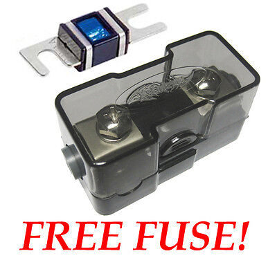

Get a 60 amp fuse with the holder. This needs to be placed at the amplifier, the other fuse and holder needs be at the Vehicle Battery.
