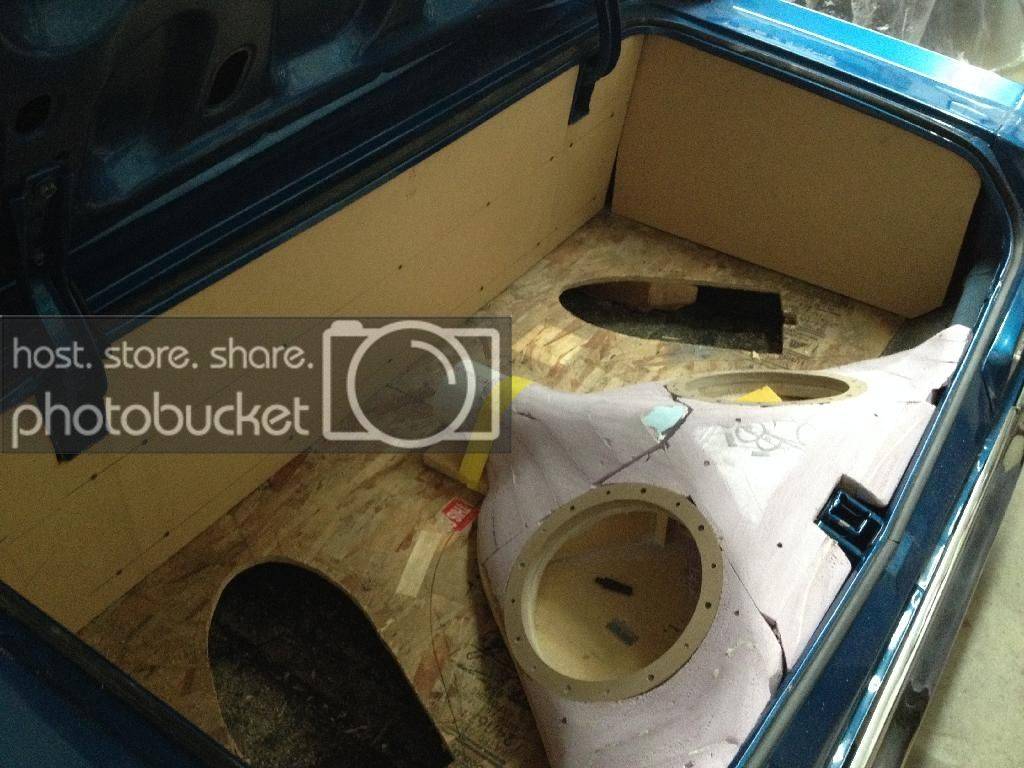

So in the back of my impala's molded trunk i have a tiny-tiny sub box for 2-10's to be mounted inverted. Kind of downward firing setup. Each box is roughly 11" x 11" and is a small wedge in height maybe 6" at the back maybe 2" and the front.
Obviously looks were the main focus and sound was far from being a main concern. I have had (2) JVC WG1000 subs inverted mounted for years and they sound pretty awful, not punchy, kinda blah muffled sounding. They were mainly picked for the cool cast baskets at the time, they require 1 cube sealed, I realize the box is no where near that.
Since I have invested recently in the rest of the sound system, now is the time to get some new subs. I am going for a SQ type system, just looking for some nice punchy clean bass. I have an Infinity Kappa One amp powering them 800x1@2ohms. Looking for some recommendations for this less than ideal situation in the $100-$175.00 each range, cool looking baskets are a plus. Just want something that is going to sound better and have some kick.

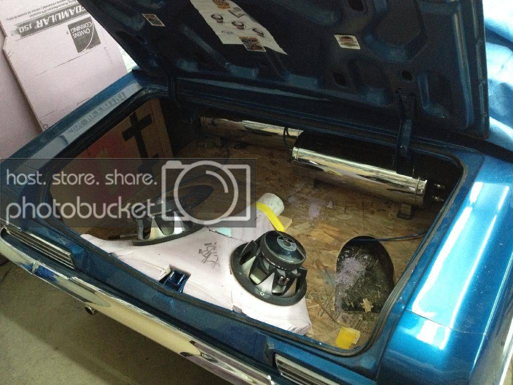

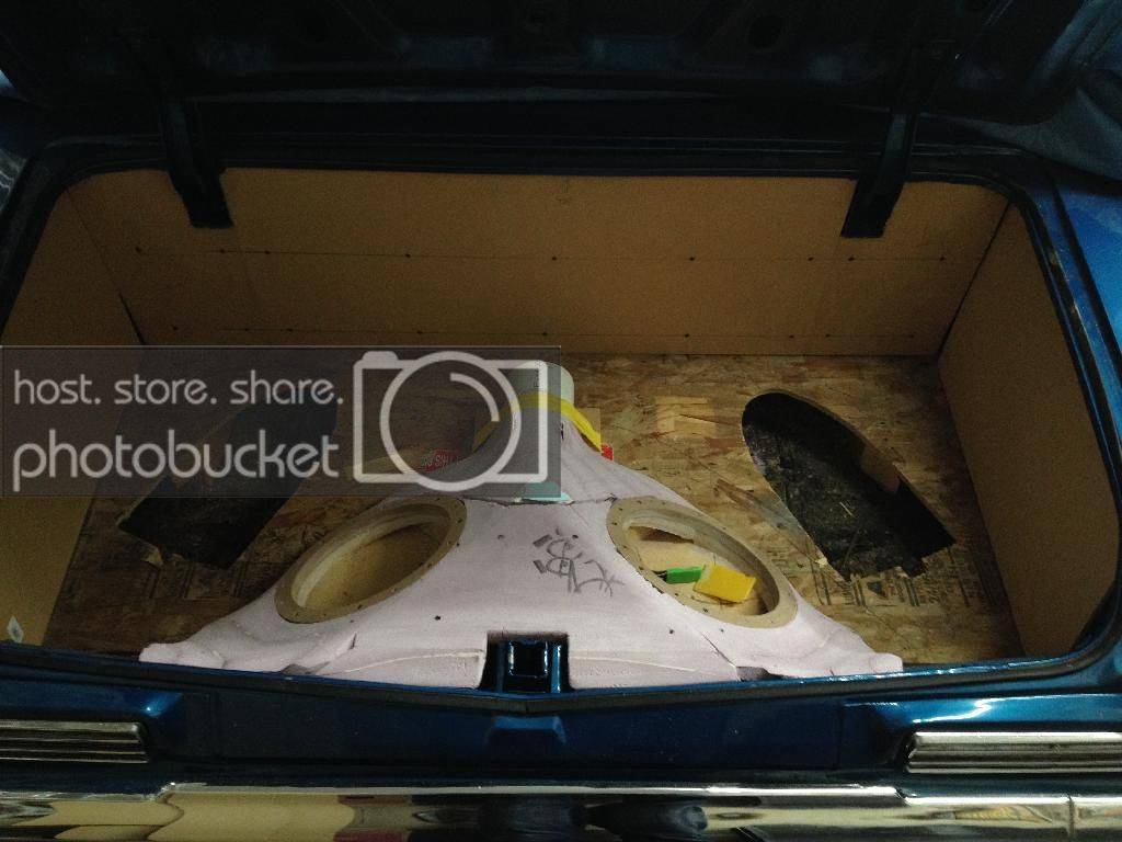

Some in progress photos to better illustrate my issue..

Is that a port?
I assume that is a sealed enclosure there, and I'd probably recommend running two beefy 8s sealed in that little space. But if you want to know which 10s have good performance in small sealed boxes and have less than 4.88 inches of mounting depth inverted I'd say sundown SD-10s all the way. Though again the SD-8s would probably even better if you could find a way to secure a 8" inner diameter ring into there without sacrificing more mounting space.
Yeah it is a sealed box... I have thought about the SD-10's and i like them, and sundown has a great reputation here. I'm not familiar with the elemental designs, let me know the model, and I can look into them. As for the power, I will eventually upgrade from the kappa one, sadly I shelled out the money for it before I became a member here. So I am going to keep it for awhile.
