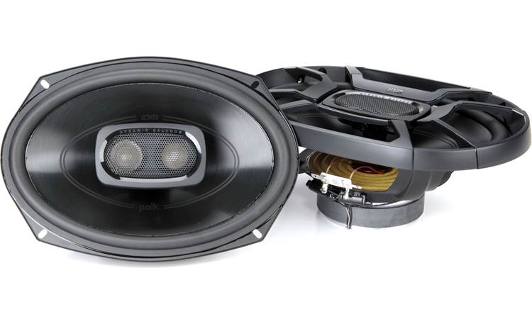

Not sure which Polk comps you have so something like these or whichever the 6x9 version of the Polks you have are, the same tweeter type being the most important part of that decision.
