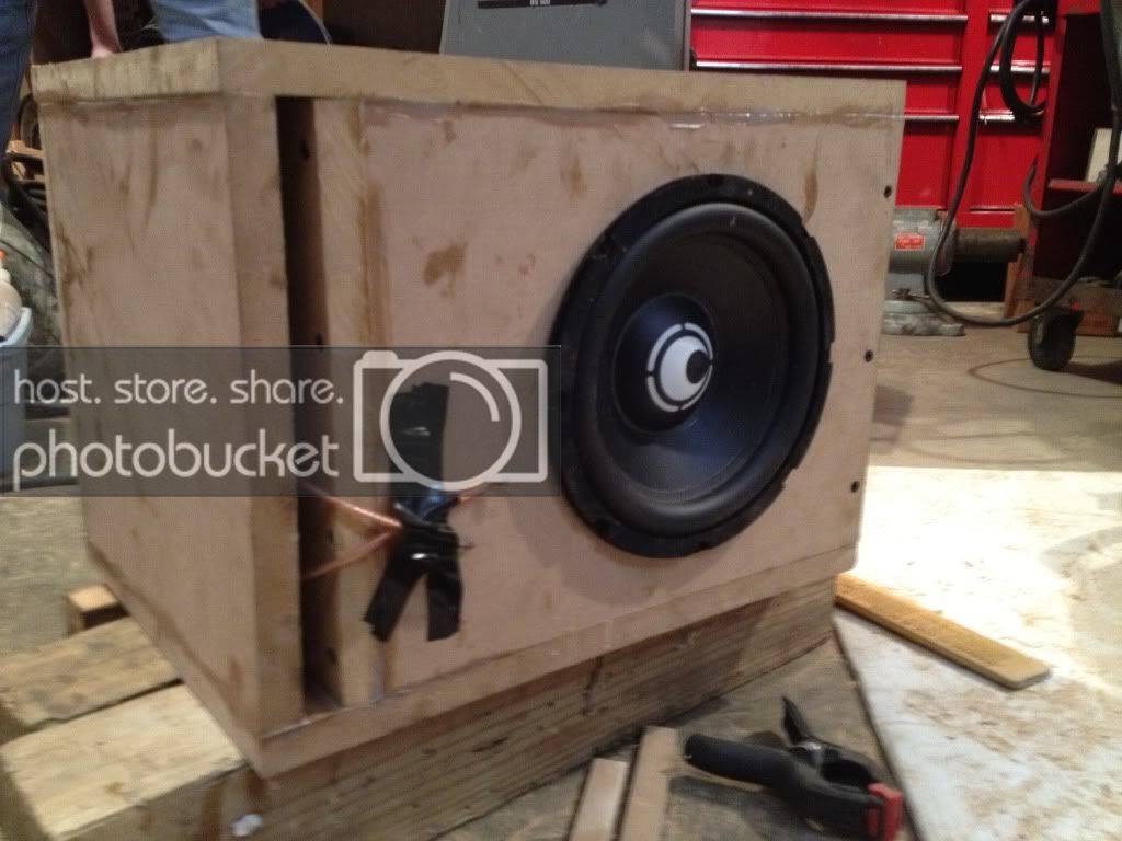

I'm probably taking this up to user error, because it seriously sounds like my door speakers are doing better with the lower frequencies than the RE8 is. I put this into a ported box, 1.3 cubes total (1.2 after displacement) the port is tuned to 34hz I believe. I was thinking maybe the box is just a tad too big?

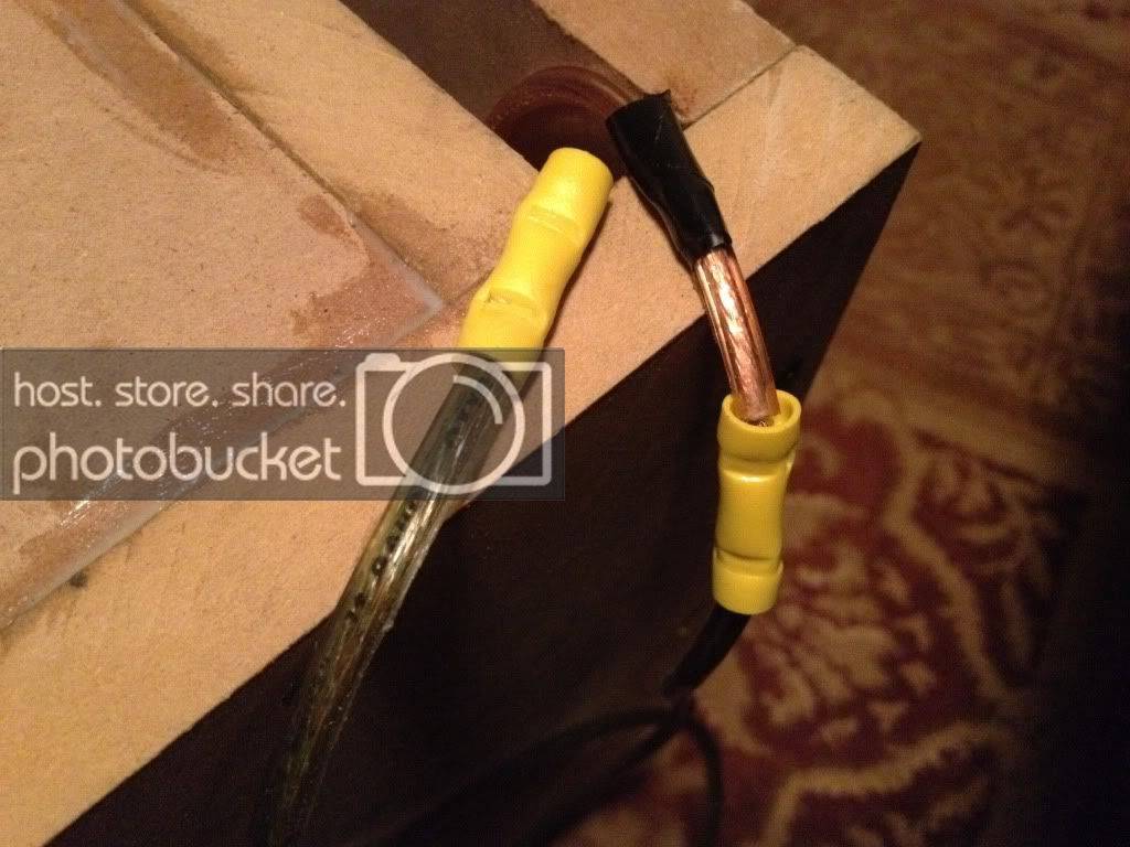

Here is photos of the subwoofer box, and how the wiring is done.

1. Is my box too big for this sub?

3. Are the connectors I used for the speaker wire bad to use?

My friend and I must have calculated Everything wrong... I think we forgot about inside measurements etc. hmm. Wouldn't .85 cubes still be okay for this woofer? I'm unsure..
The port is to skinny, and you have a problem with your wiring. You should have the same resistance at the amp as at the sub. I'd first try to get rid of the connectors. Twist the wires together, and of course rap them in tape or a wire nut. Try it again. If it is better then replace the wires with longer ones so you don't need connectors.
I'd think your box will have a very high resistance in the port. As you turn up the power it will act more like a leaky sealed box than ported. You might have to go to more of a square port, or a round port, to make it work. And as others have said, the tuning is going to be off do to the box miscalculation.

Also, Thank you very much the post above, I'm thinking about replacing the piece that has the cutout of the sub and make a different one.
What would be your opinion on replacing the cutout piece and making another one with a round port in it? what size port would you suggest?
Also, I believe the connectors are also causing a problem. I don't know how my impedance lowers, because both coils alone are 3.8. I'll try cutting down the electrical variables tomorrow.

I would recommend for a quick fix if using same box,just put a new face, and do the cut out for the sub...1/2in or 5/8,so you dont rebuild the box.I recommend using approx a 2in round port approx 6 3/4 long.IMO.Id test it sealed also see how it sounds to you before porting.Be an oppritunity to double check the wiring config of the sub too, in making sure you have wired it to the right ohms load as well.Just my suggestions.4ohms is the min Id like to be at.
Thats what I was planning to do ^ Thanks for the port info though, thats probably what i'm going to end up doing. I've double checked the wiring config a million times now, it has to be the connectors I used, or possibly a loose connection at the speaker terminals.
