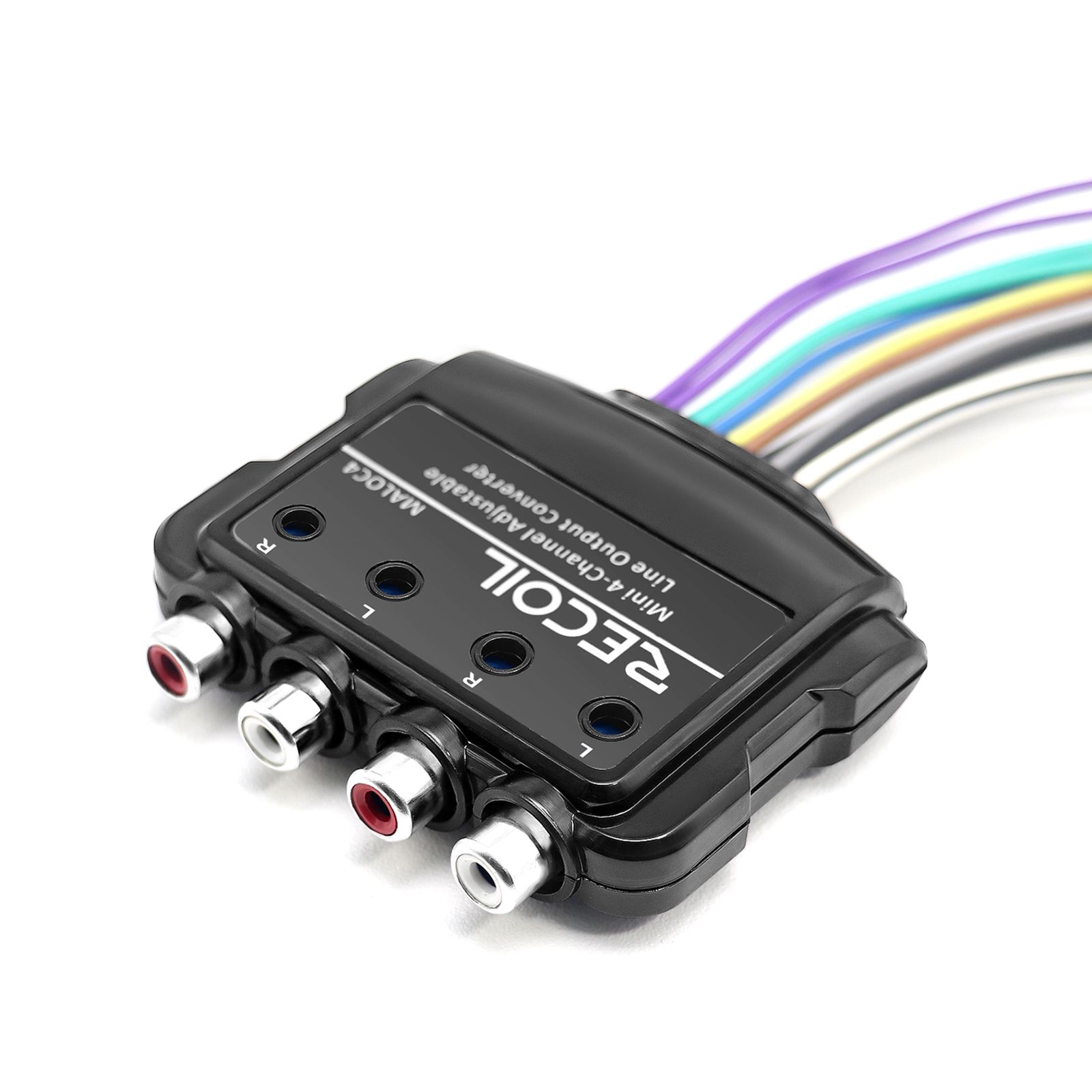

1aespinoza thank you. He's still using the factory radio so we just have a LOC spliced into the front and rear speaker wires for the signal.
If your using a cheap LOC then you loosing a lot of...Volume/power/sound quality.
Now putting a second amp on to the same output and taxing it even more
I don't what kind he is using but a good one make a world of difference
Cheap LOC= 1 volt pre out
Good one =6-8 volt pre outs
Dayton Audio makes a good one, you can get it at Parts Express
Audio Control makes the LC6i and I just saw it at Amazon for $182 (Can) so that's like what $120 US
Best $120 you will ever spend
It was a cheap one from Wal-Mart lol. I hadn't really thought about that so thanks for the input on that. Couldn't find one made by Dayton Audio on the Parts Express website but we live close to their store so might just go over there and see what they have. I'll tell him getting a better one is worth the money though. Thanks all for the replies on this.
