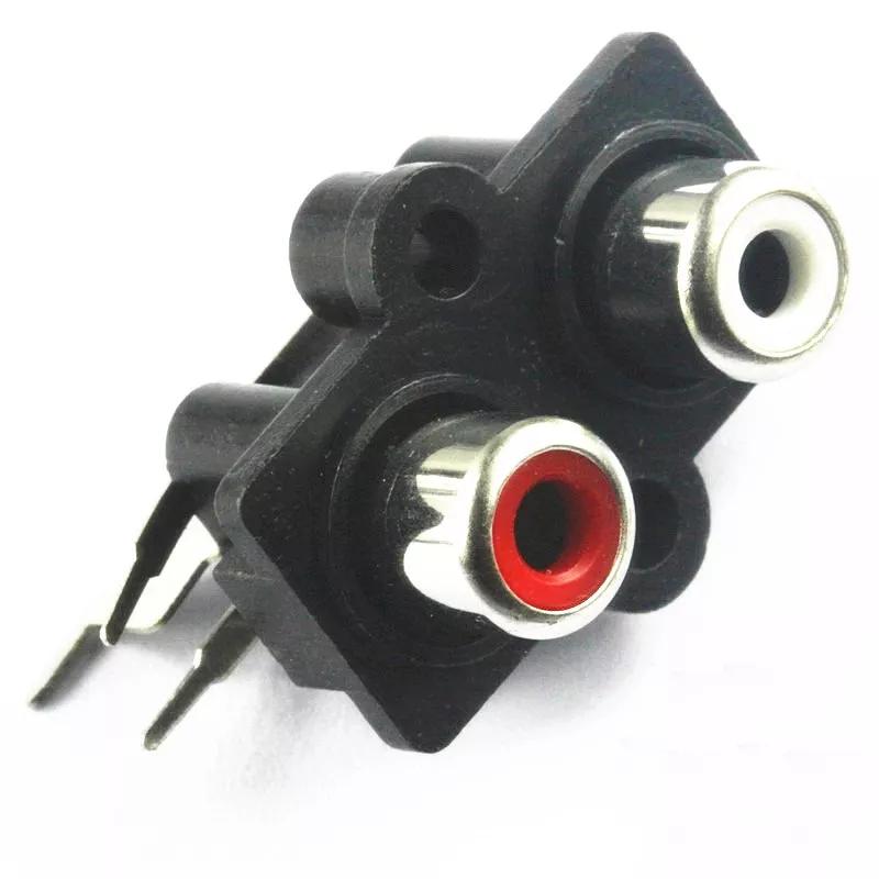

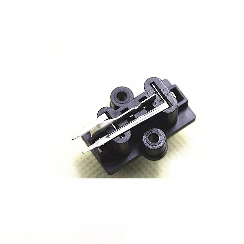

So I had a free minute to look up a gut shot of that amp.
Something like this looks similar, but you would have to take any measurements to see if the pin spacing, screw holes, etc, match up (although the ebay listing is crap and doesn't have any dimensions, lol). You can ignore the red / white colors as they won’t effect it and it will be much harder to find one with the black color. It’s the same basic connector, but that doesn’t mean it will fit.

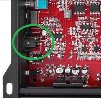

Gutshot found at Skars website of an rp1200.1 which may or may not have revisions from yours and might even be a generic stock photo, so its important to open your amp and match it up before buying any connectors:
