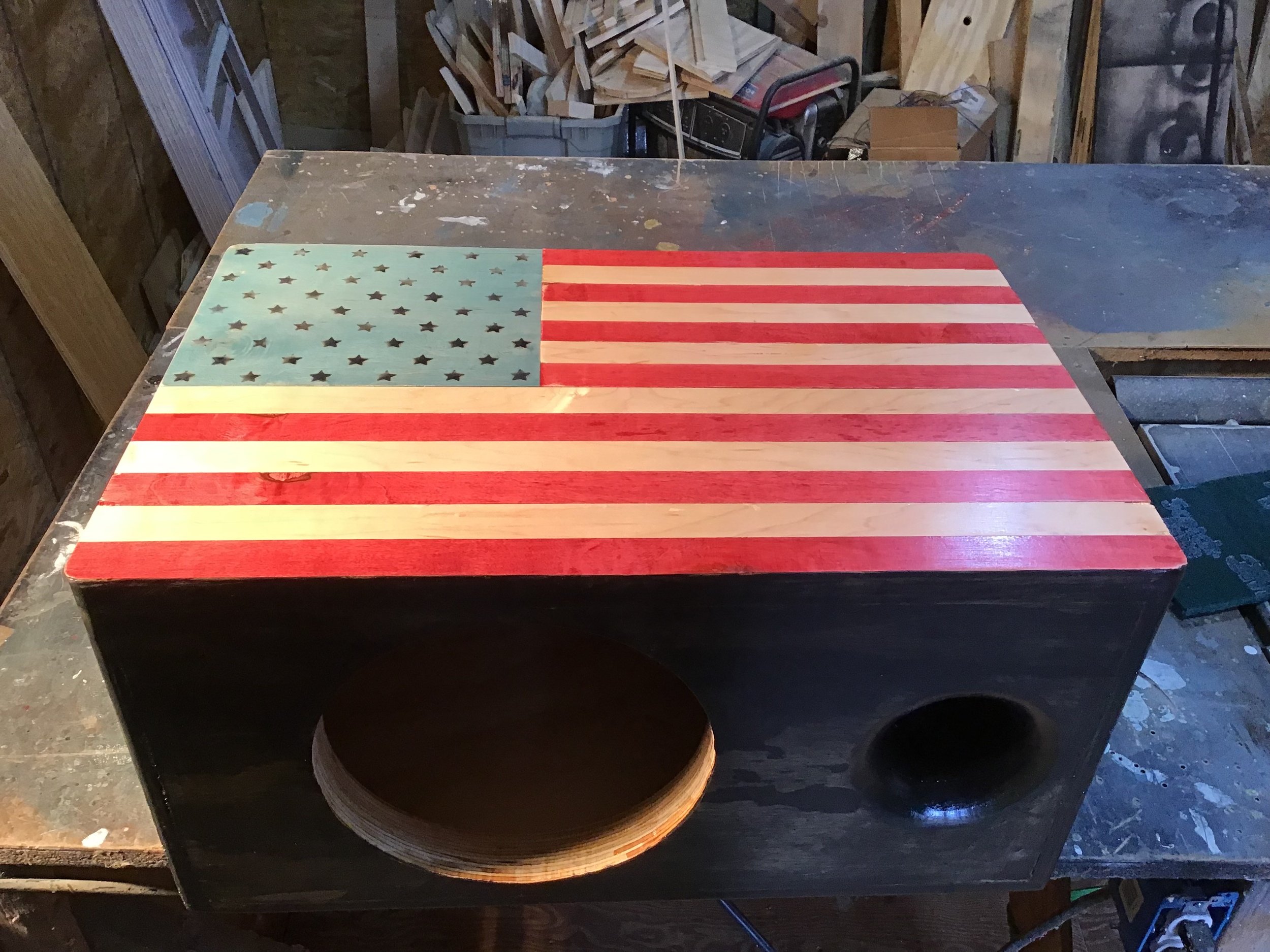

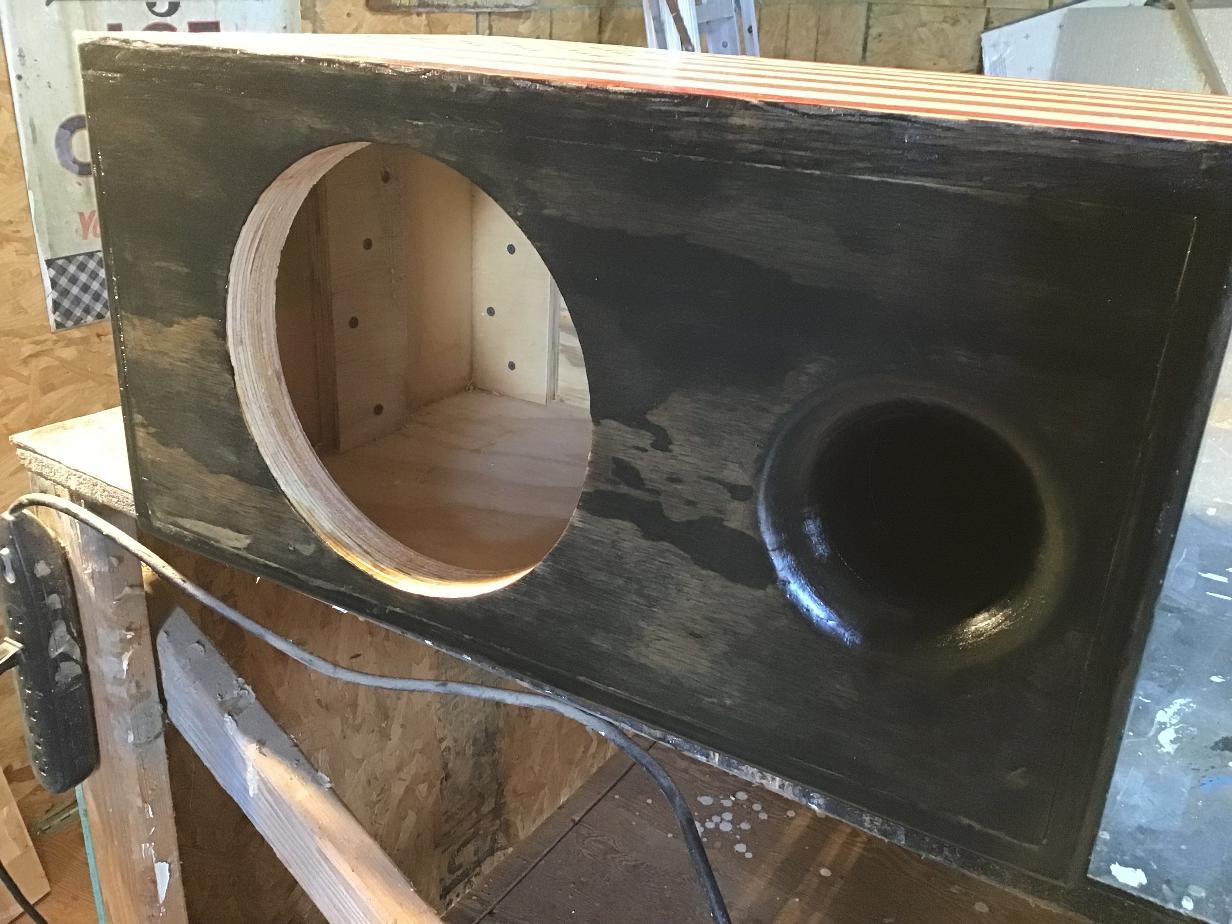

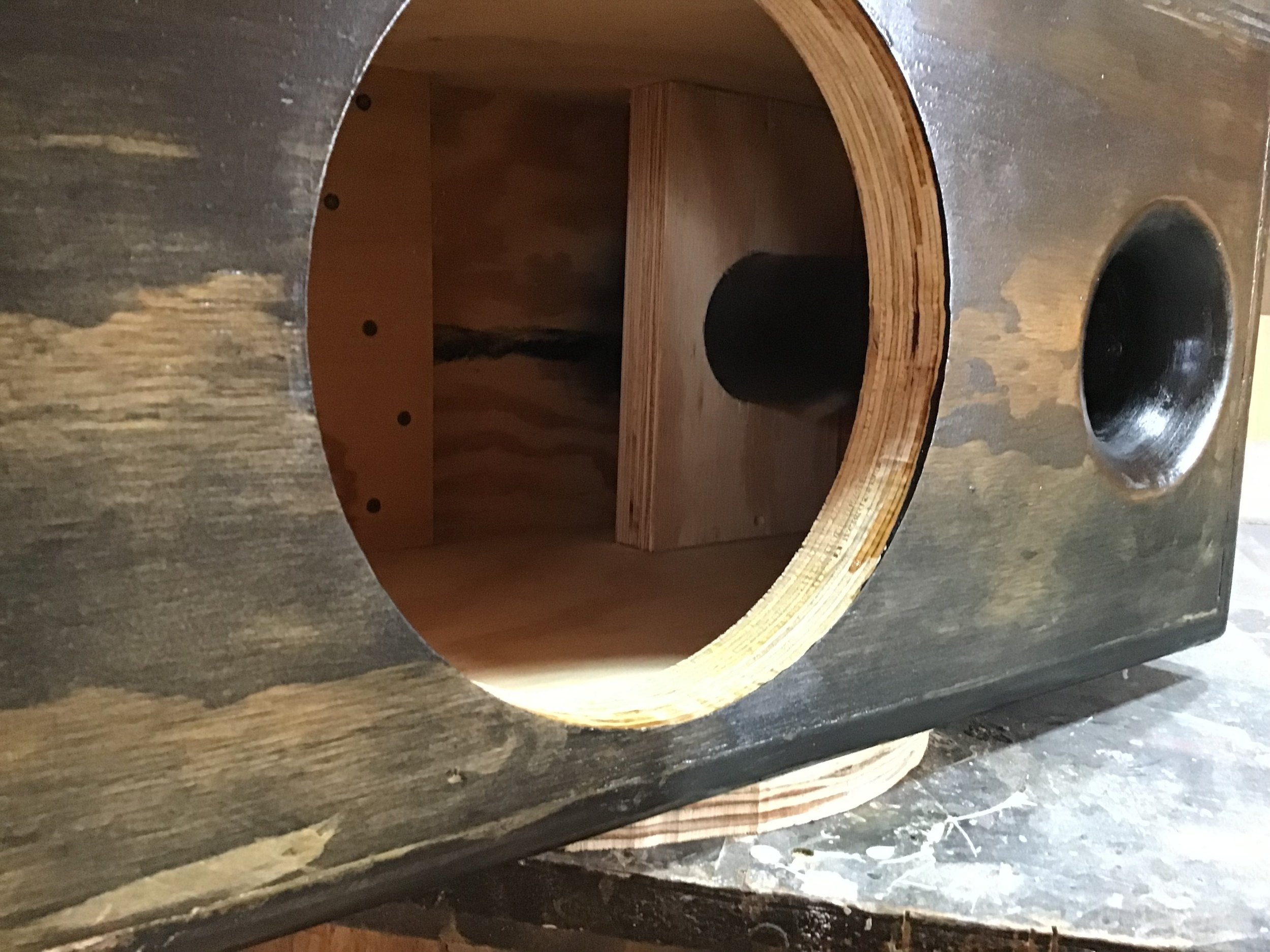

American bass XFL 10 inch enclosure. 1.3 cubes after displacements tuned to 33 HZ. 3 inch round port flared to 5 1/2 inches.
Sweet box. Are you happy with it?
No. I’m not totally happy. The blue stain on the flag is too light and the wood grains didn’t show up through the red stain like I envisioned. Also, the black stain for the rest of the box is more like dark brown instead of ebony. The one part I am happy with is the wooden flares on the ends of the round port. I can make aeroport enclosures at a little cheaper price not having to pay for aeroports. I can basically make a flared aeroport out of any cylinder of any size. I’m very happy and disappointed with this box simultaneously
