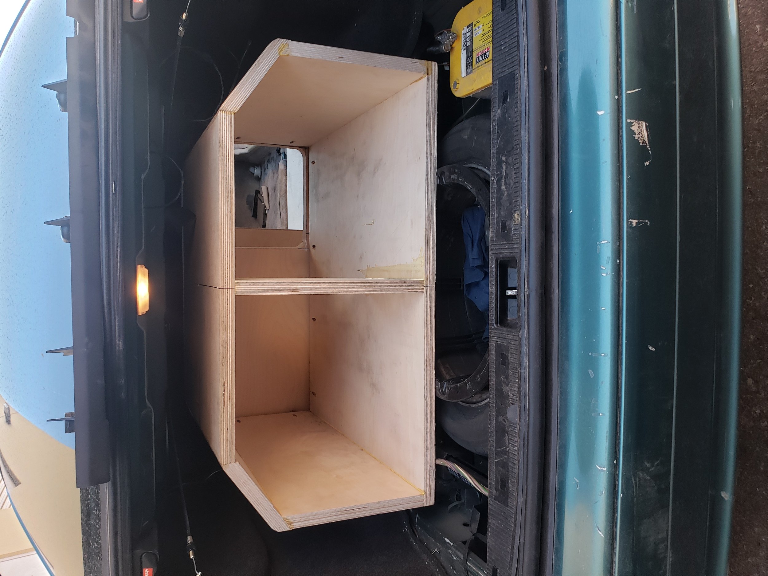

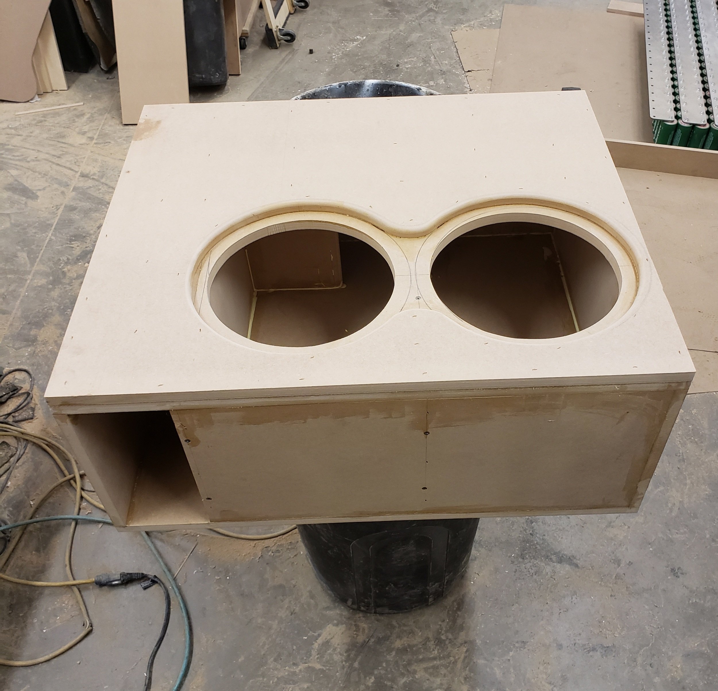

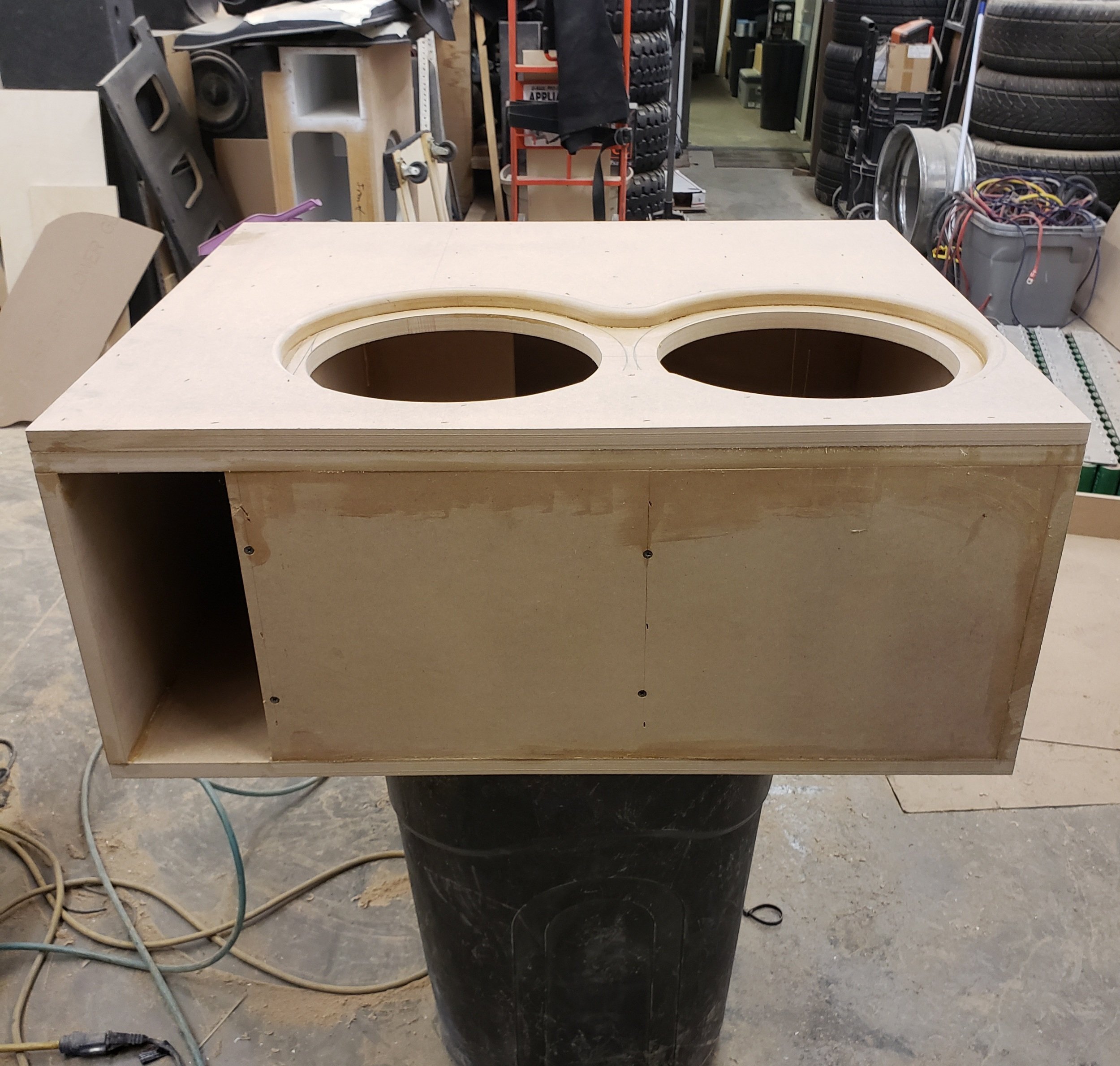

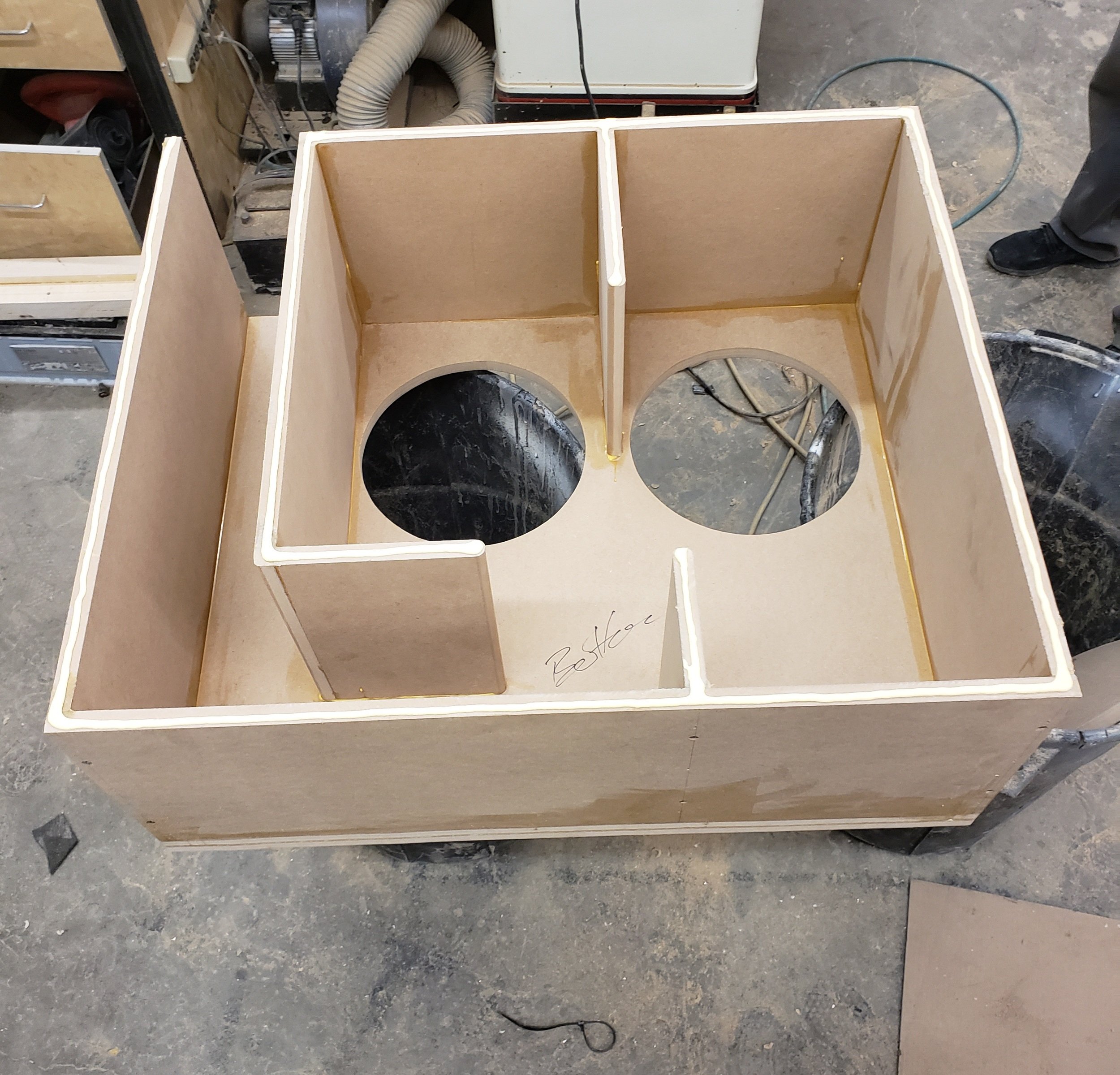

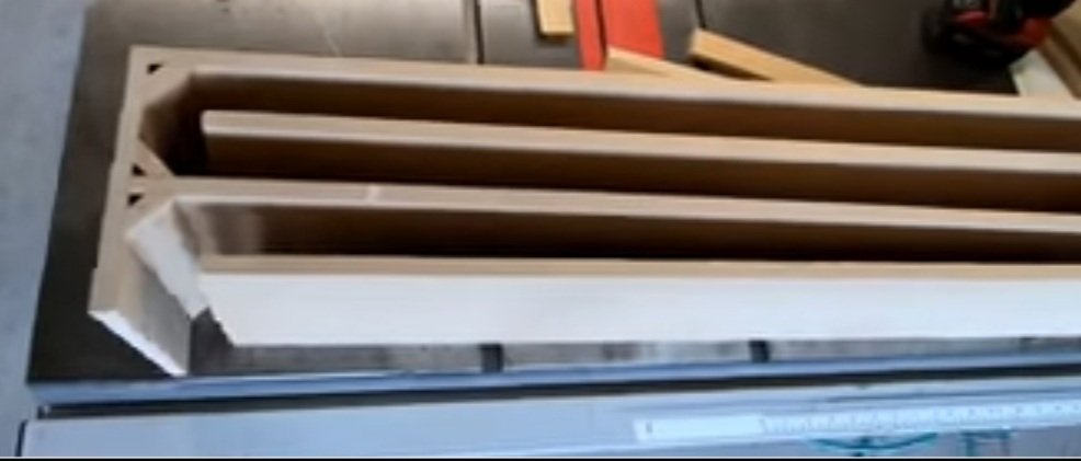

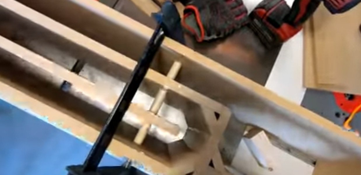

A box for 2-12" Sundown X's.

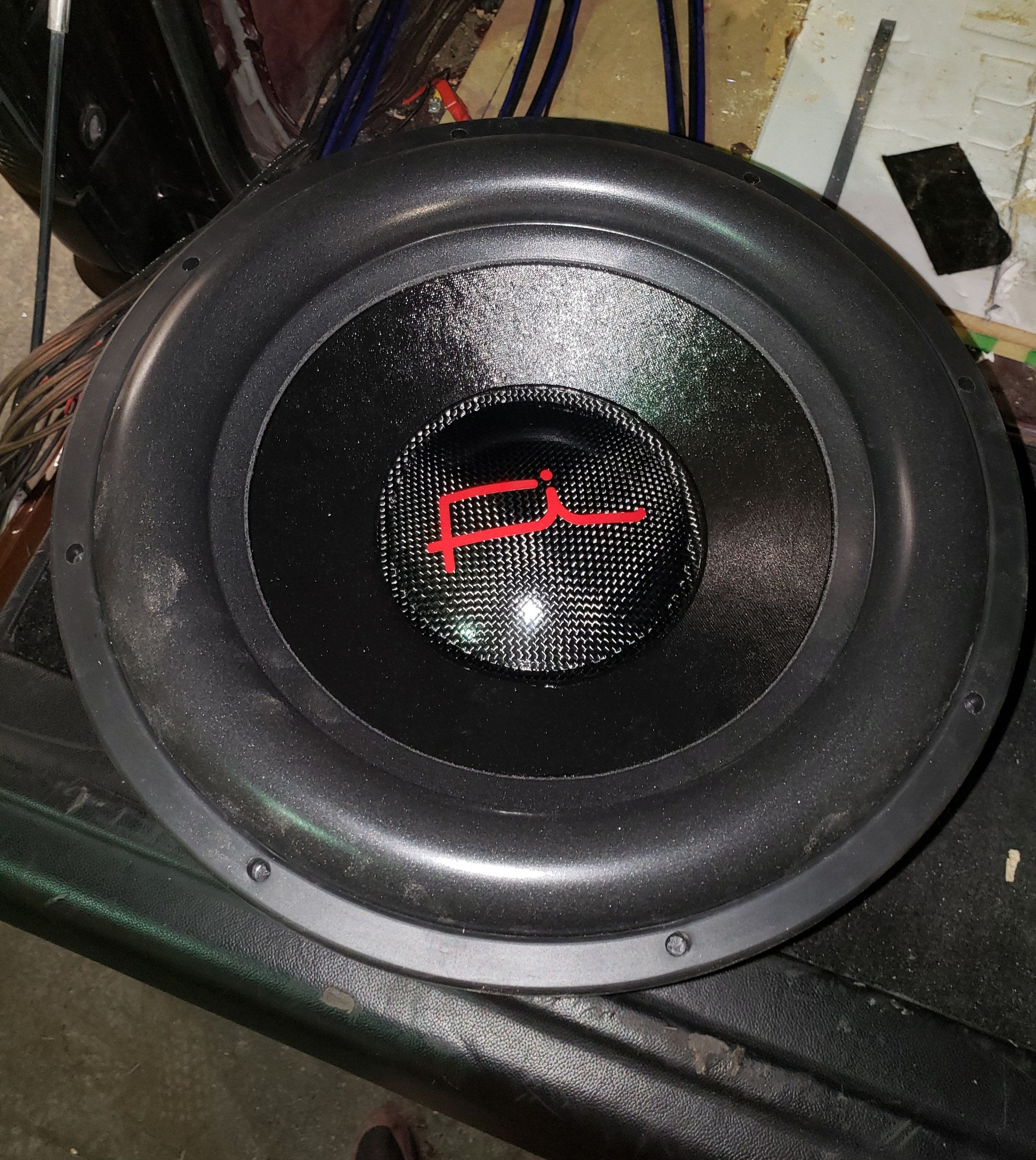

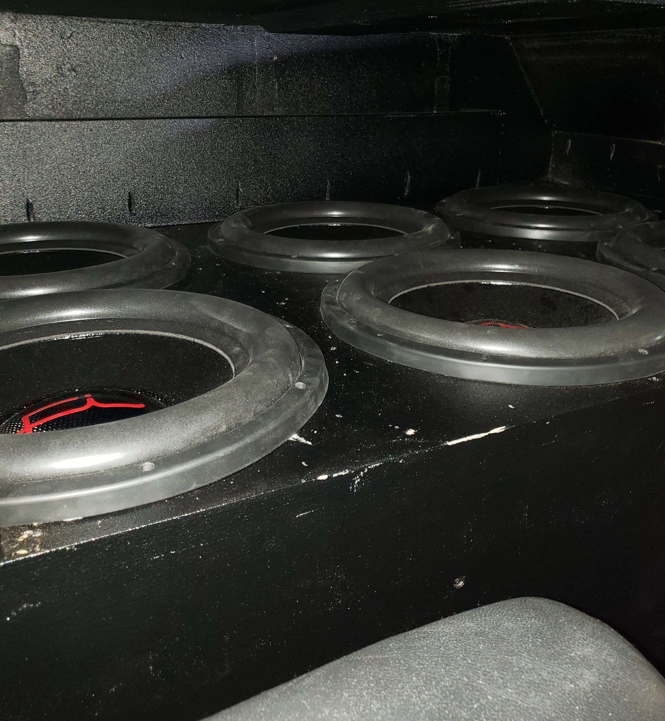

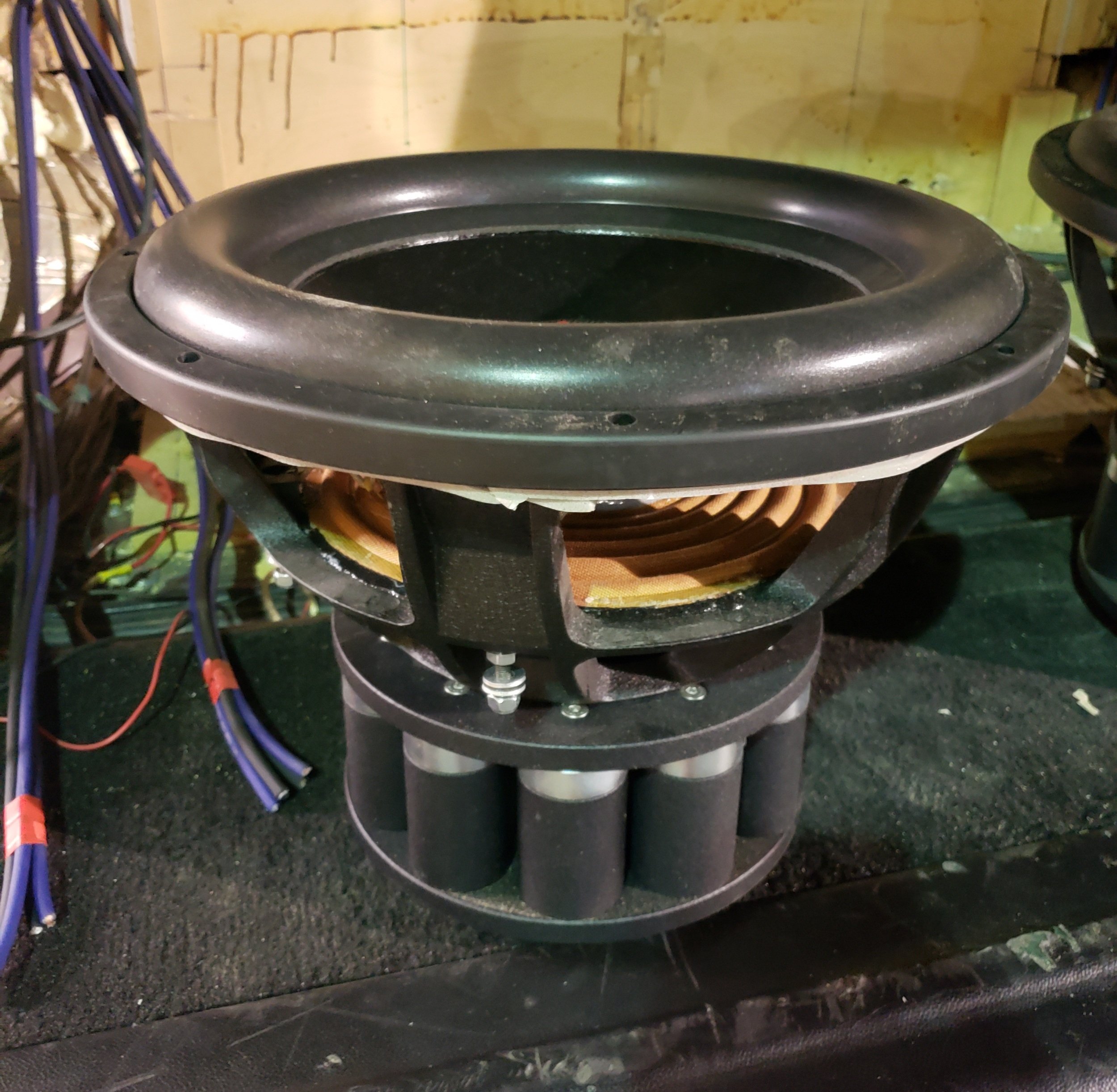

Those motors might make sense why it's punching so hard. I like those subs a lot; Fi is one of my very top favorite brands, personally. Yes, I've done similar tunings for some people. Usually it's only really big systems that go that low (from what I've been asked to design).
The owner of this truck knows the owner of Fi and had him custom build these. Fi is only about two miles from my buddy's stereo shop. He's thinking this build will probably be in the 164-166 db range. I was impressed when it floated the hoodie in the other video.

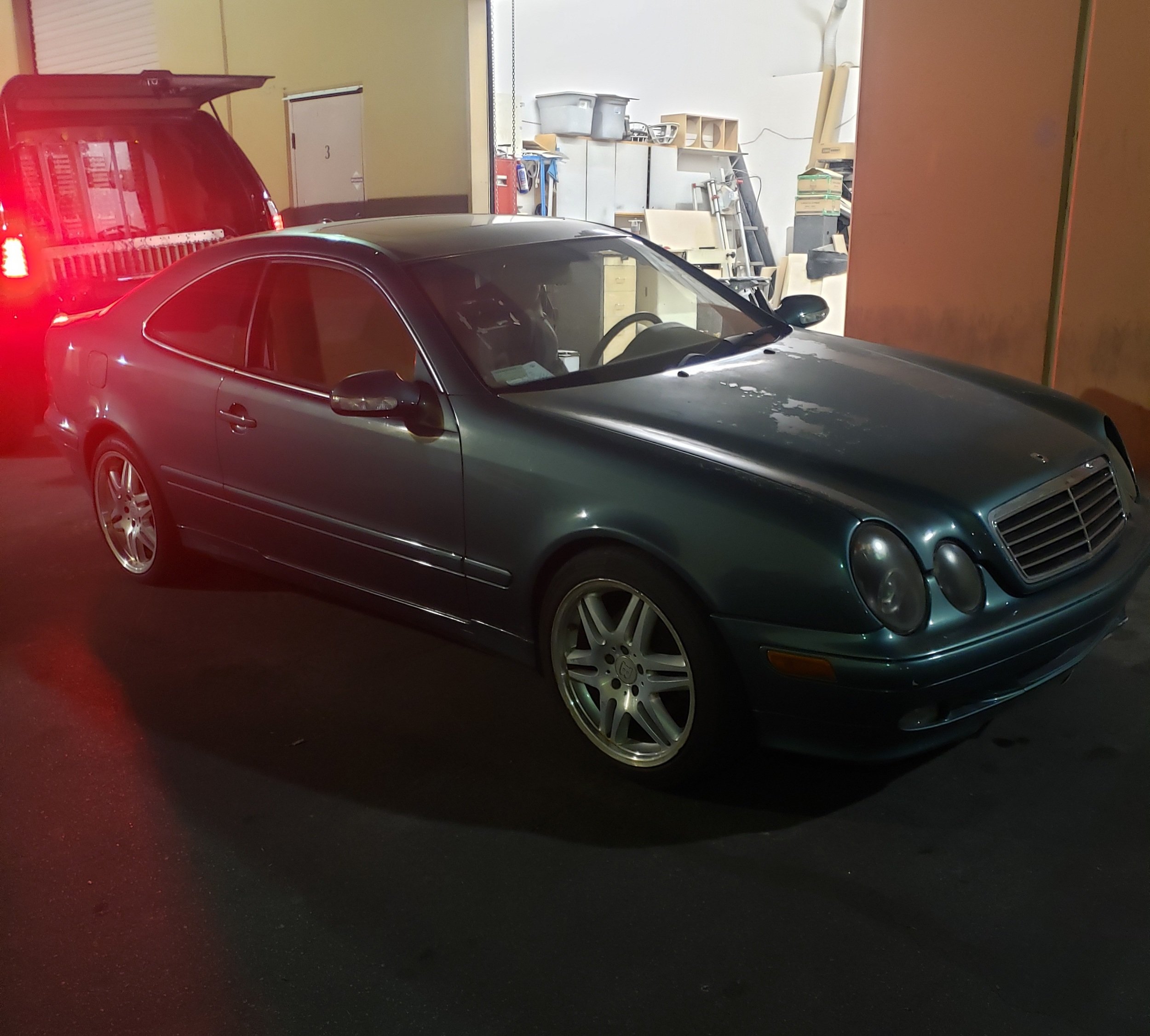

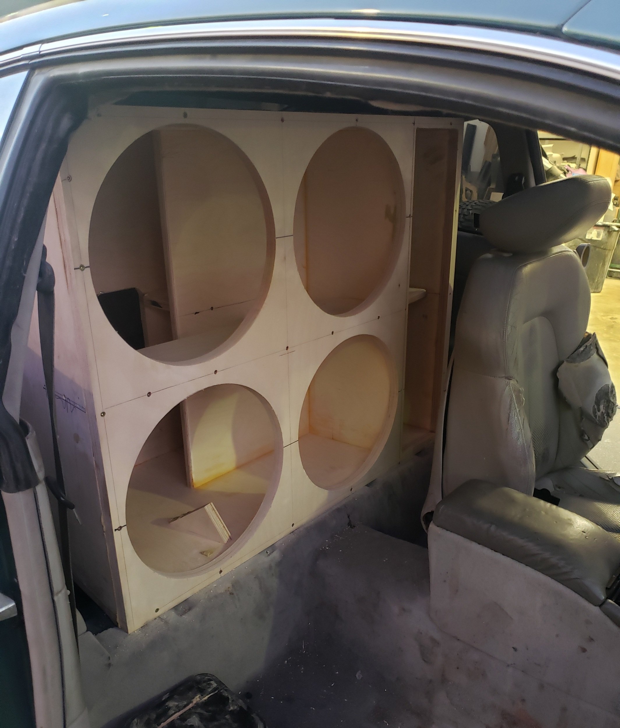

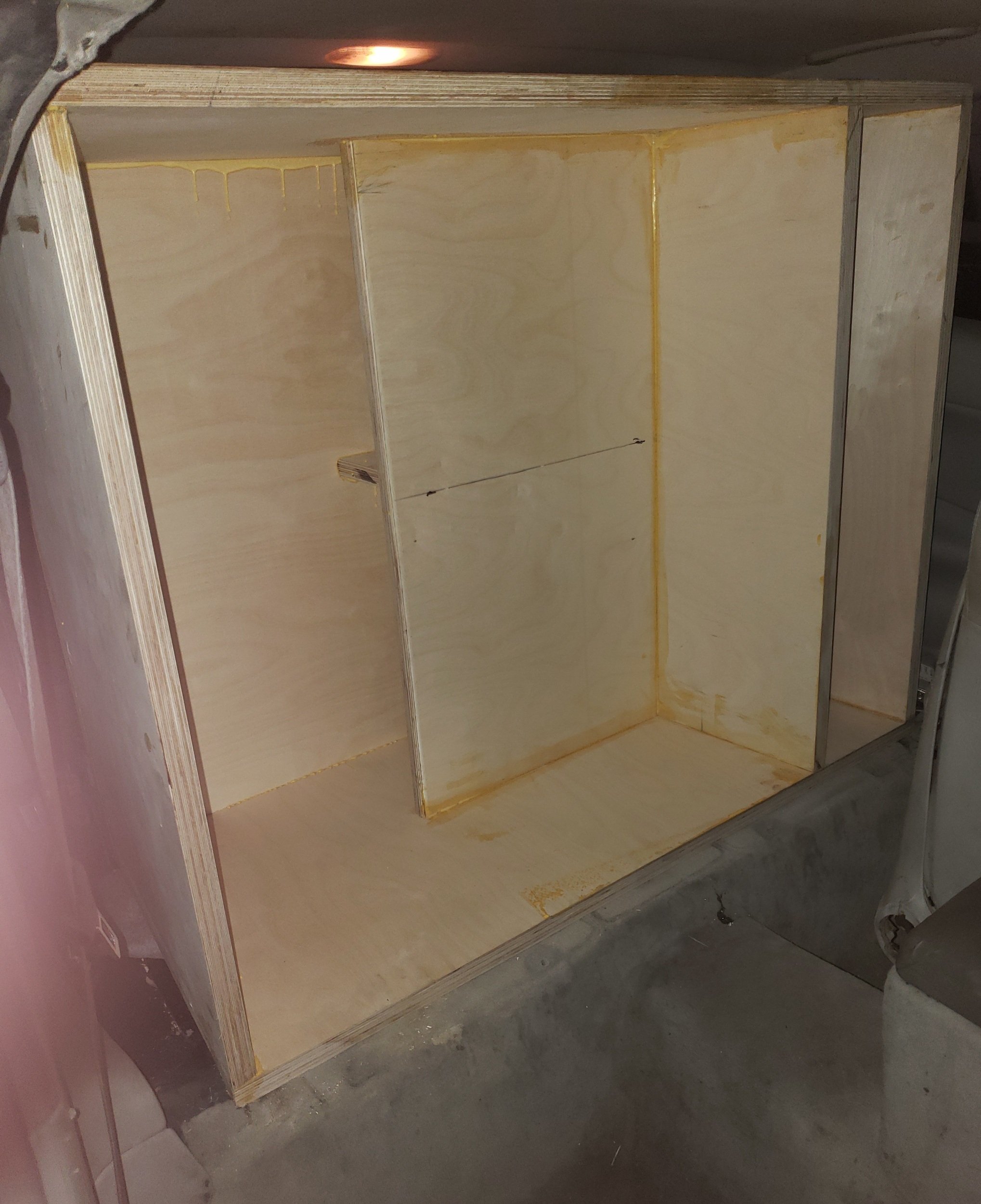

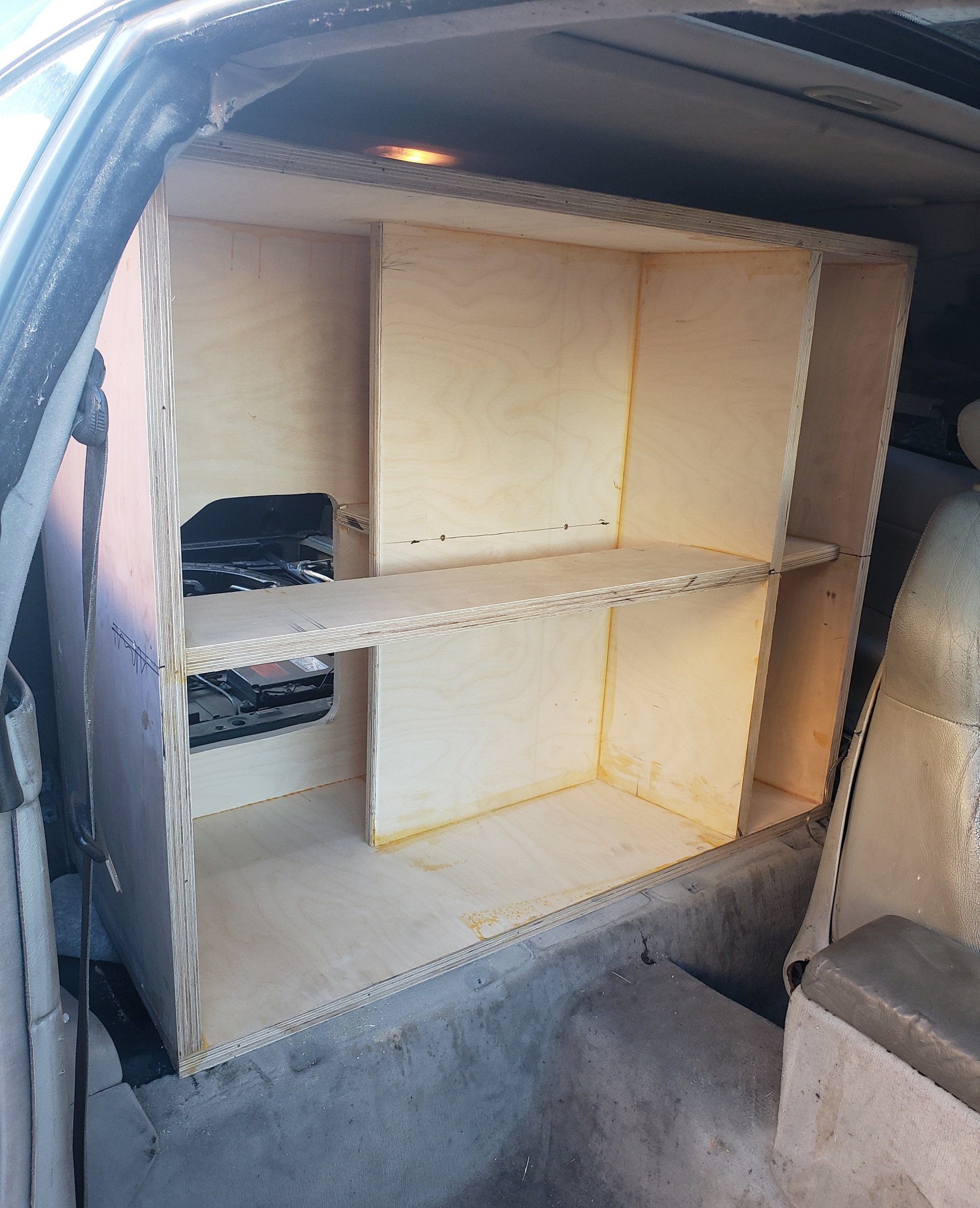

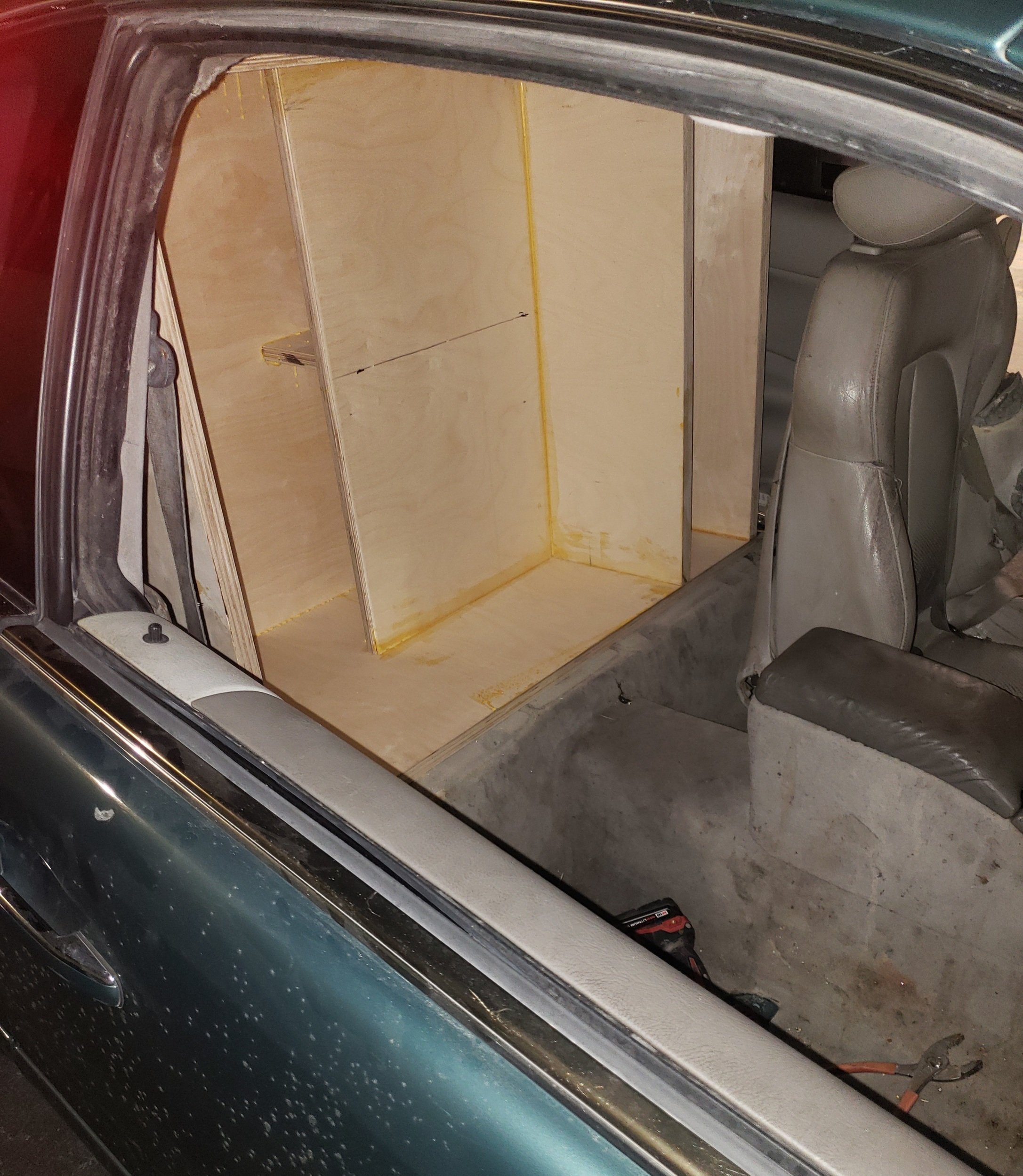

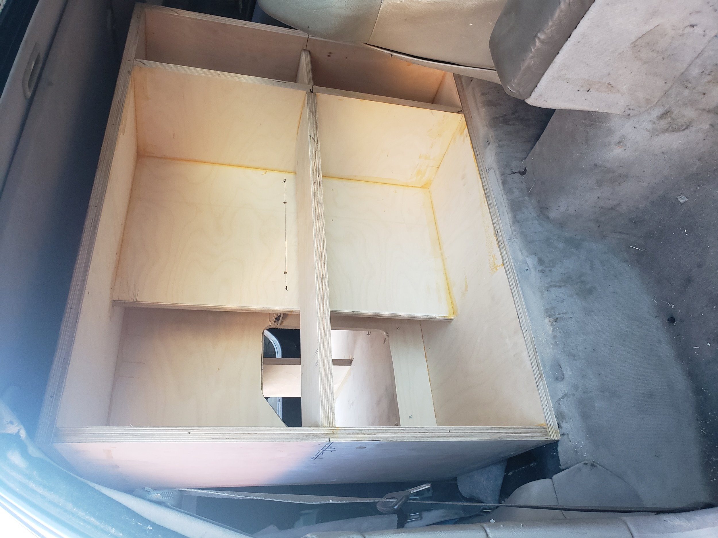

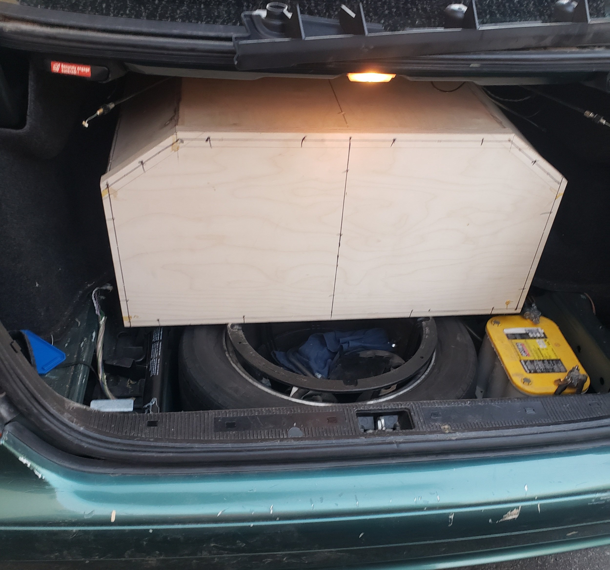

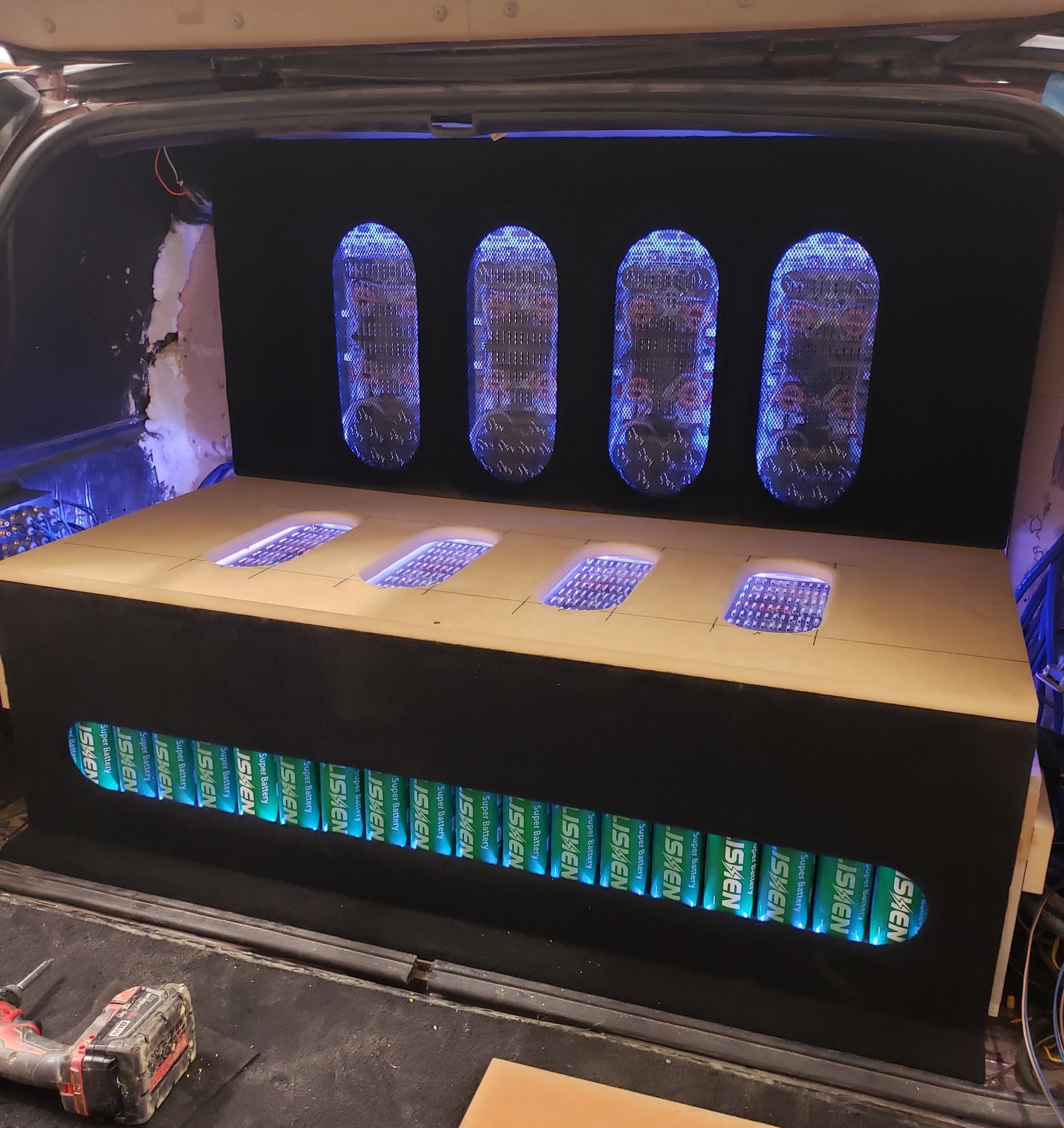

4-15" ported box build in a Mercedes CLK 2 door. 14.5 cubes net tuned to 35 hz. 202 sq. inches of port. The box is in the backseat and trunk. He's not sure what subs yet, but he's considering the AB HD15's. @Buck
