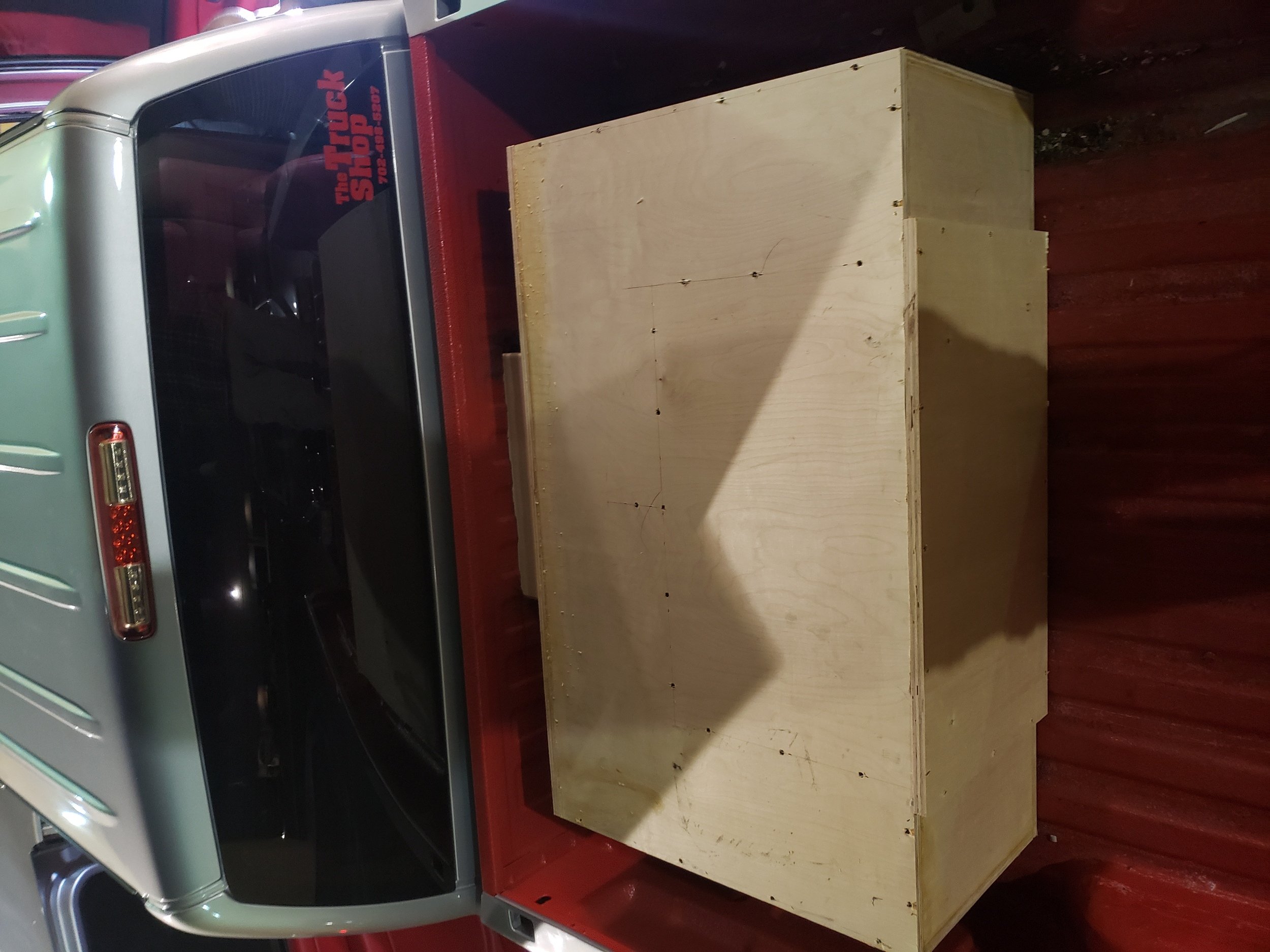

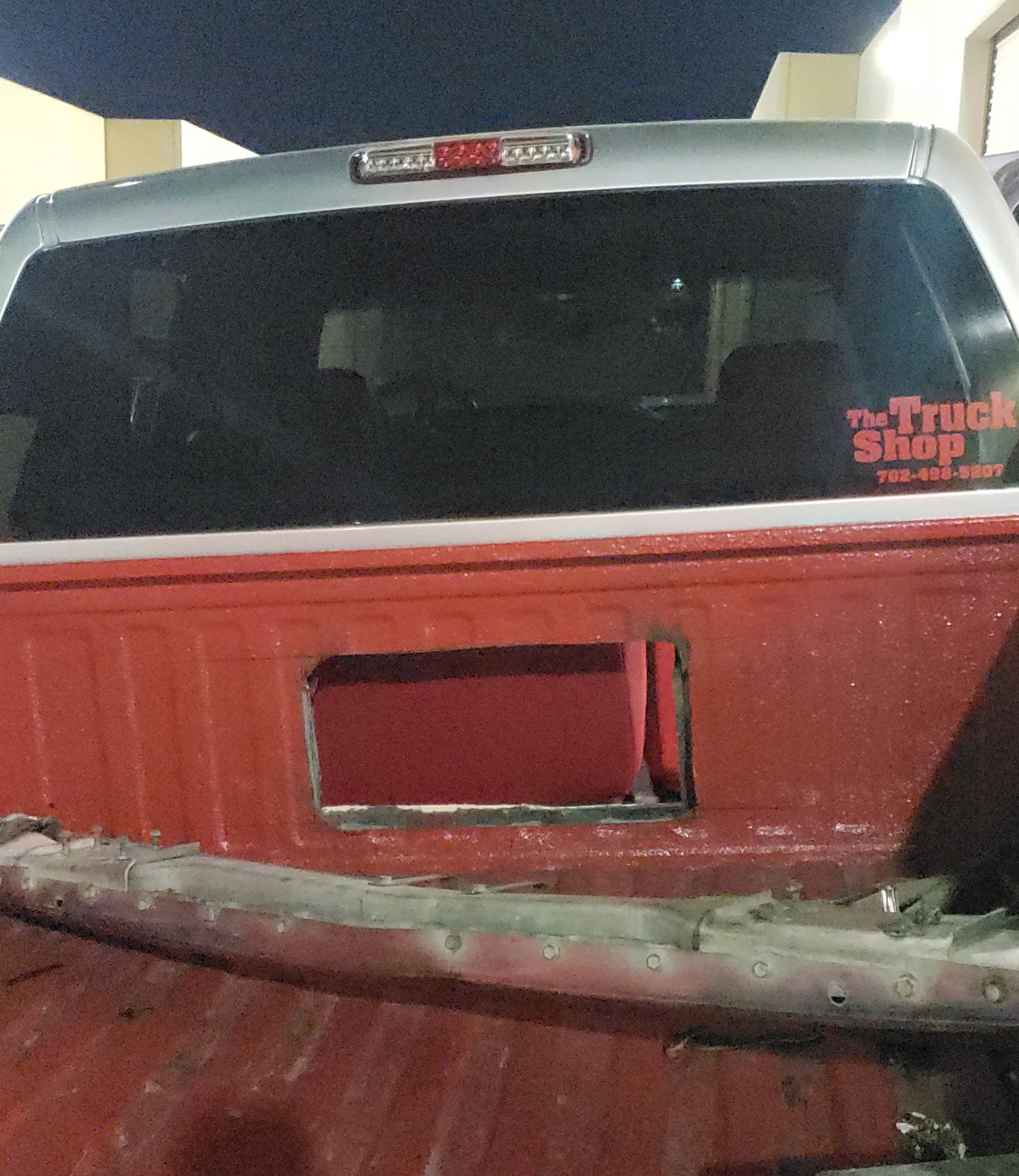

Wish I had the b@lls to do this to my truck☹😁
Me too, but I carry too much stuff. It would be hard to sell the truck also.

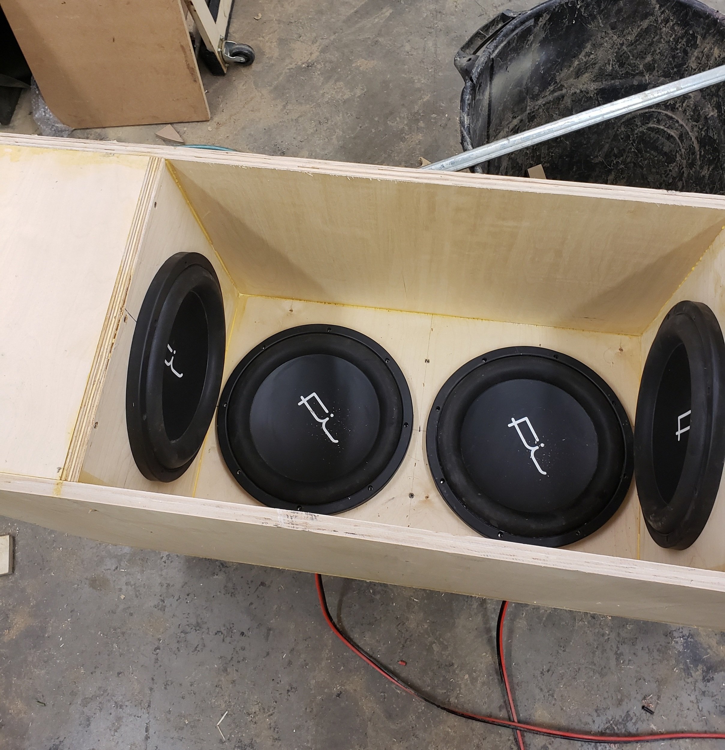

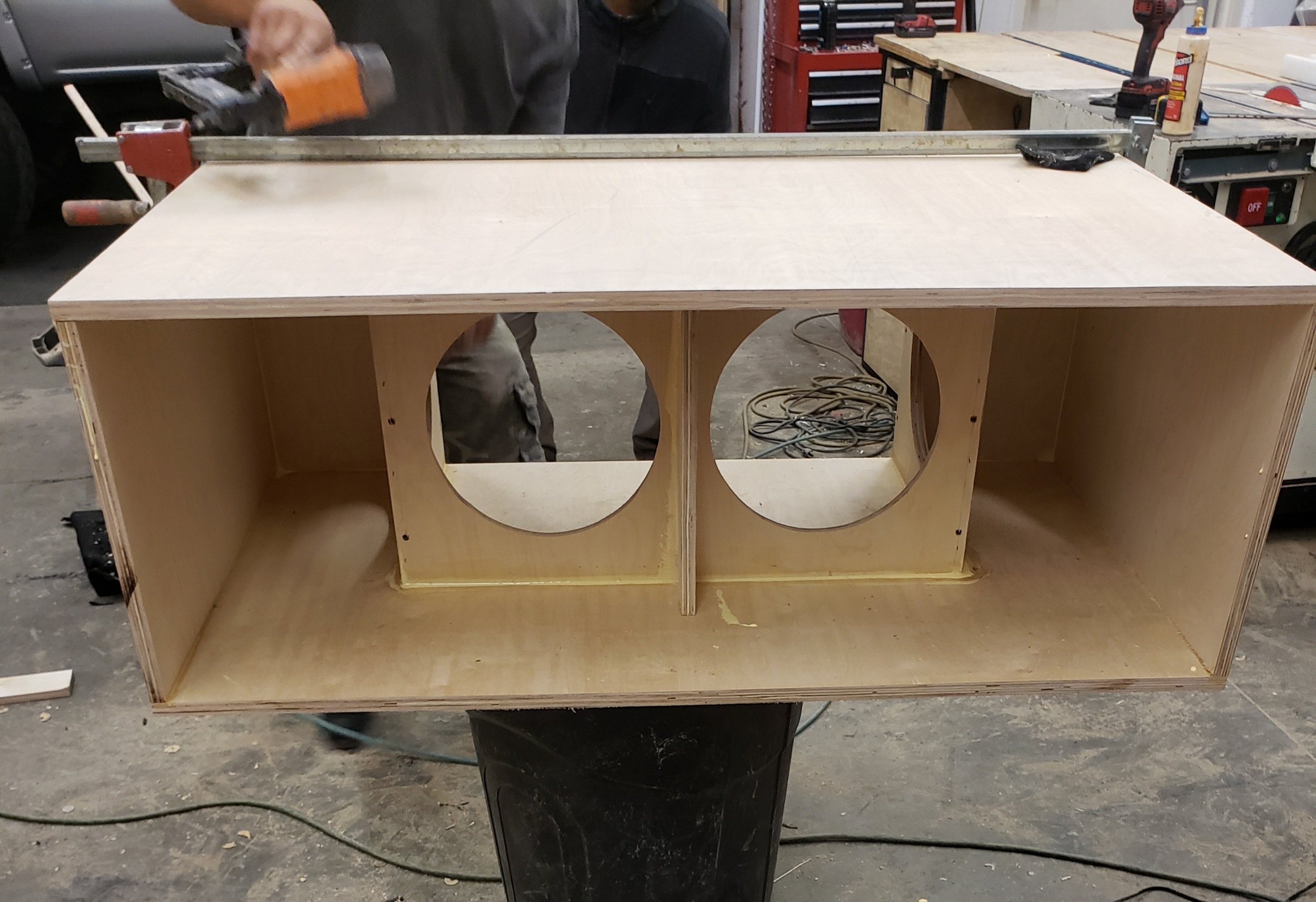

I'm currently working on 4 12's in a 6th order blow through in my Silverado. The box is designed to take up damn near the whole bed. Front to back, inside of the wheel well to the other. I got a camper shell thinking that I could still put stuff on top of the box if I needed to haul something. I won't be able to fit a big cabinet back there anymore, but at least it'll still be somewhat functional.
Though I've also contemplated getting a different box design that the front port would go through the back window. The box wouldn't be as long, because it would be a lot taller, and it would be easier to replace glass than a chunk of metal.
Just mentioning ideas you two might think about. But yeah, it's hard to cut that hole! I'm dreading it. Once you start, no turning back!

Maybe keep the pieces of metal so that they could always be welded back in. Just a thought. Then you could just Rhino line the bed after it was welded back in.
18s infinite baffle in the back panel of the truck.. Seal the box with bed liner and a sealed tonneau cover.
Two of these 3,000 watt rms beasts in a fourth order blow through on a 10K.

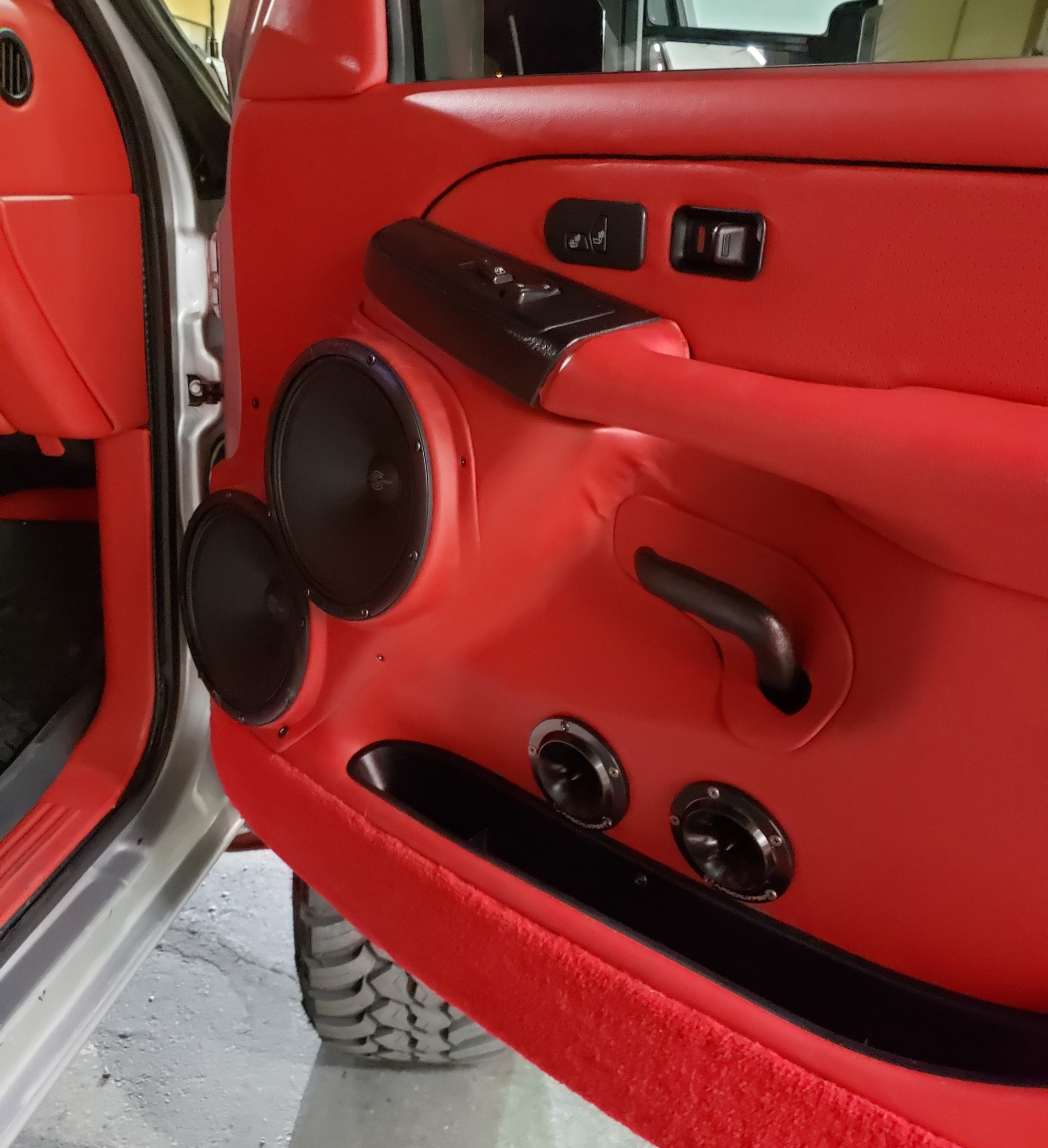

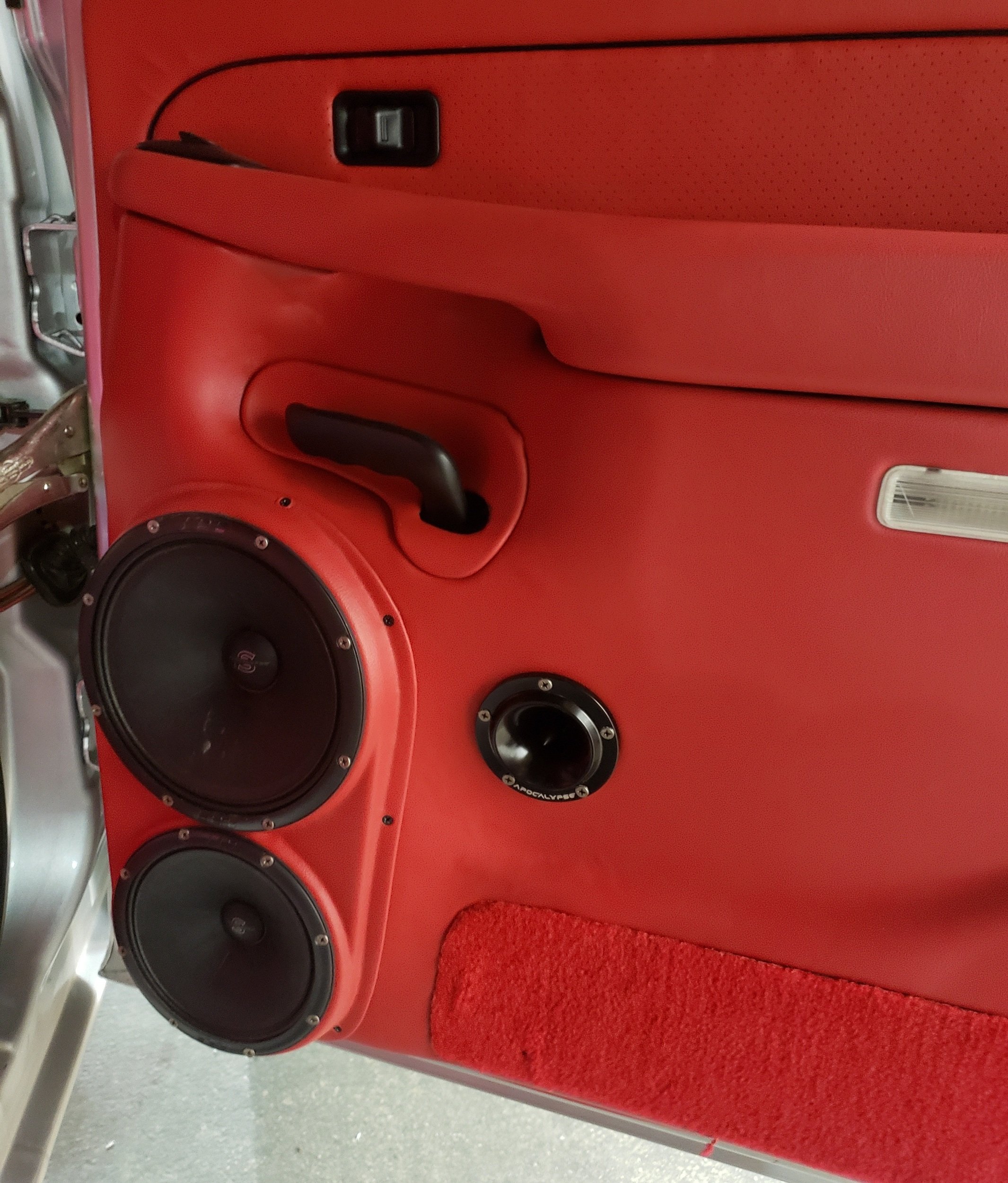

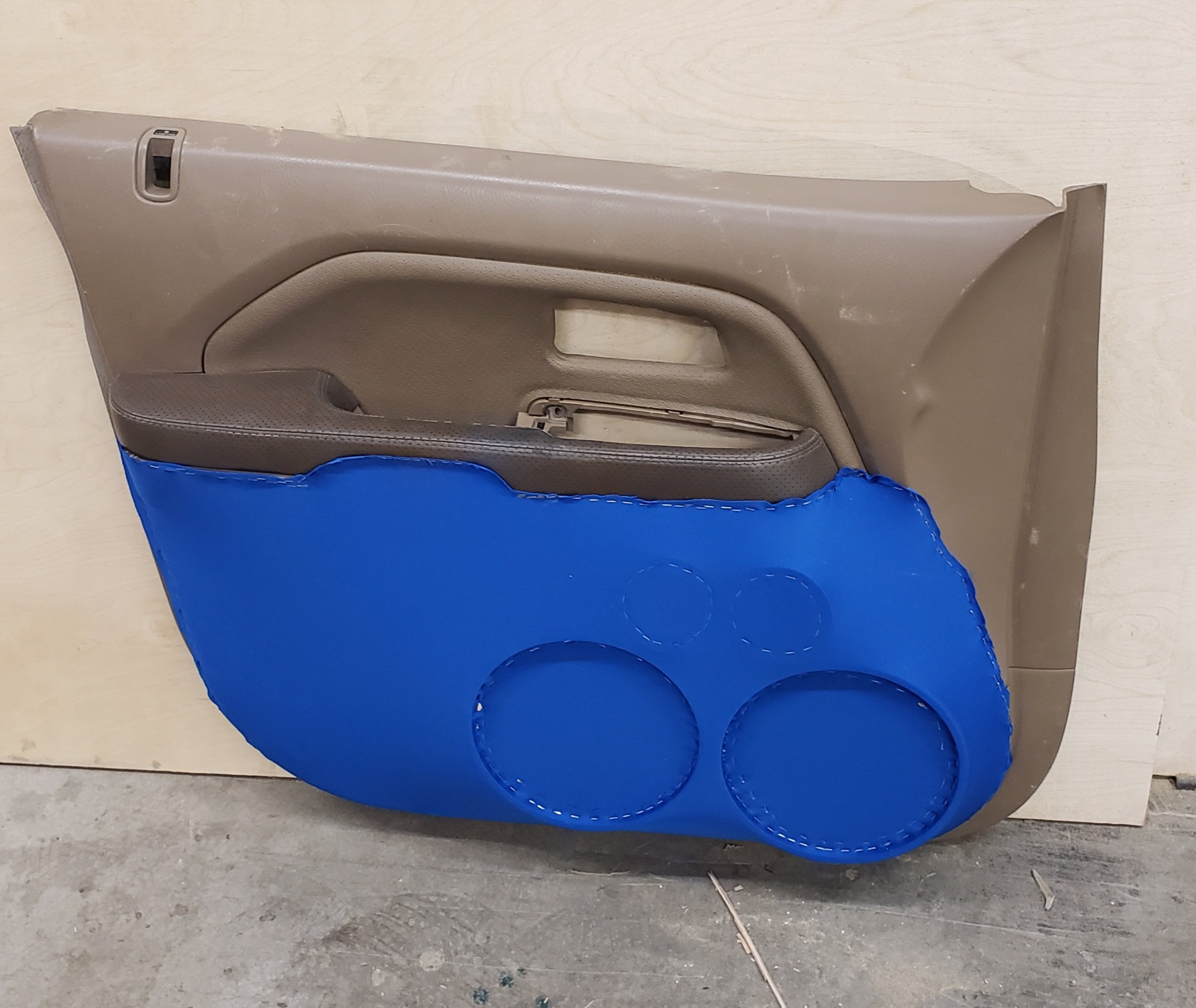

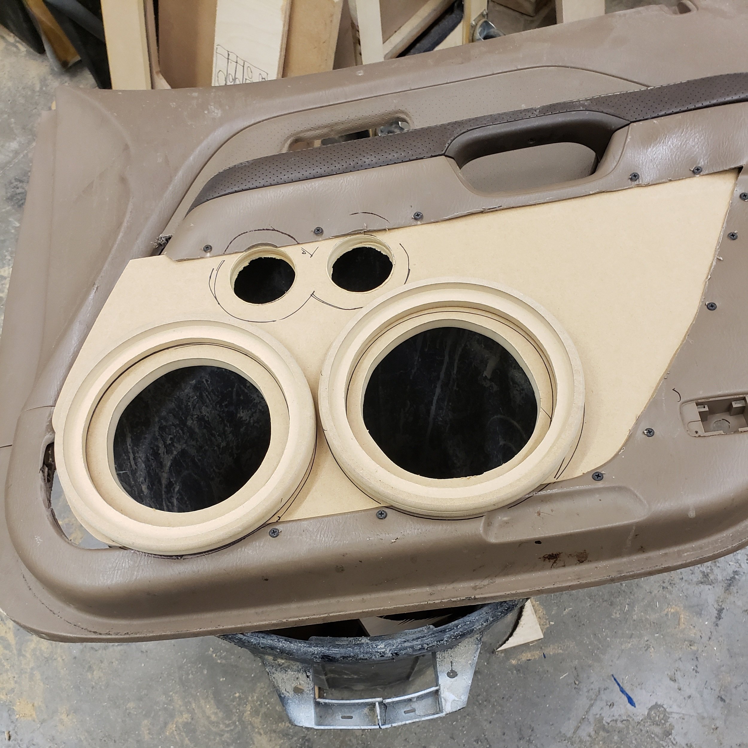

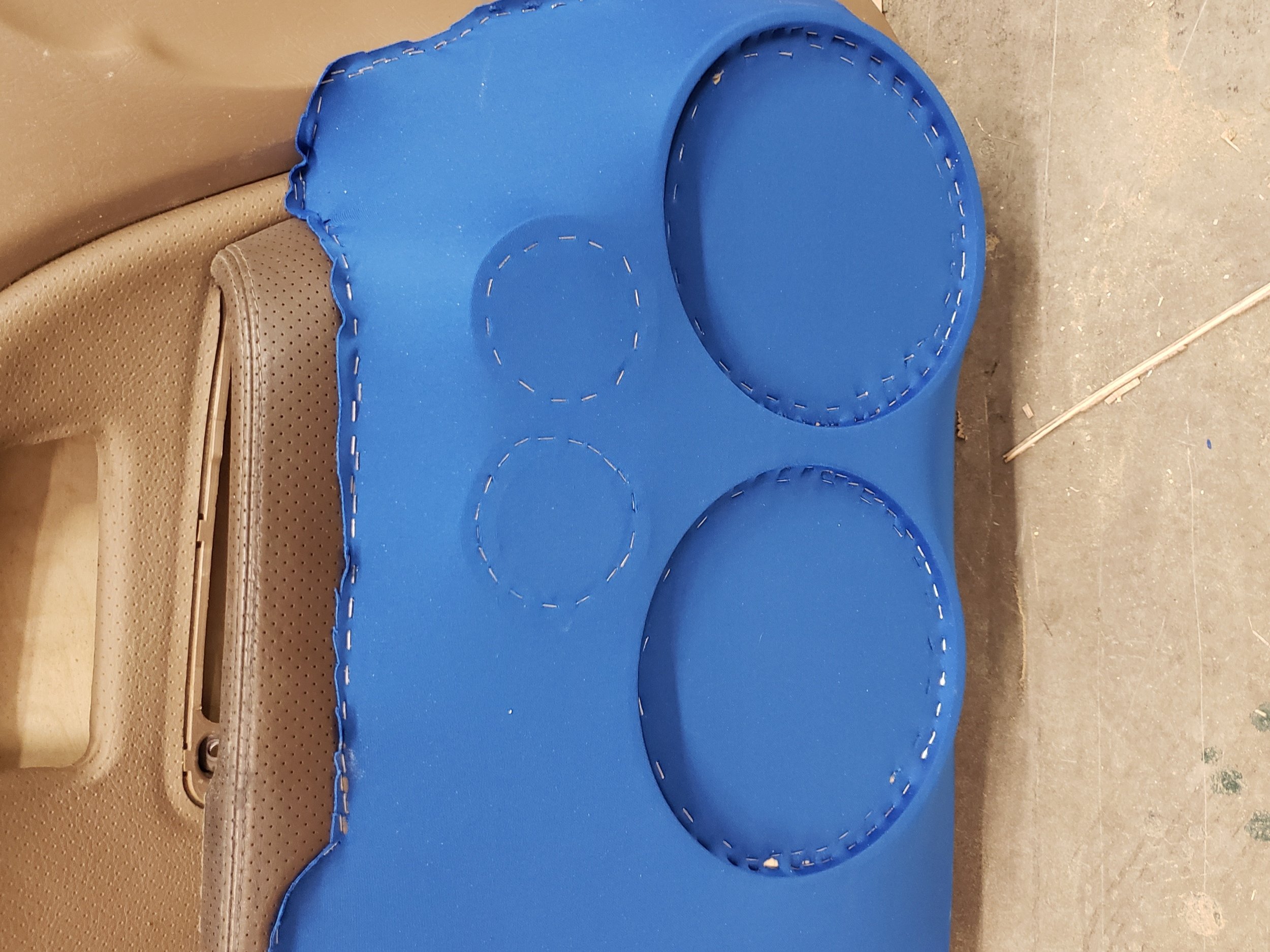

I'll post some stuff when I'm done. Or when I get close. I'm currently on try #3 on my doors. First 2 tries where complete failures. Once I'm finally done with the doors, everything else should get done a lot faster. I've never done door pods before, so it's a lot of "nope, that's not going to work" lol

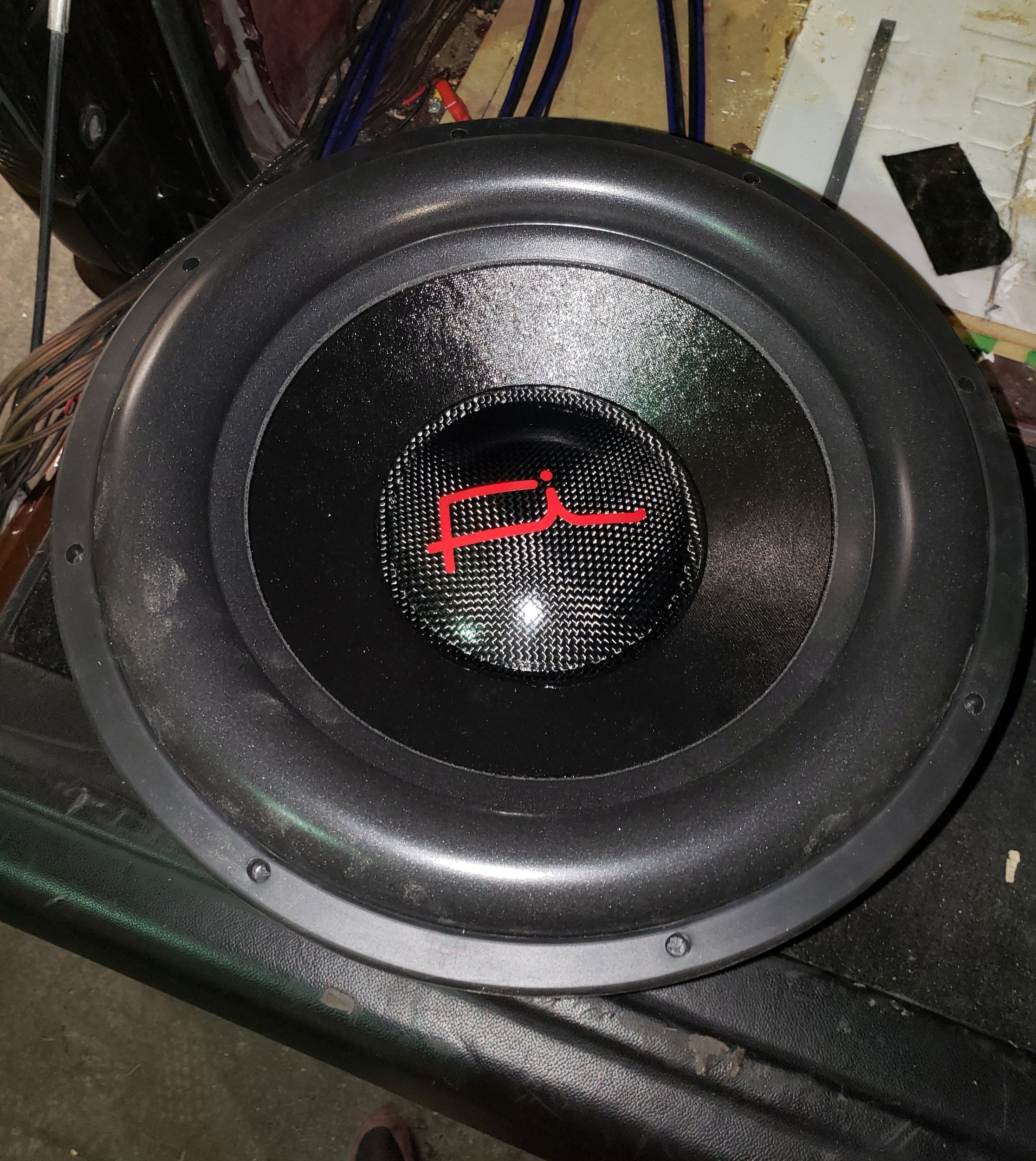

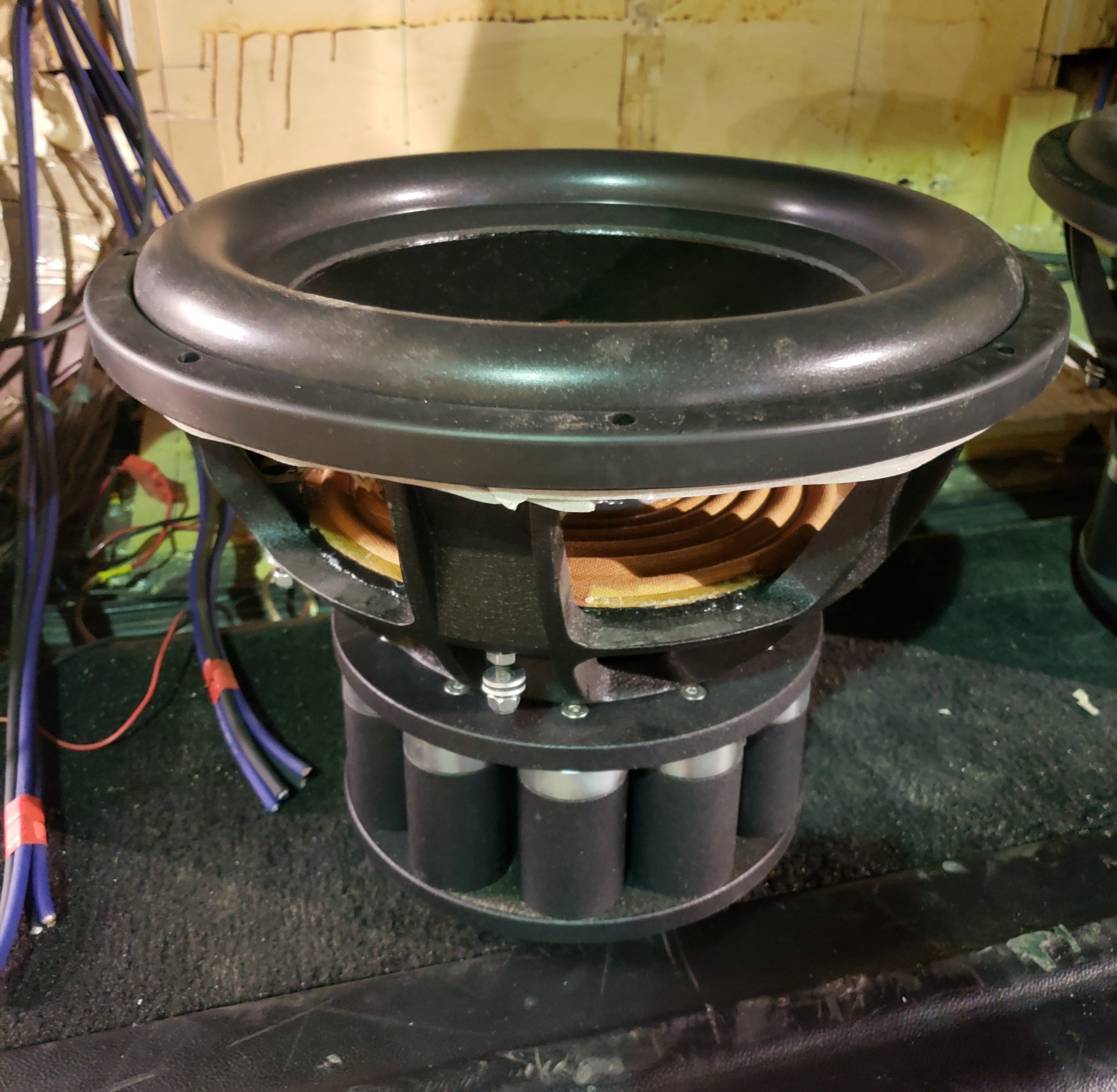

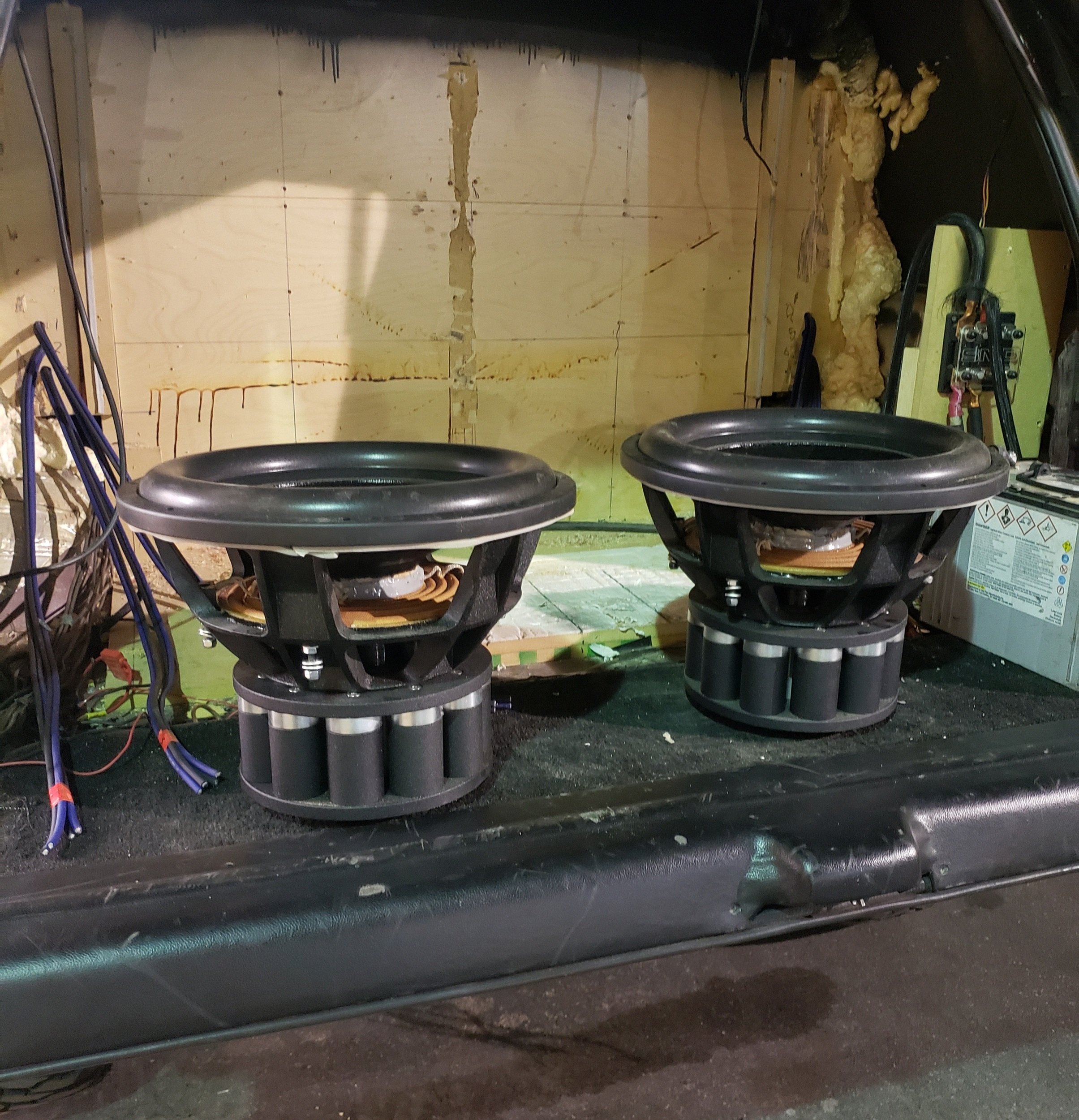

Installed the 6-Fi 15" custom built NEO's in a sixth order in a two door Tahoe. Then we tested them on my SIA3500. They still got pretty windy on a 3,500 watt amp. The next step is installing the 4 Wolfram Arctic Wolf 9K's @ ½ ohm.
