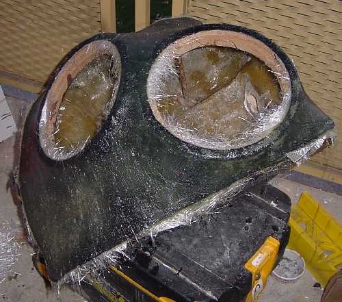

Just fiberglass it. I assume you are talking about something like this
And maybe even adding a few rings on top of that to push the sub farther out. If this is the case then just screw a few more rings to the rings already in place AFTER you fiberglass the fleece then just do a few layers of fiberglass around it, followed by some bondo to smoothe it out.
