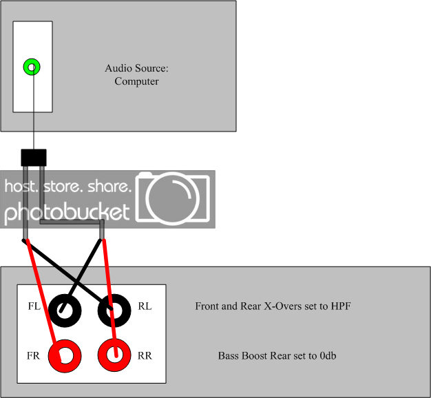

I have everything wired up and plugged in but I am only getting sound through the front bridge channel. I can not get any sound out rear channel...
I tested:
The Audio Source
The cabling
Re-Crimpped
Checked the fuses in the amp
Checked the halogen bulbs in the x-overs...
I have testing all my connections with a meter and everything appears good.
The only thing is on the rear channel config there is another switch for "bass boost" and its currently set to 0db (the default). I doubt that has anything to do with it...
Any ideas?

Goes from computer's front channel to a stereo connector splitter then to 4 RCA connectors then into the amp.
I have tested both RCA pairs with a separate set of speakers.

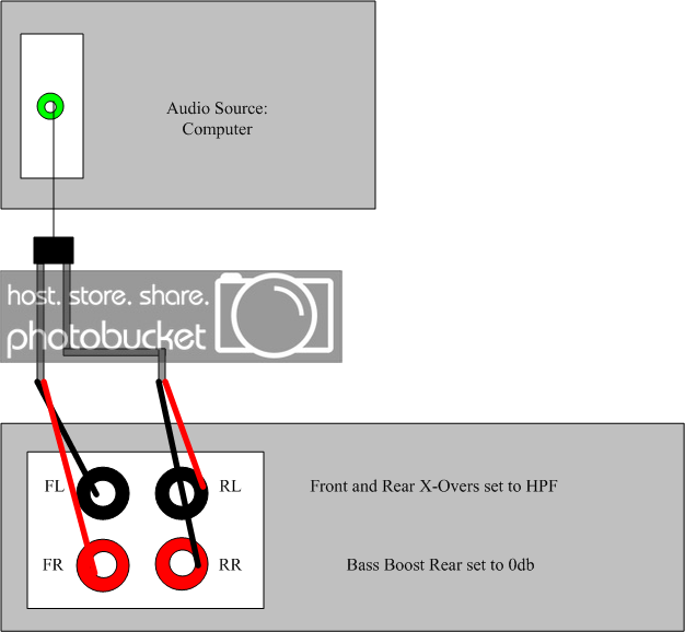

Not that I think that it has anything to do with the problem, but the left channel when split should go the the pair of inputs on the front and the right to the rear. Left and right as labeled on the amp no longer have any bearing on your system and neither do front and rear. Front is now left, rear is now right.
Haha yeah I felt kind of silly when I looked at that. I tried that last night and had the same results... Currently I have rewired the RCAs to be exactly that way.

I feel a little silly right now now though. RIGHT after I messaged the one I got these from, I changed the RCAs around and it all of a sudden works...
The only thing I need to do is figure out how to set the gain (there are no onboard gain controls, only a remote). The remote only controls the rear channel for some reason.
