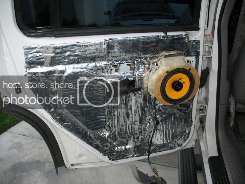

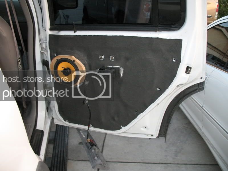

I did 2 layers of BXT on both inner an outer. If you have that much why not use it? For the hell of it ill post some of my BXT deadening.

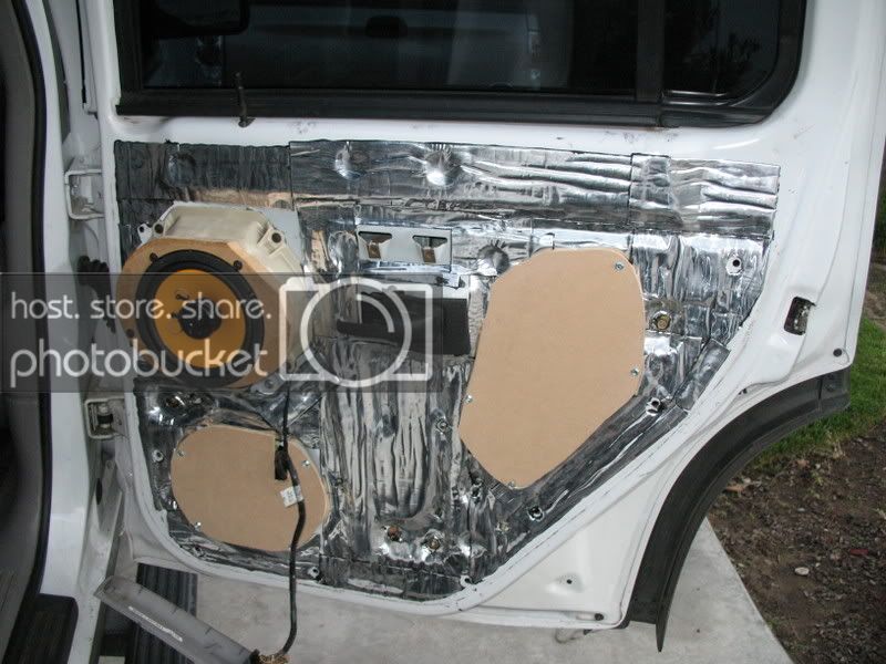

to cover the holes does it have to be wood, or just plain deadener
You can do both. I used 1/4" mdf with some self tappers and it worked perfect. I jus wanted it to be as dead as it can be an using the wood seemed like the way to go.
