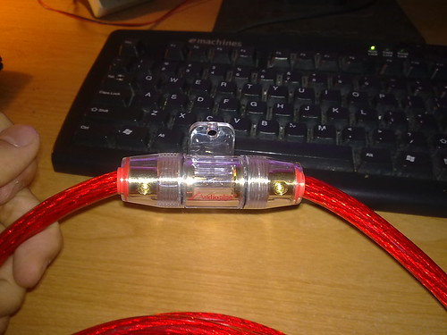

i got an audiopipe 4g installation kit. the first step is regarding the aue fuse
sorry too lazy to type that out lol, but take a look at the red (power) wire
it seems that the aue fuse is already connected to the cable, so i can skip the 1st step?

Is the fuse holder in the middle of the wire, or is it just holding both ends of the wire together? The remote wire will connect to the blue wire labeled "remote" on the harness of your radio.
