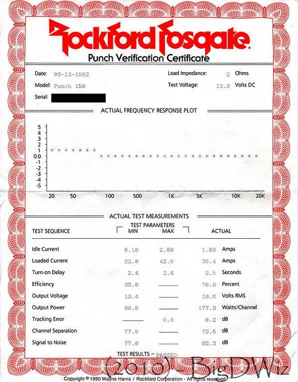

Not to mention, if you can find one in NIB Mint condition for for less than 2 bills, u will be putting money in the bank the way Ole skool stuff has been disappearing.
Just for shits and giggles:

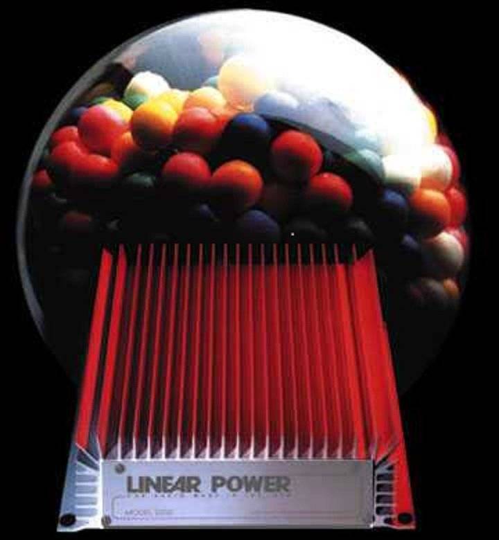

...and if you find one of these at a garage sale, let me know!
