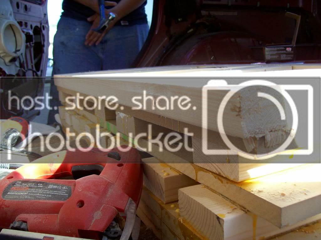

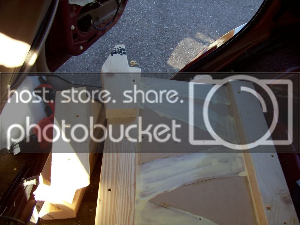

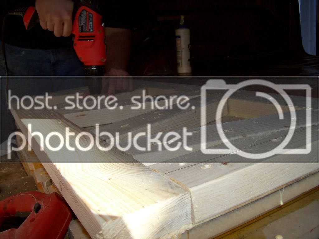

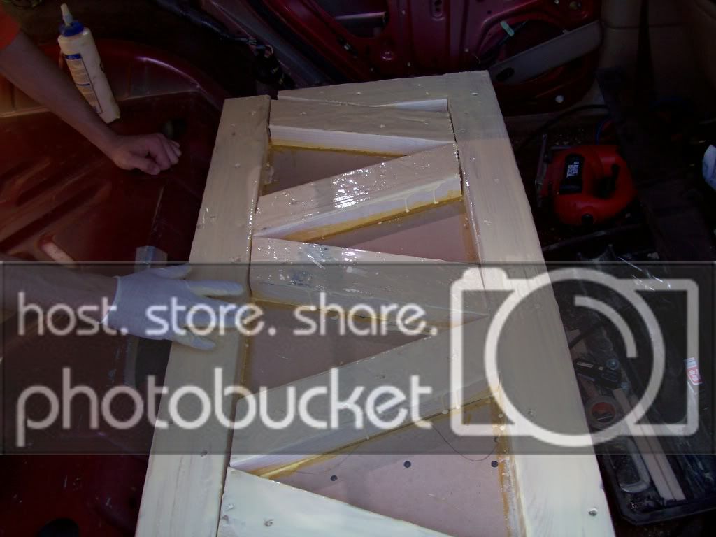

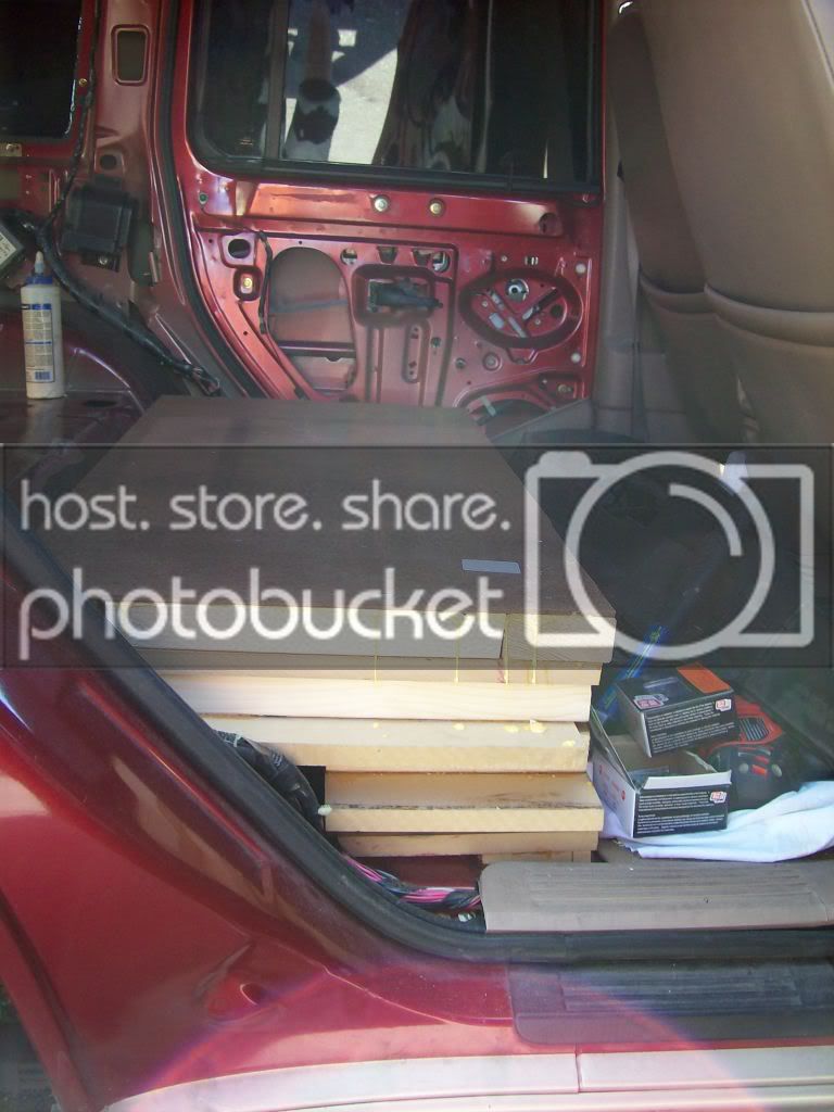

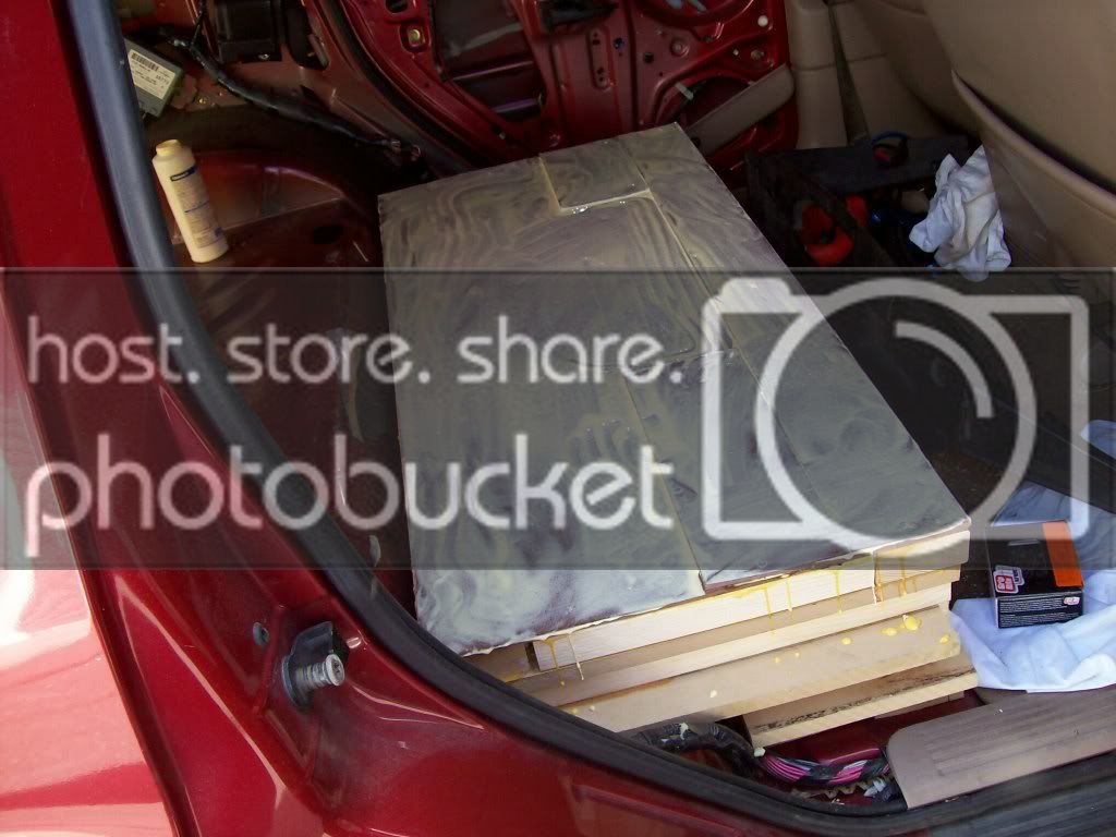

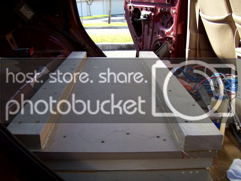

and here is the piece that will line up with the bottom, and kind of set the tome for the rest of the buildup.

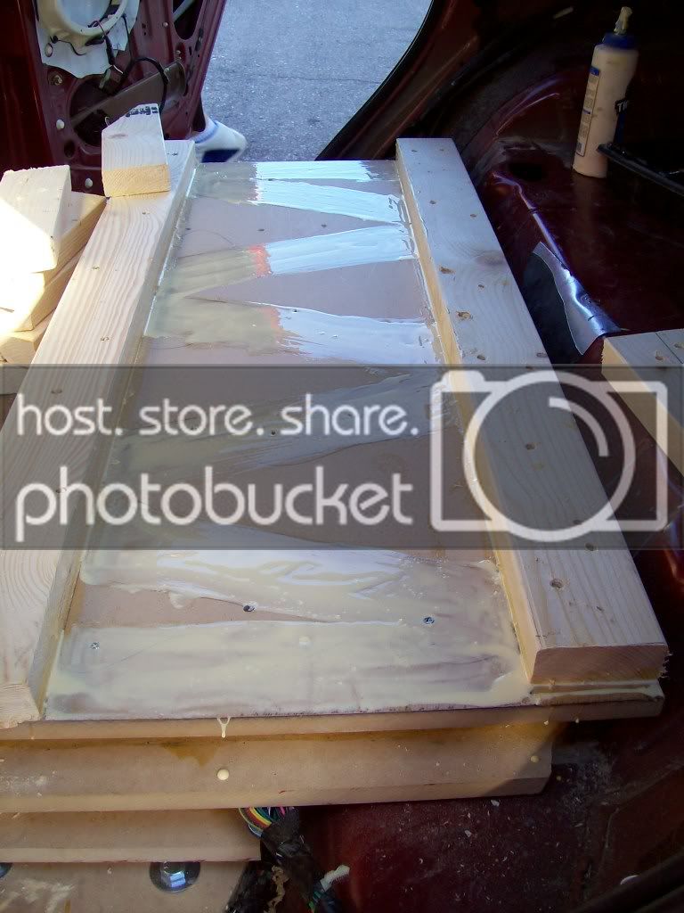

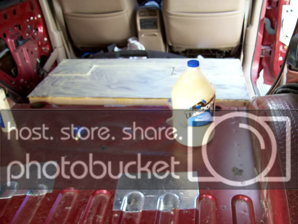

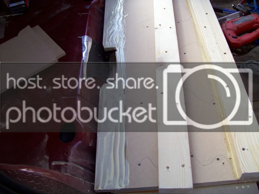

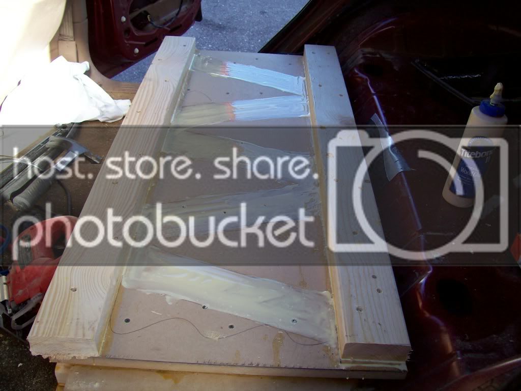

a sheer amount og the glue that i like to use.
I always run my hand on fresh laid glue when building boxes for full surface area contact....this should be no different, so i use what some peeps would call overkill

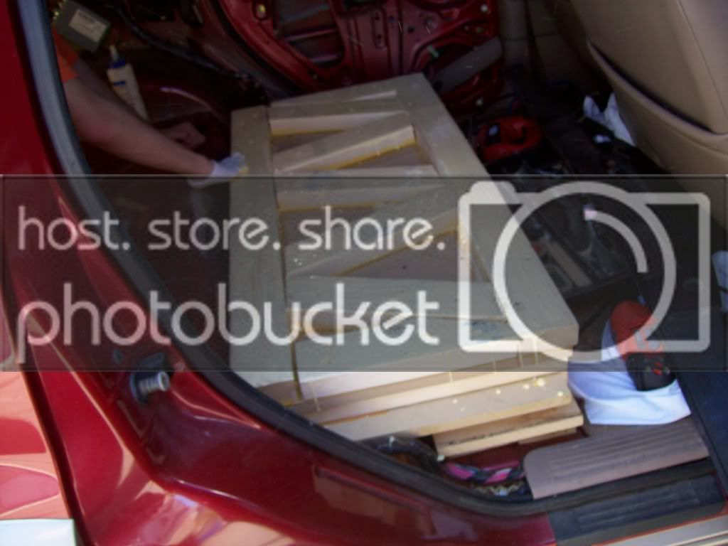

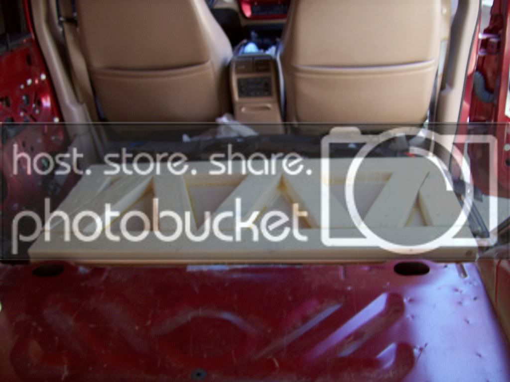

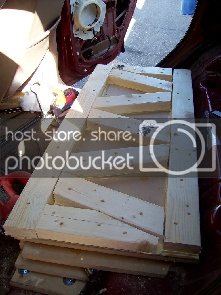

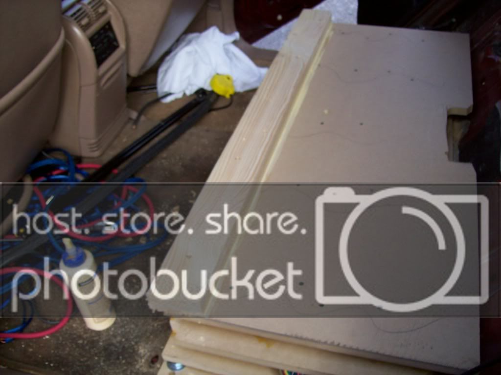

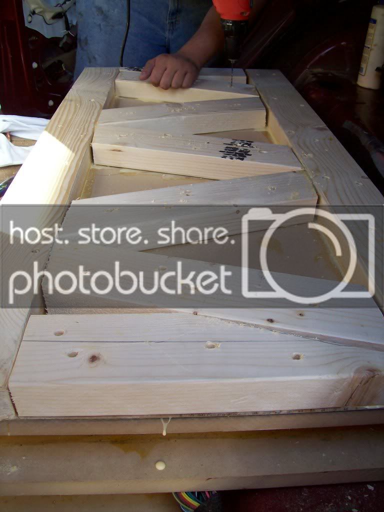

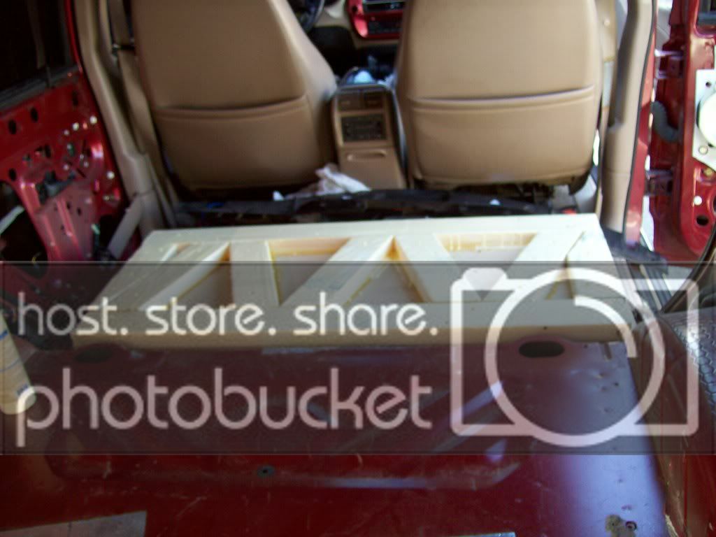

Looking good so far...what are yall going to use for bracing? All Thread? 2x4's
Good job so far guys,
resin, prally 2x4s...im not doing allthread. spent enough money as it is. and robin made me buy a hotdog today for him:mad:

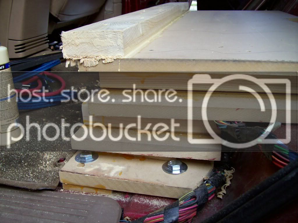

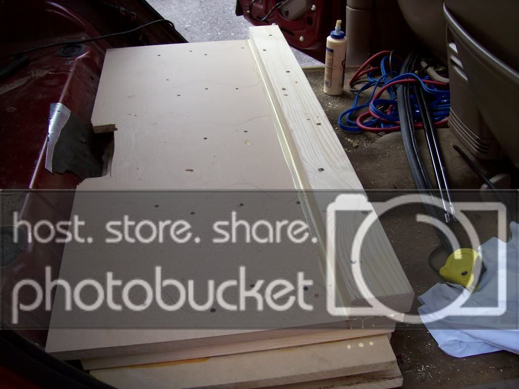

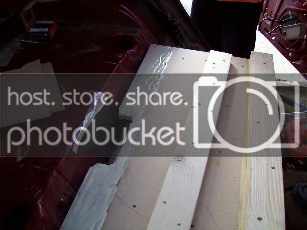

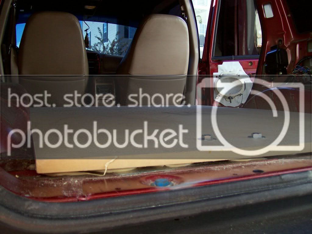

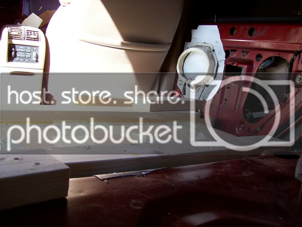

but that floor, with the 2x4 layers in between the mdf, is so solid you wouldnt believe it, you have to see it in person and hit it with a hammer or something....
we had to lay down a 1/4 inch piece of hardboard because it looked as if nothing else would make it completely level. im loving it so far, bu wanting to get more into the actual build, ad opposed to the buildup.

this is all we have for now....

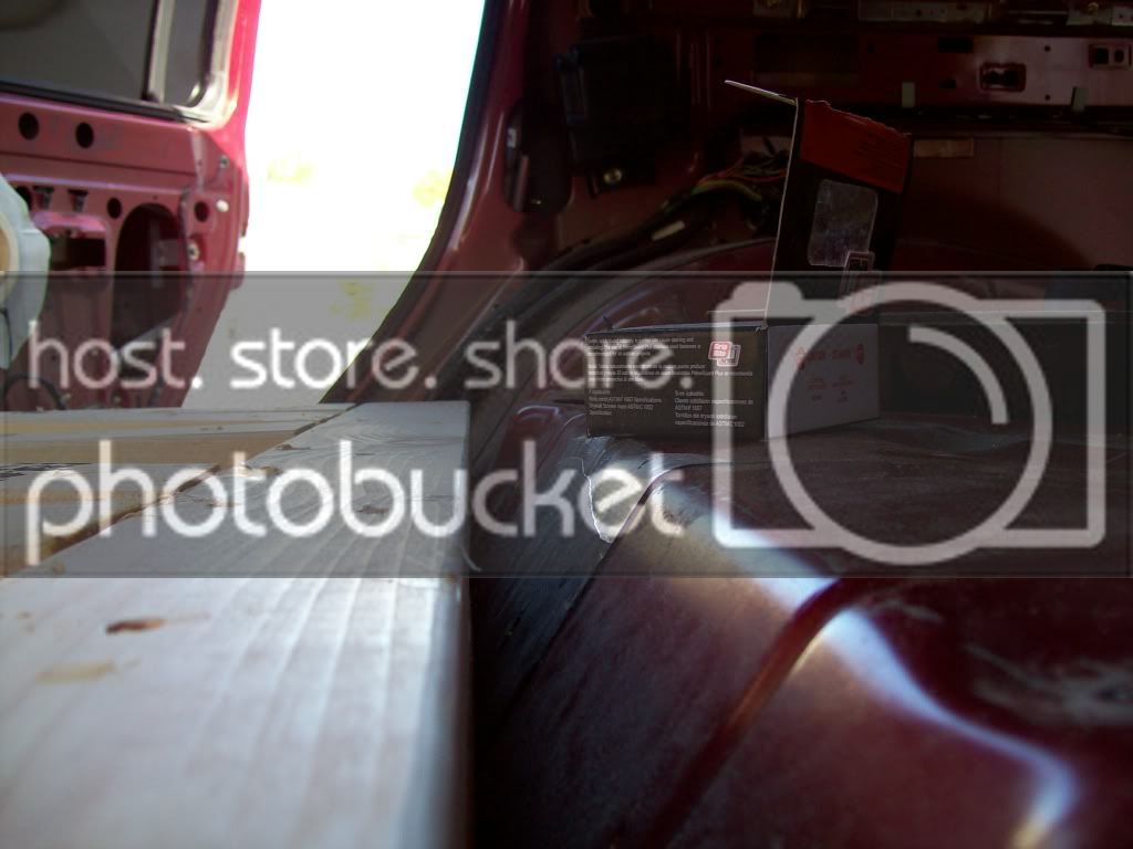

Yep, It would be very easy to run them in the frame rails and up through one of the rubber body plugs, drivers side wouldnt be good because of fuel/brake lines and the gas tank is in the way. passengers side is clear all the way.
