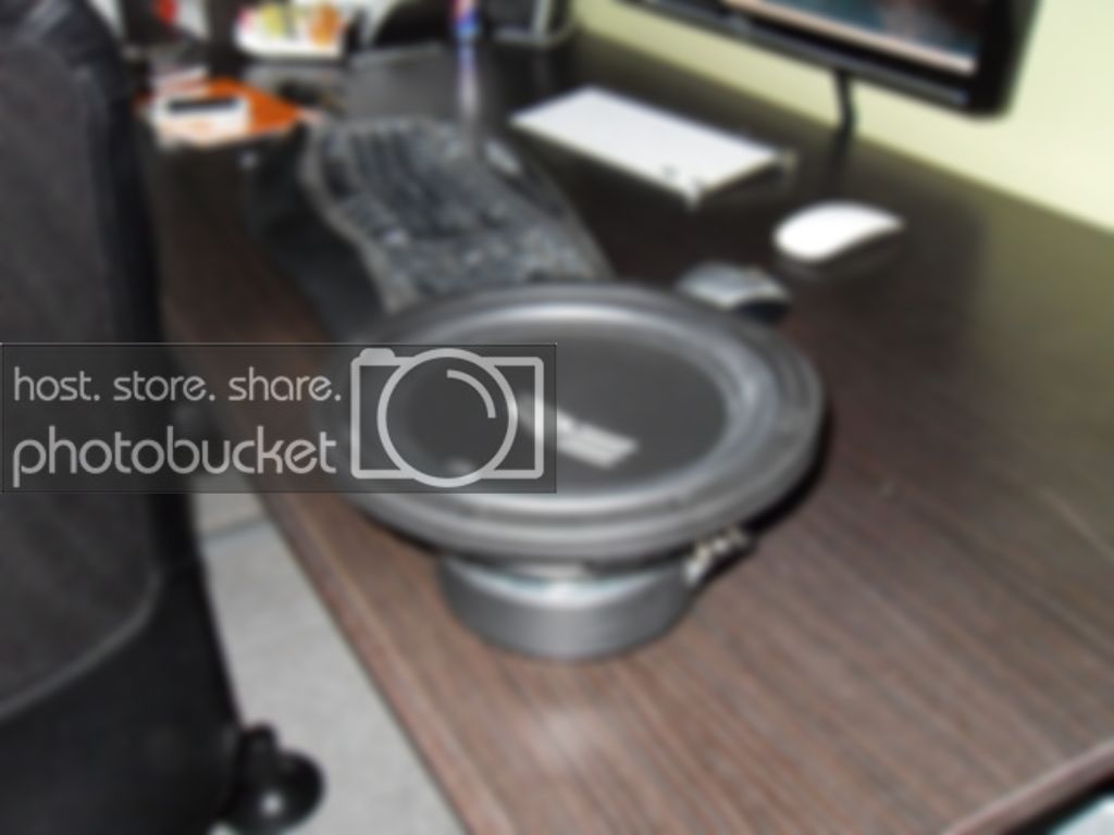

I had the urge to play around with some 8's so i picked up a pile of REX8's on ebay for much cheaper than i thought i could find them for.
I was actually expecting much less than what they truly are. Rather beefy drivers actually, very comparable to E8's at first glance (i've been doing some testing with E8's in my girlfriends car). Im curious to see how they will perform in comparison. After i get six in my rig, i'll try to do a direct swap with the e8's in my girlfriends escape and see how they do.

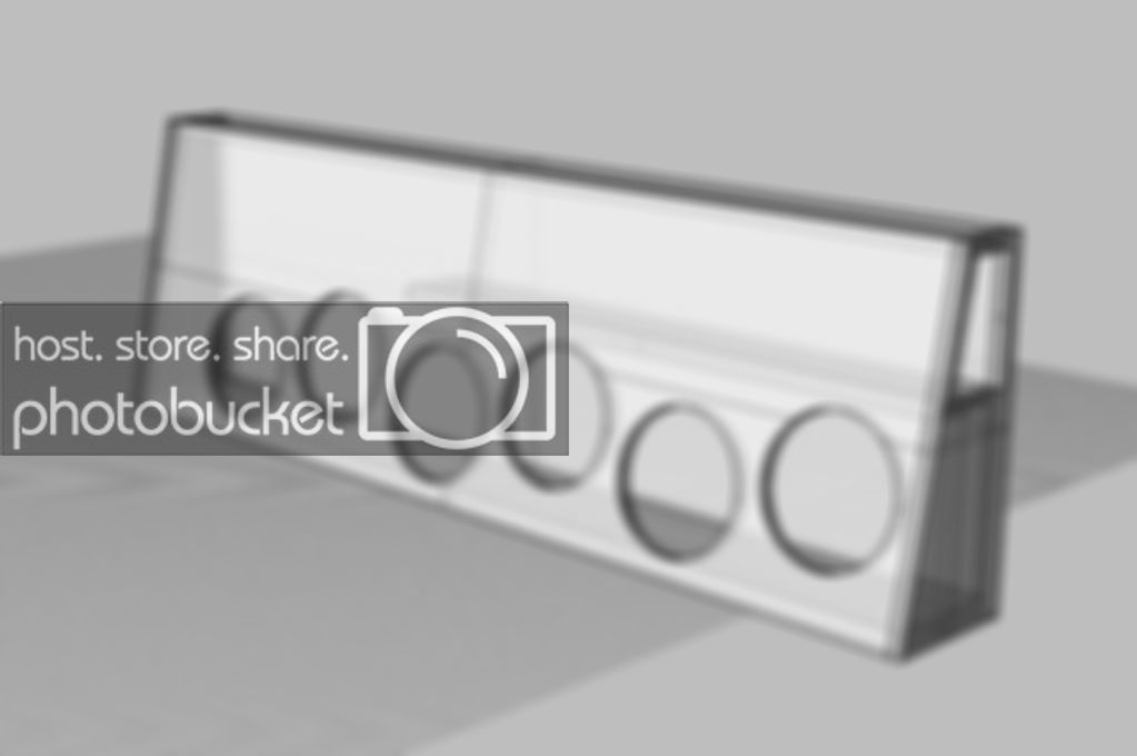

Im going to start off with six in a ported box, and will eventually compare to 8 in a sealed box.
Here is the initial plan. 2cu ft @ 29hz, which modeled up surprisingly well. RE has minimal reccomendations of .3cu ft each.

You sure its going to work with some of the subs so far away and basically sealed off from the port opening?

Too be honest, I'm not really sure how the response is going to be.Like i said, a series of boxes will probably be built. I've never tried to put this many subs behind the seat of a pickup before, so its more or less an experiment.
