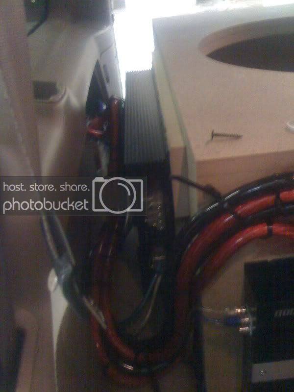

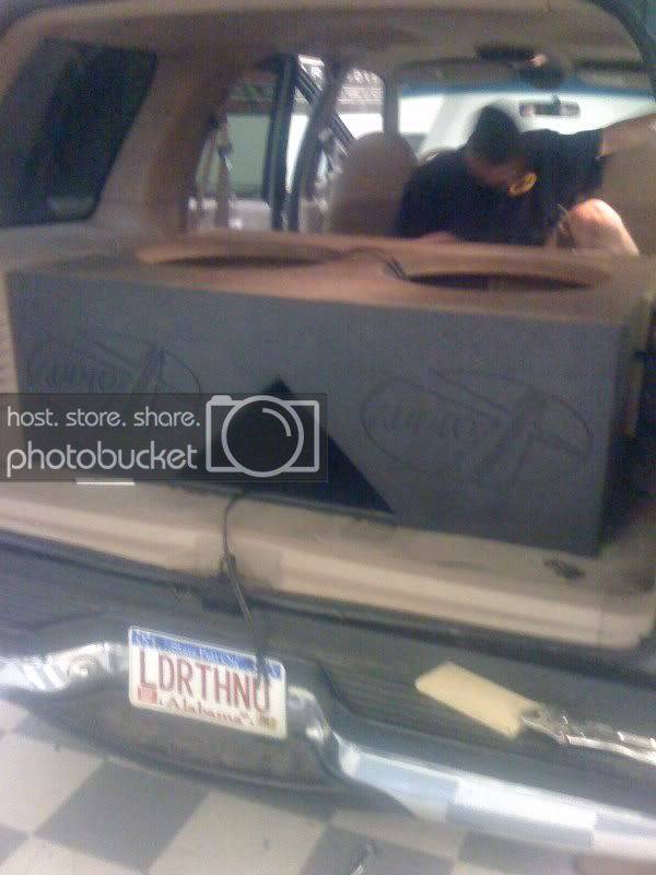

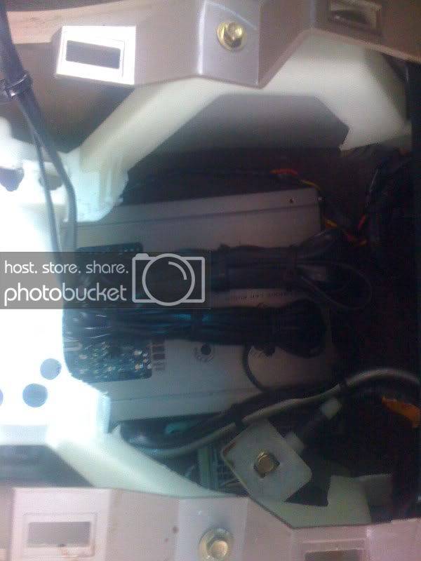

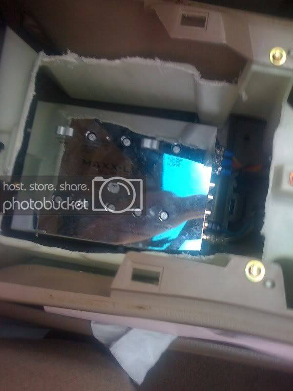

Its hard to keep everything clean and out of the way when using a lot of componets for an install.
I had a maxxlink and a memphis epicenter laying here so I figured I'd use them but we couldn't figure out a place to put them....after a couple of hours of planning and some cutting we found a place to stash them.
Sorry for no pics of the enclosure build process...but those are usually just a waste of time anyway lol

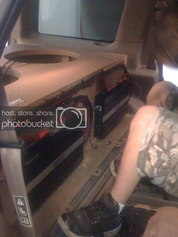

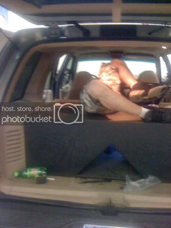

Got the amps in, wired, and prettied up...
before someone says it...I didn't want to do a ton of power per woofer (yet). The subs are rated 1500w rms so thats what I put on them. Was trying to show just what RMS on a woofer in a daily driver setup could achieve.
I wasn't gonna compete at all this season, but there are a hundred meca shows around me so I'm gonna go to meca finals. Probobly switch out to 8 12s and 8 1500s for finals though

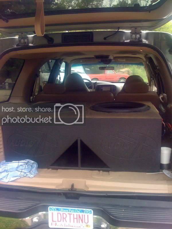

Neat looking box. What's the tuning?
Its not as big as the woofers need by a stretch. Its just like 12 cubes after displacements //content.invisioncic.com/y282845/emoticons/frown.gif.a3531fa0534503350665a1e957861287.gif
But its tuned around 35 hz on paper so a little lower after you put it in a vehicle

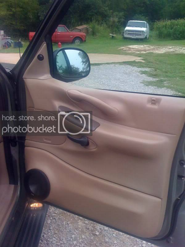

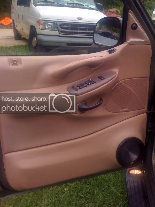

Got the doors finished up!
You can't tell from the pics, but I have an eclipse 3 way set up front, midbass in the doors, midrange in the factory 5x7 location, and tweeter on the sail panel bridged on the sax 100.4
it JAMS and sounds FANTASTIC
Tweeter protection kicks in on the eclipses though which is one thing I forgot about. Next step is take the doors apart and get the crossover out and bypass that.
the doors are the same color but look crazy because of the light
enclosure was flexing a little so I had to take care of that...inside the enclosure now has 10 braces top to bottom and L braces off of those into the sides...its super strong now //content.invisioncic.com/y282845/emoticons/smile.gif.1ebc41e1811405b213edfc4622c41e27.gif
new box is gonna be built in a couple of weeks though, try to get another couple of cubes out of it
I am trying to get 12 net cubes into my MDX right now.... It's not easy //content.invisioncic.com/y282845/emoticons/crap.gif.7f4dd41e3e9b23fbd170a1ee6f65cecc.gif How much port area did you give them?
