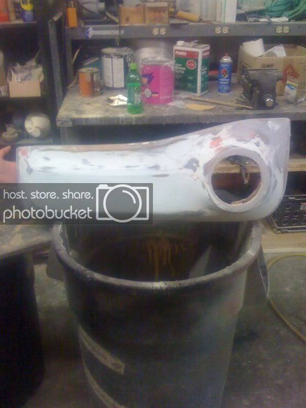

took the factory door panel wrapped it and glassed, couple of layers of kitty hair and bondo on it and sanded fairly smooth.
Then we had to attach pieces of wood to the back of the panel in order to screw it to the top part of the door panel from the back, this way it not only strengthens the panel and the door but if you use enough screws it won't rattle or take a chance of falling off the door lol

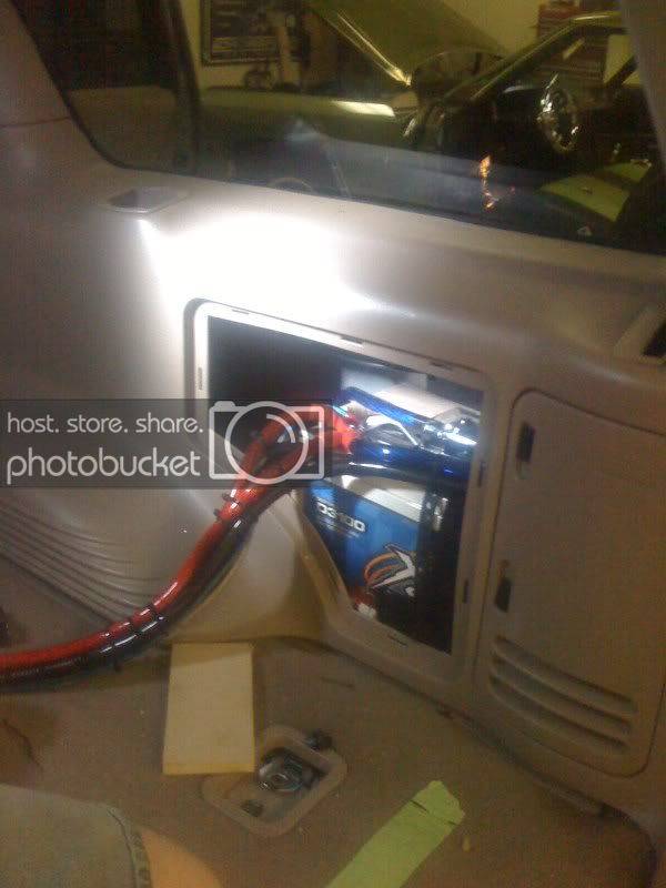

Didn't get any pics of the process of molding out the a pillars...wasn't much to it though.

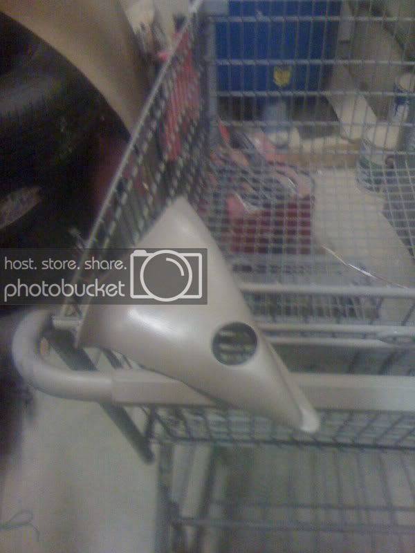

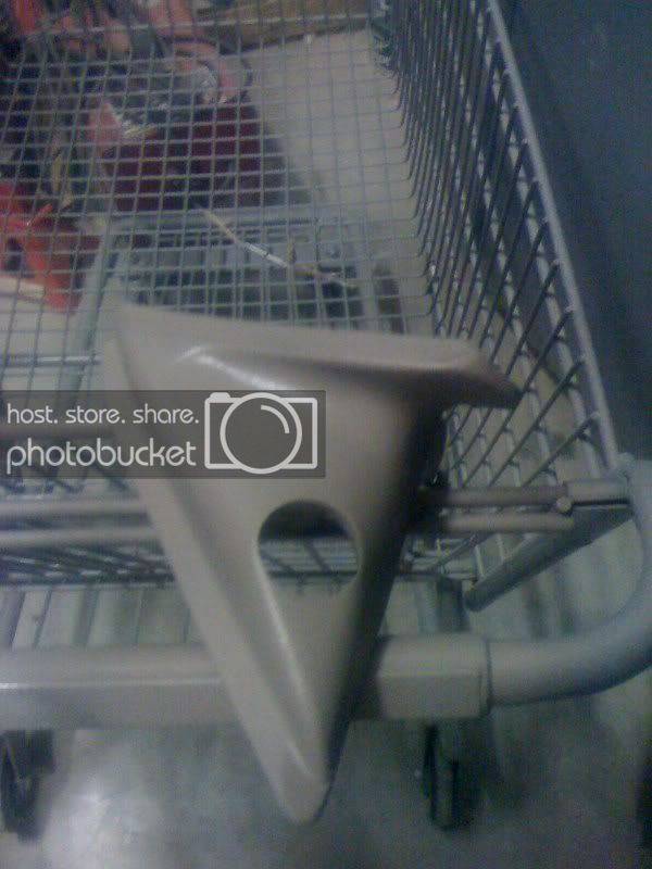

Cut the panel where the tweeter would be located, ca glued the tweeter pod in place and took a little bondo and molded up to the cup. Very simple to do and has a pretty factory look to it when completed with minimal curves on the panel.
And sprayed back with ppg paint that was mixed to be a pretty close interior match.
btw: didn't use texture paint becuase the texture on the dash and doors is totally different then the texture paint and the gloss finish looks kind of classy but not overdone
