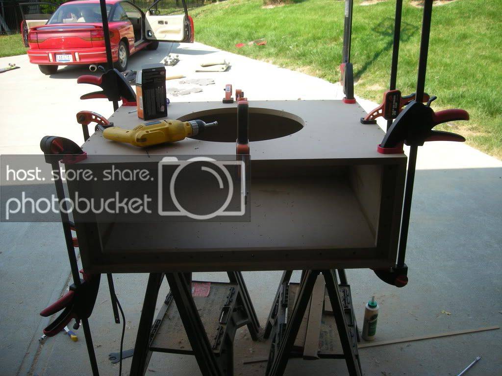

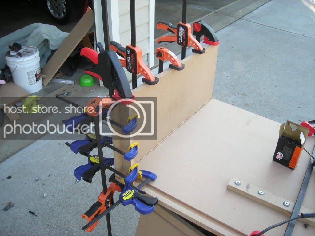

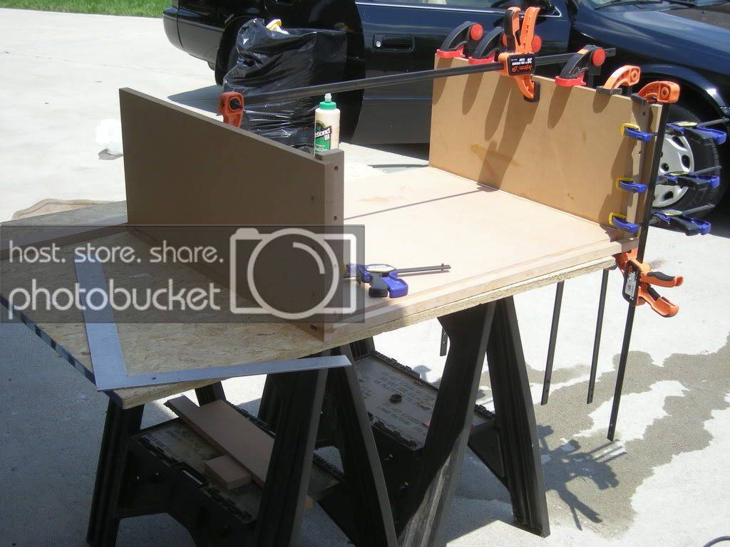

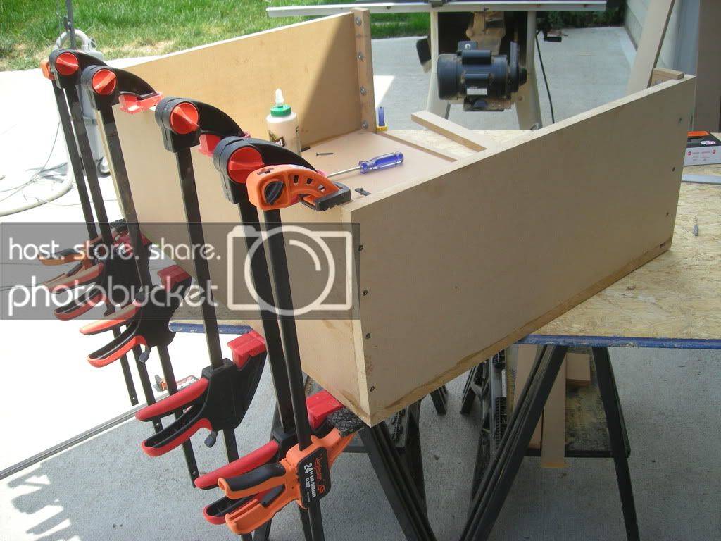

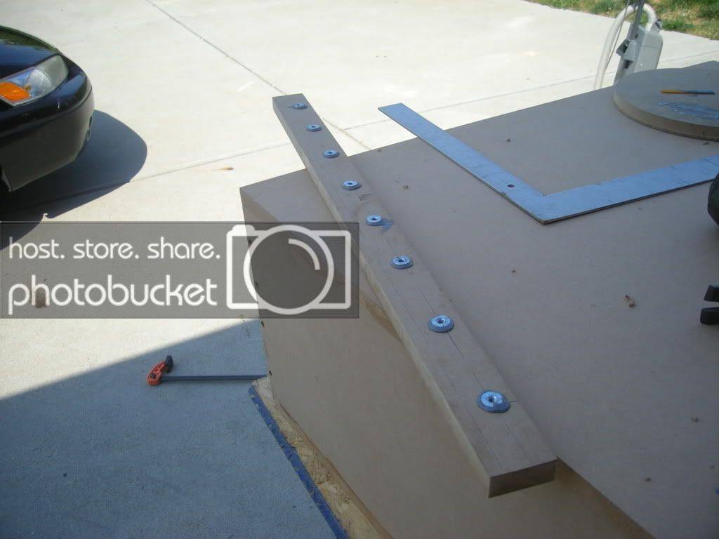

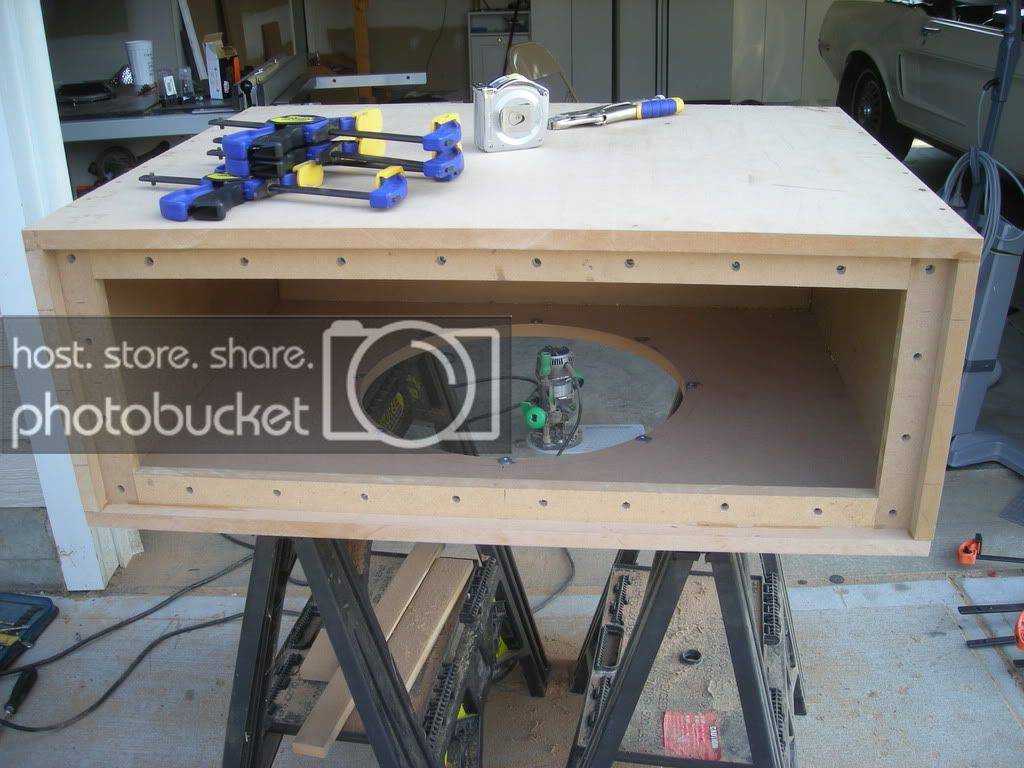

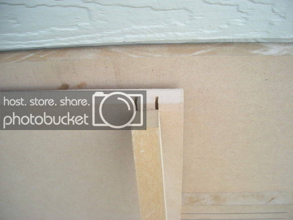

Been thinking of this idea for quite some time and today finally finished it.
For daily setup for the 18" BTL:
-31Hz
-(4) 4" ports
-4.7 cubes

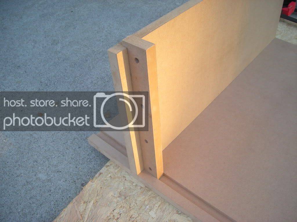

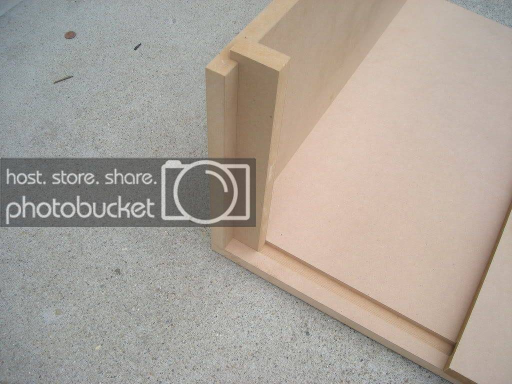

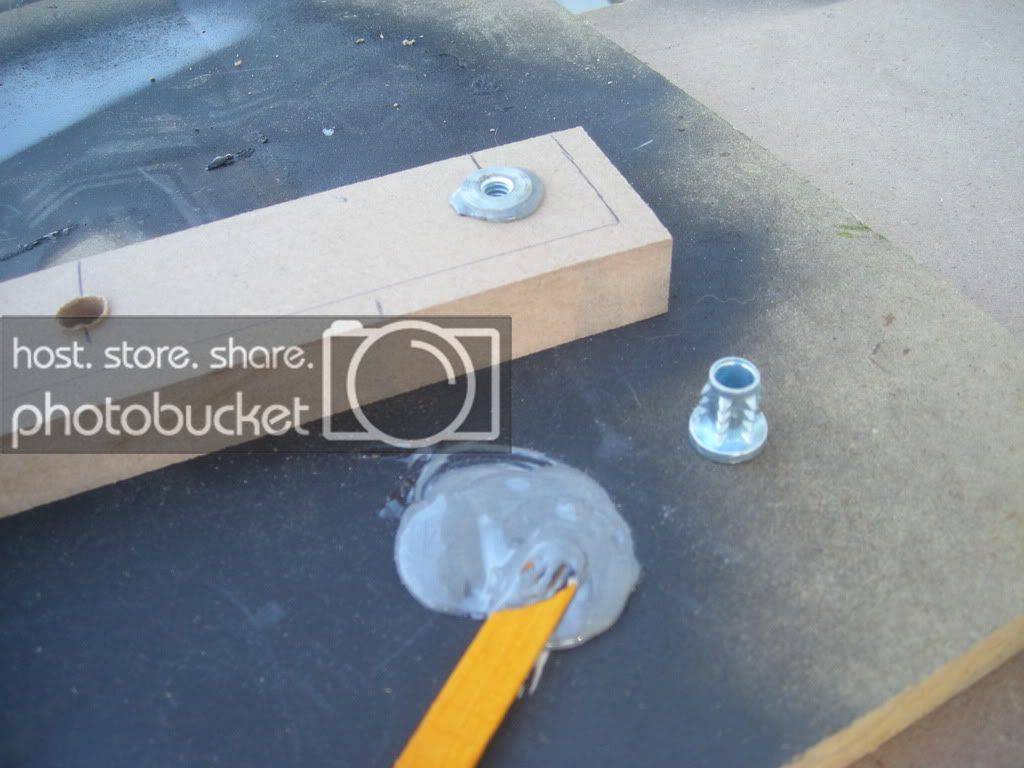

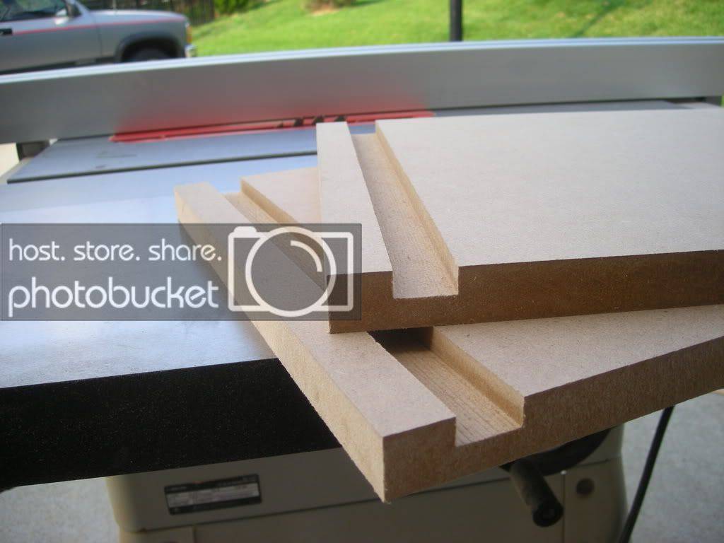

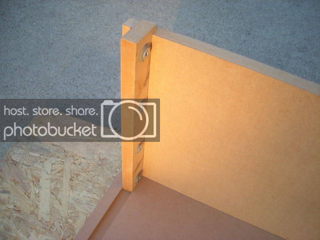

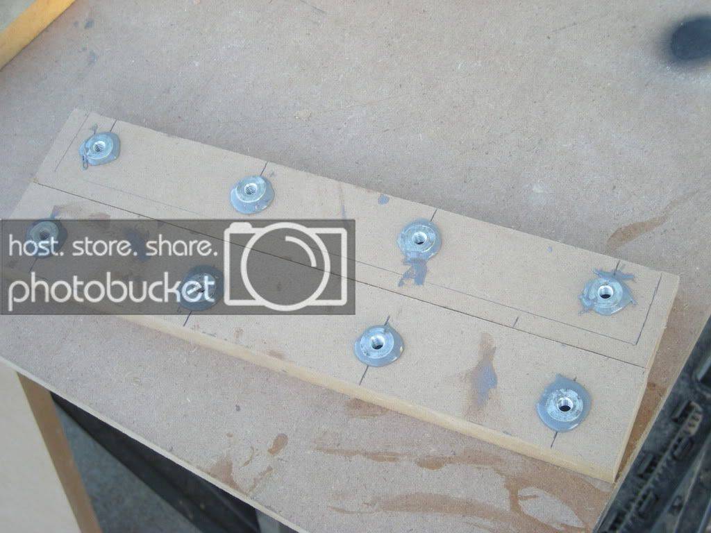

This will allow me to make any port setup I want and experiment pretty much without limitations and without yanking my box every time, just the port-wall...just whip up another port setup and slide it in and secure it in and see how it does //content.invisioncic.com/y282845/emoticons/cool.gif.3bcaf8f141236c00f8044d07150e34f7.gif//content.invisioncic.com/y282845/emoticons/biggrin.gif.d71a5d36fcbab170f2364c9f2e3946cb.gif.
Anyways, here are them pic-a-tures...

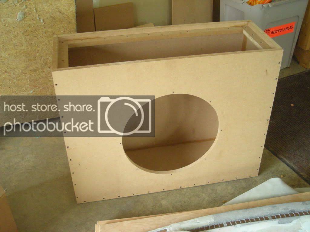

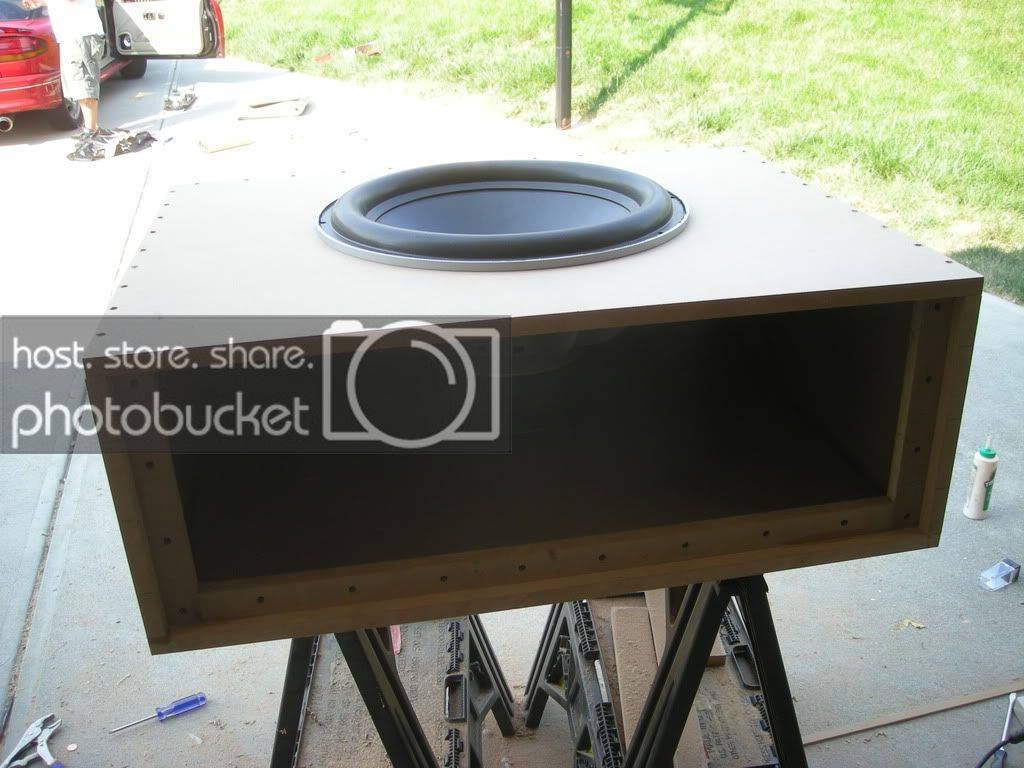

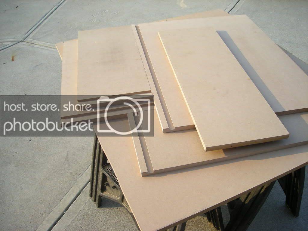

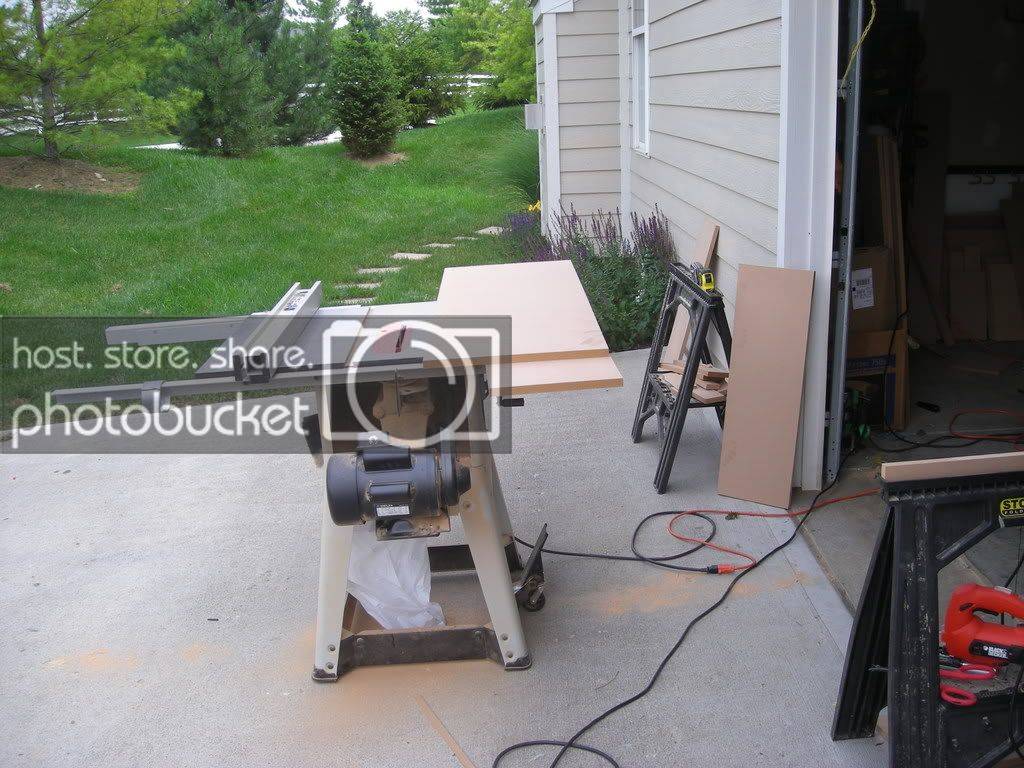

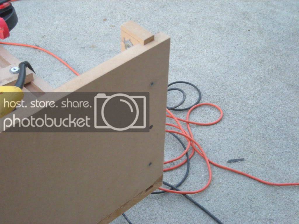

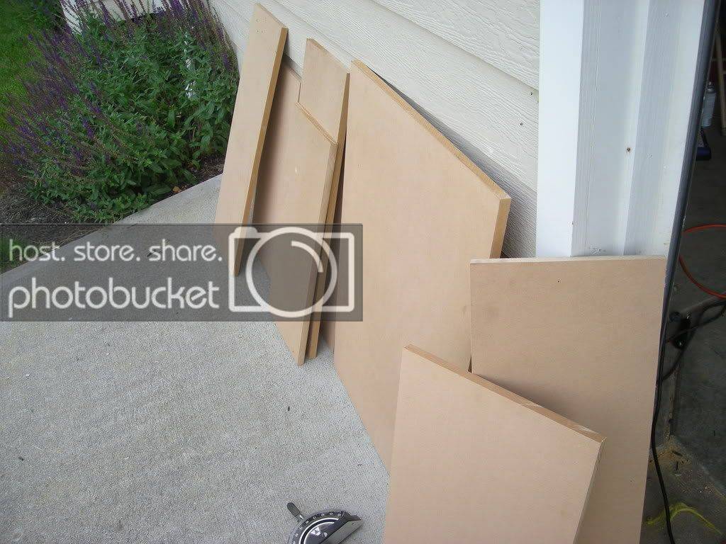

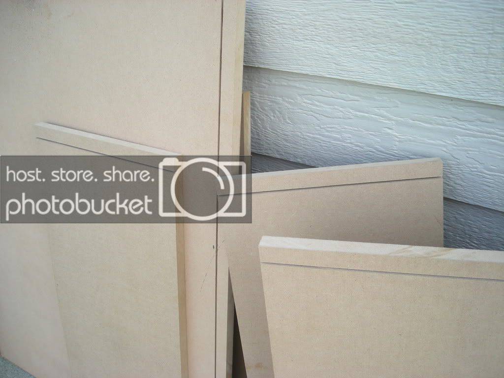

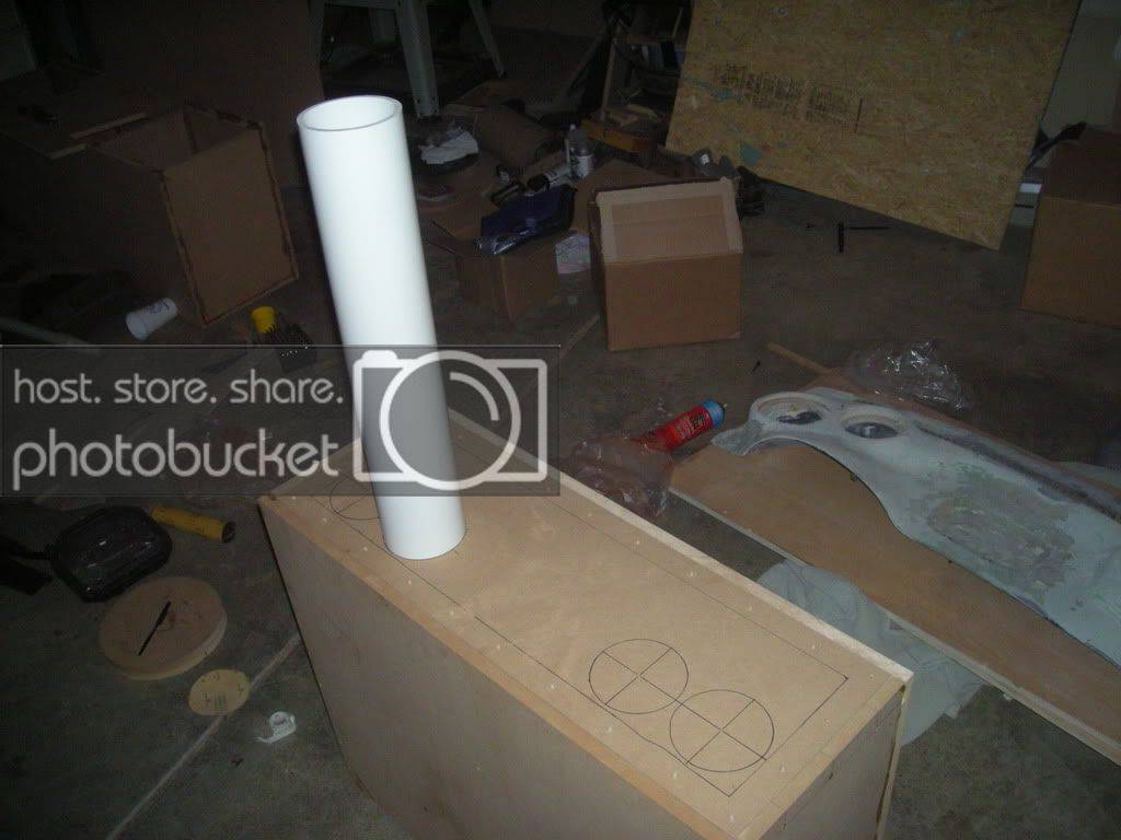

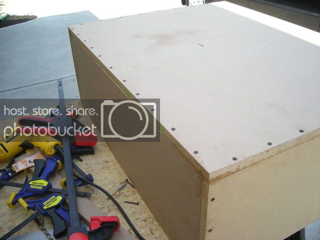

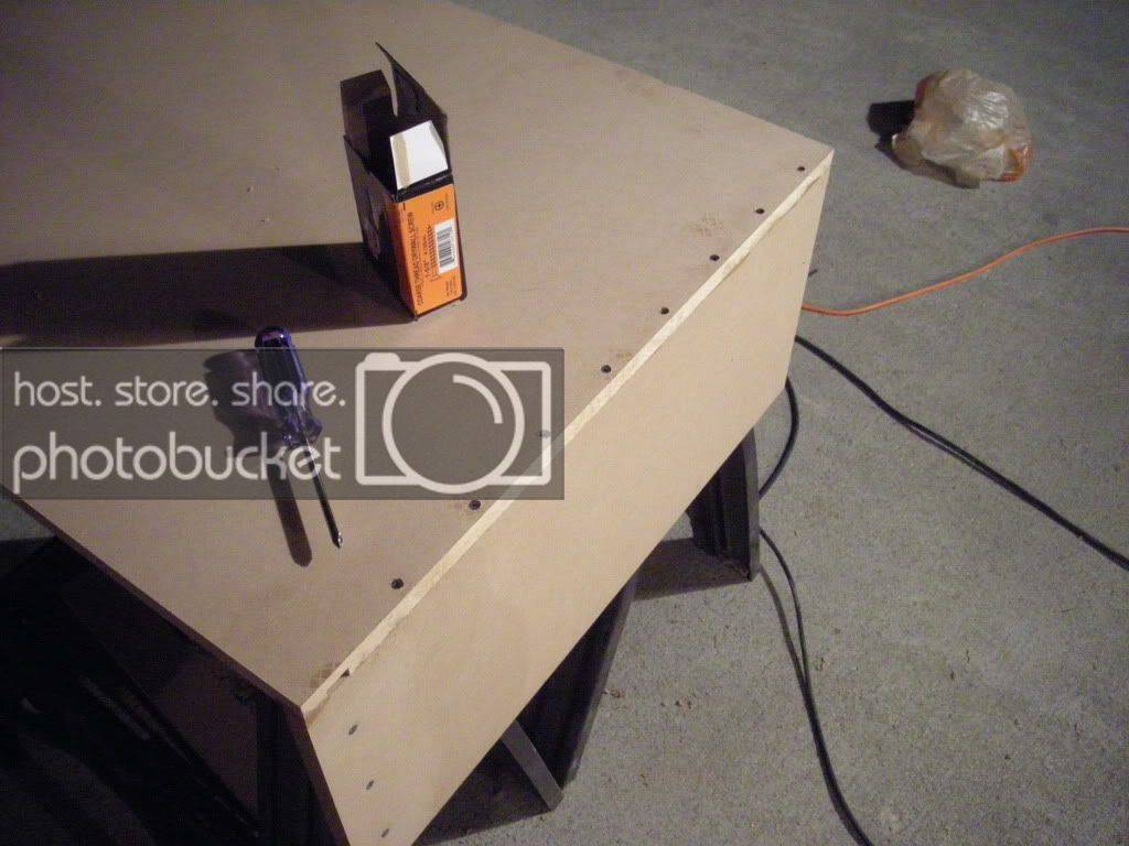

An all too common site..

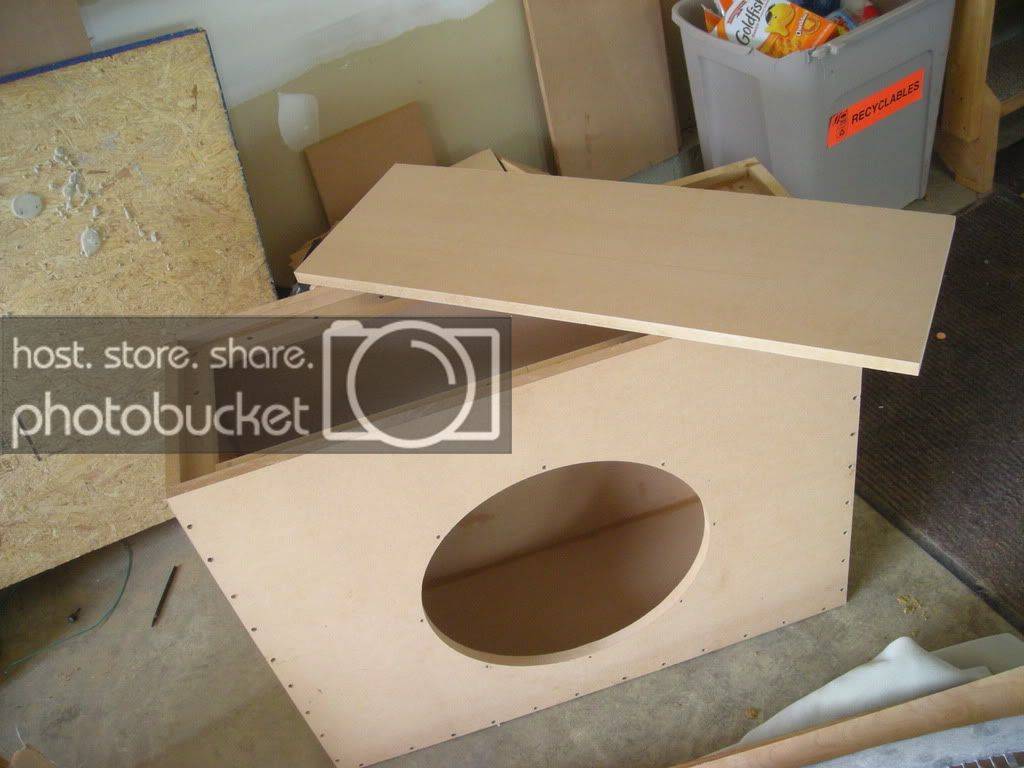

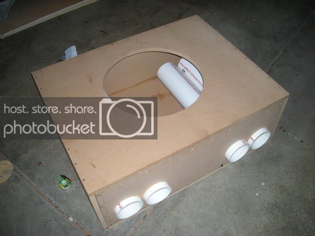

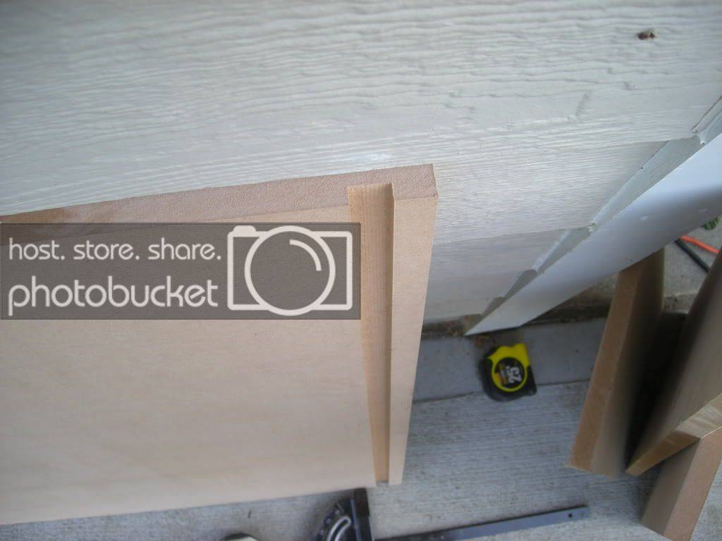

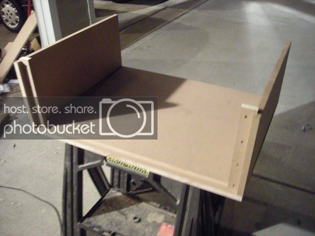

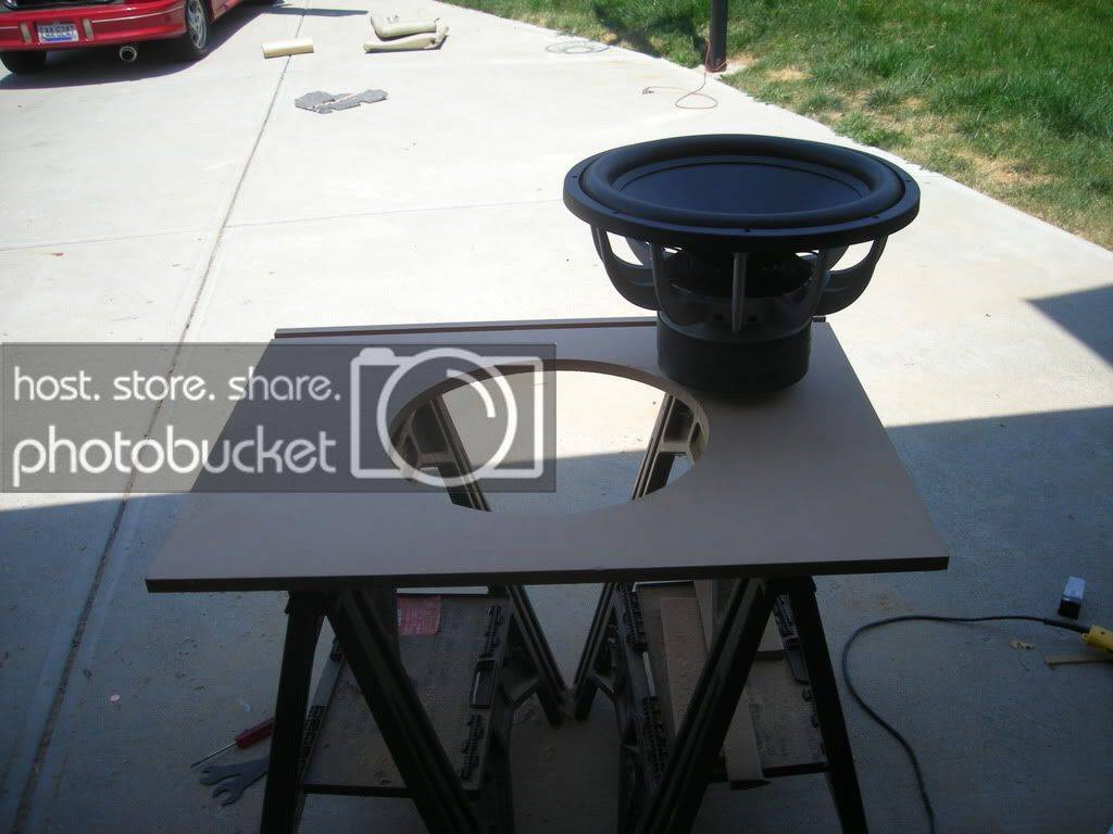

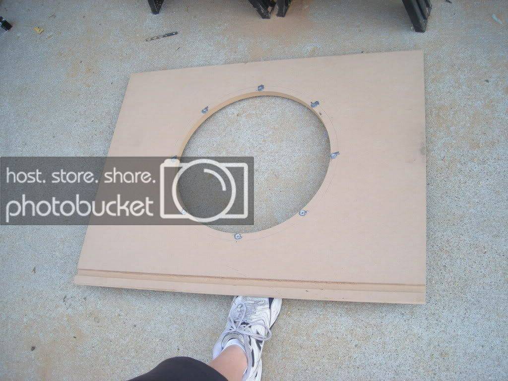

You'll get where im going in a few pics //content.invisioncic.com/y282845/emoticons/smile.gif.1ebc41e1811405b213edfc4622c41e27.gif ...

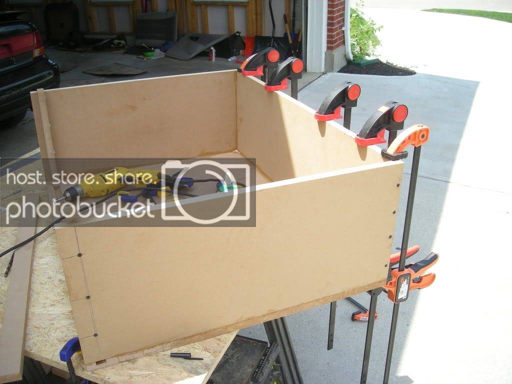

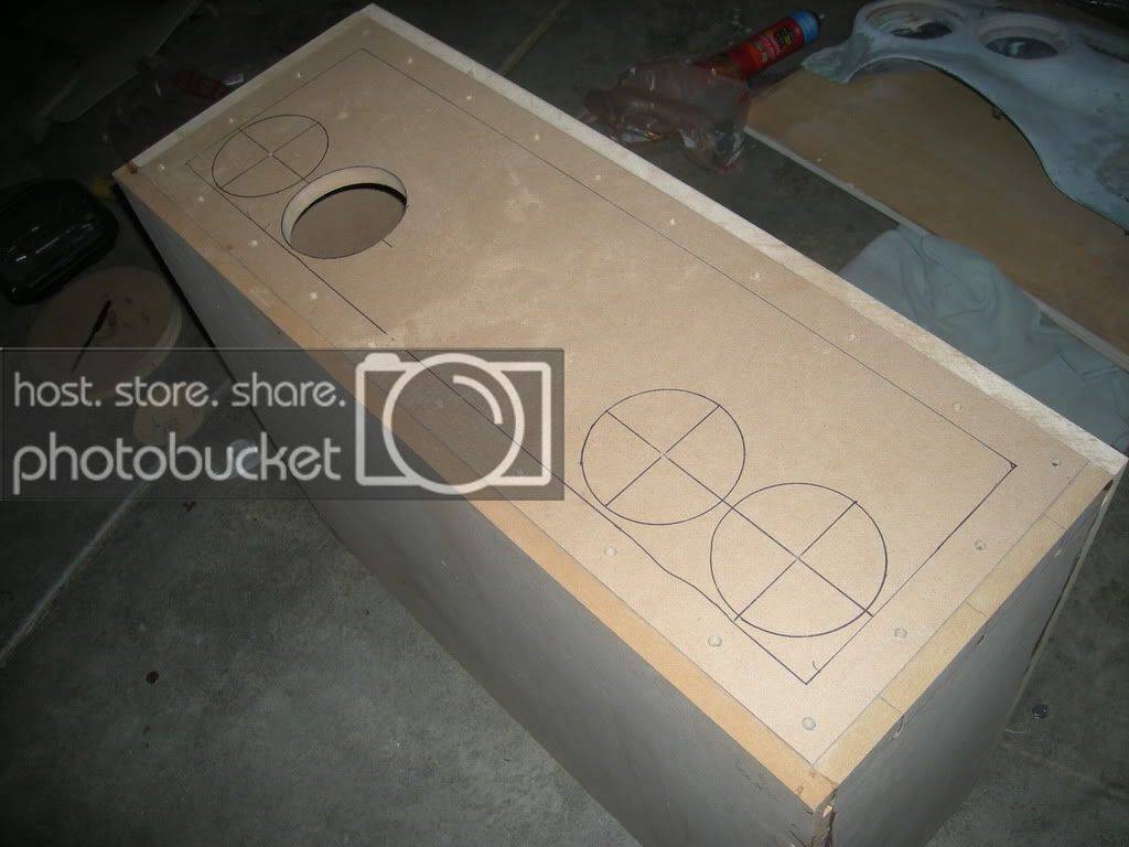

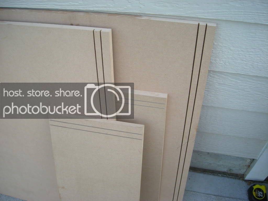

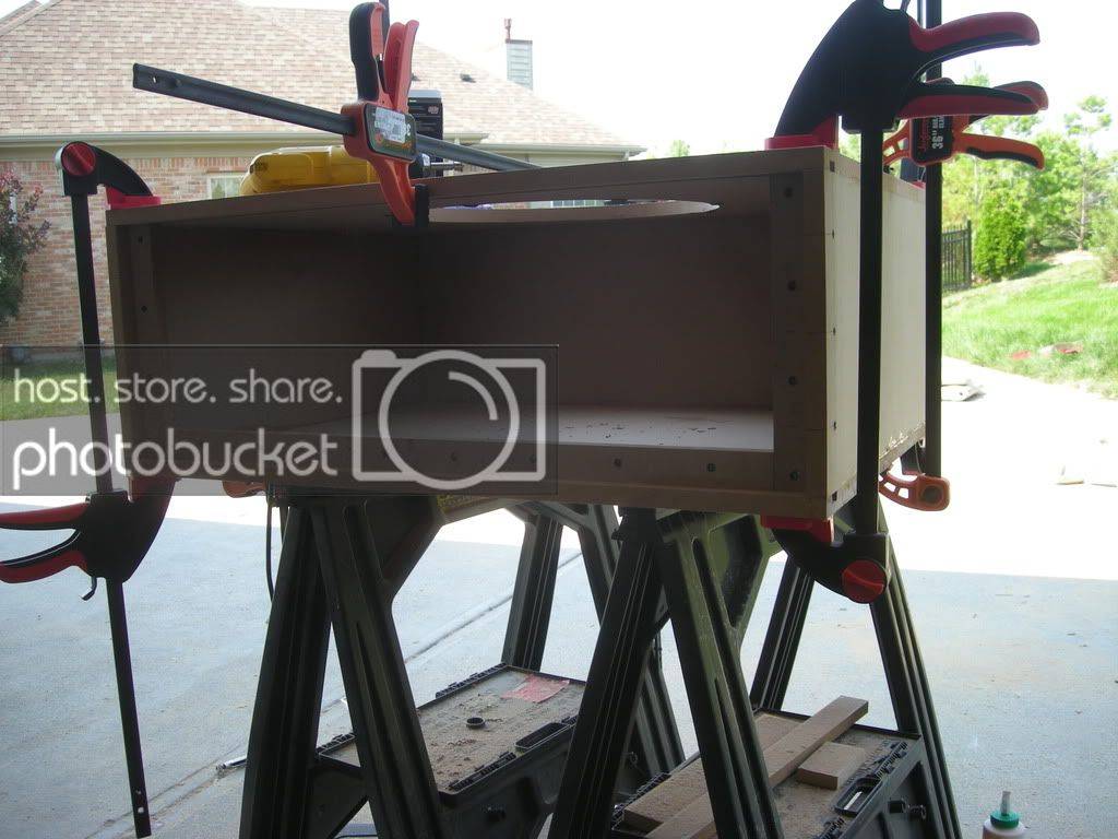

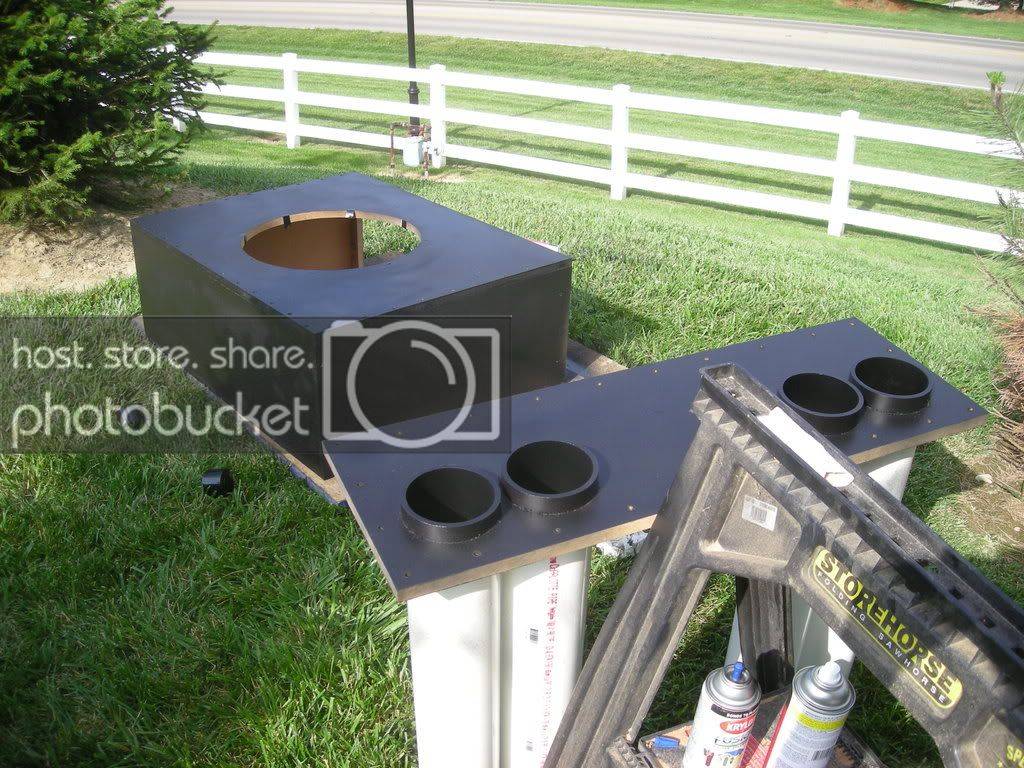

hmmm...

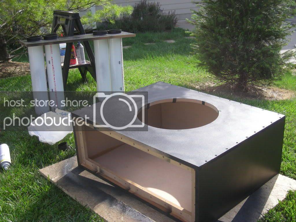

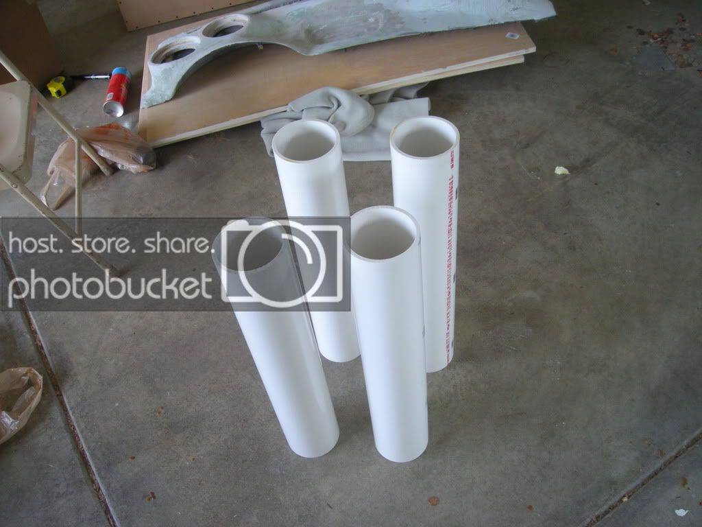

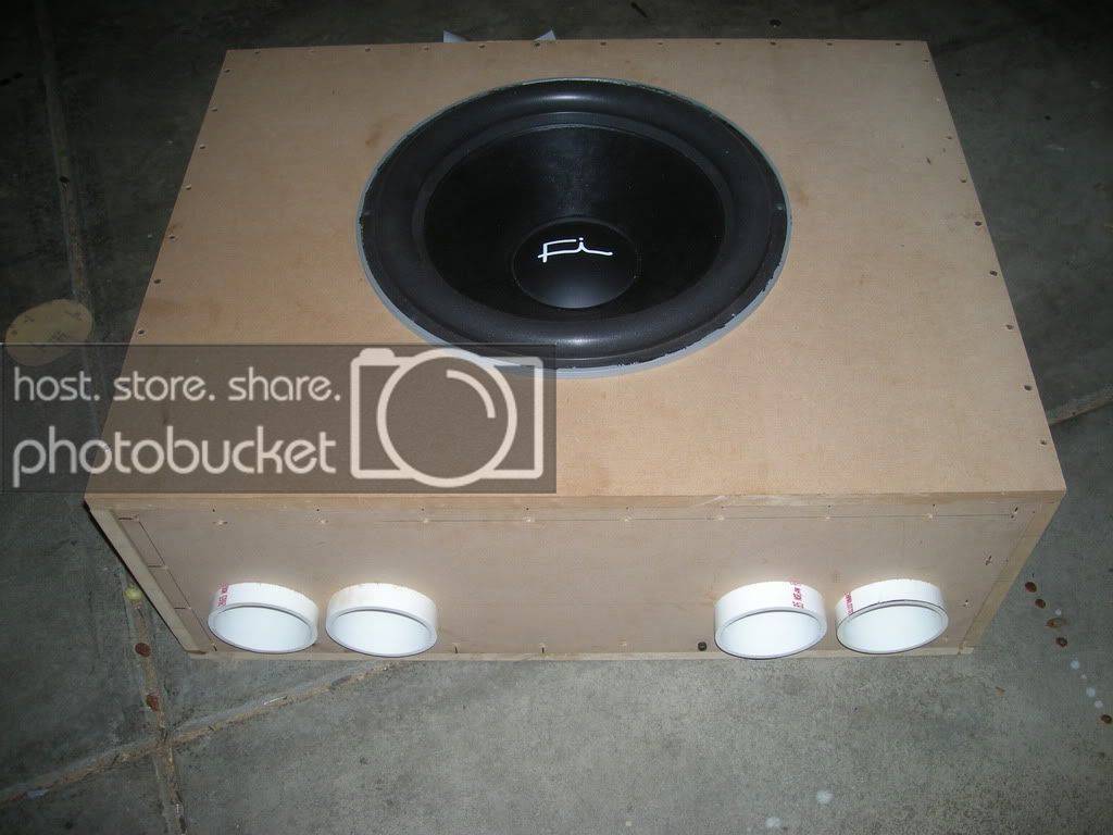

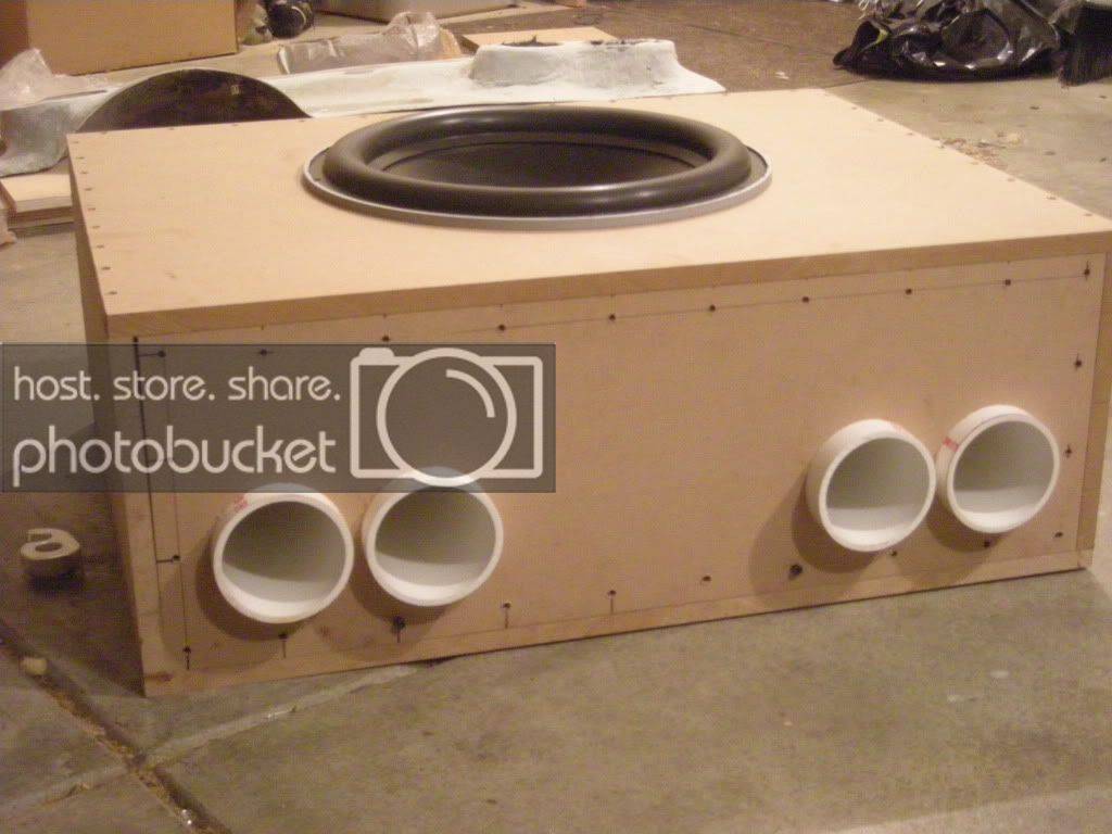

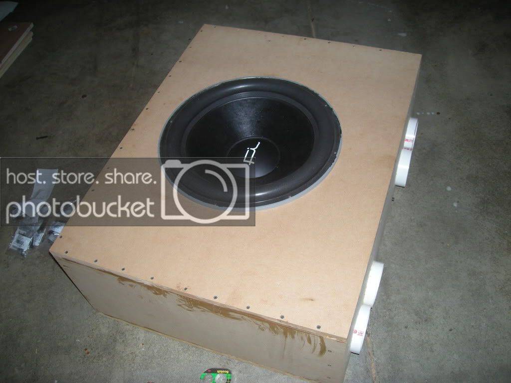

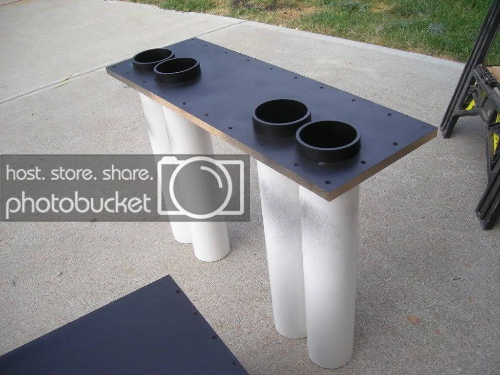

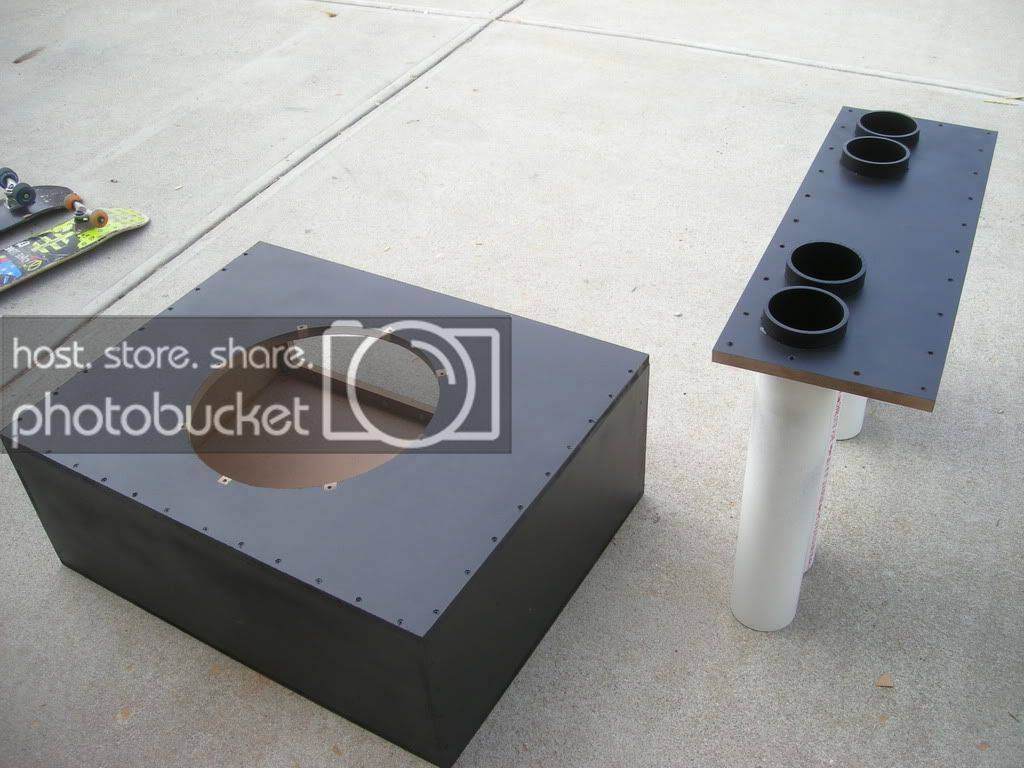

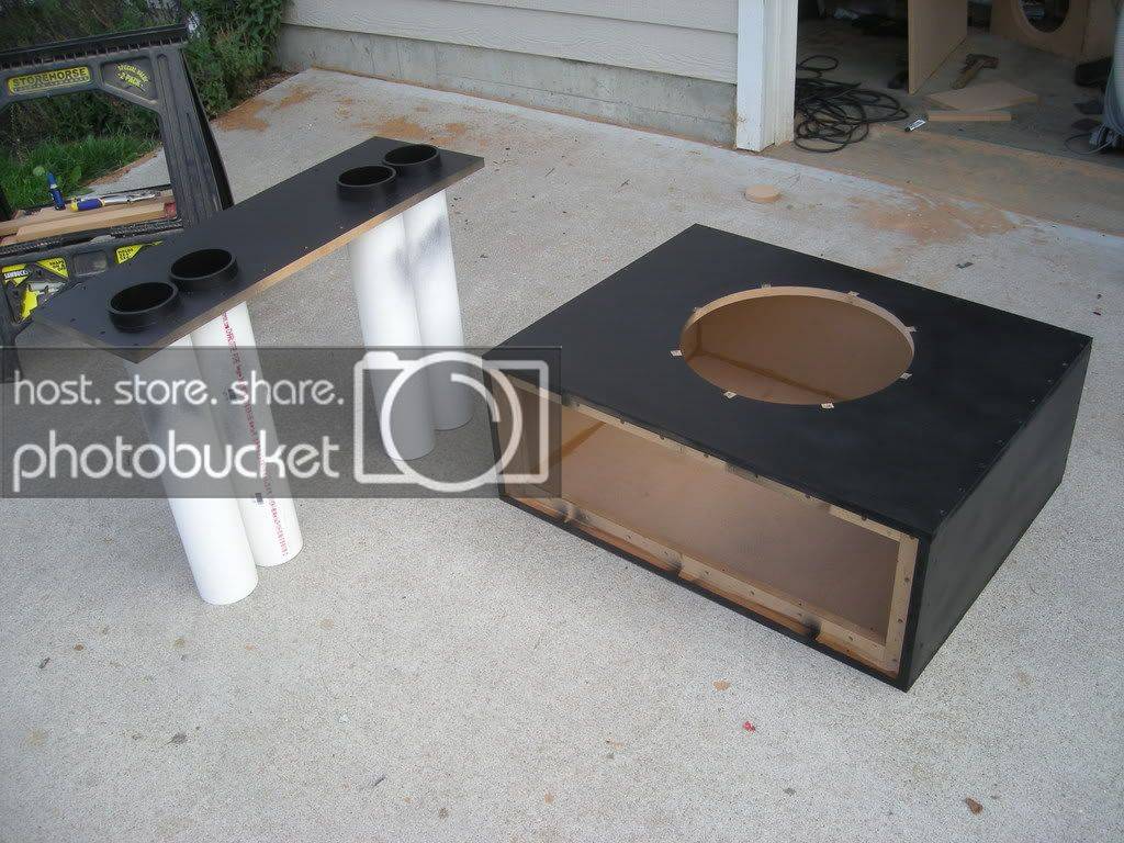

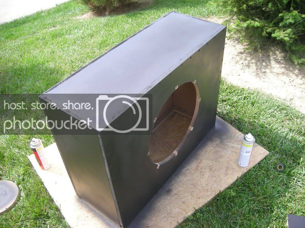

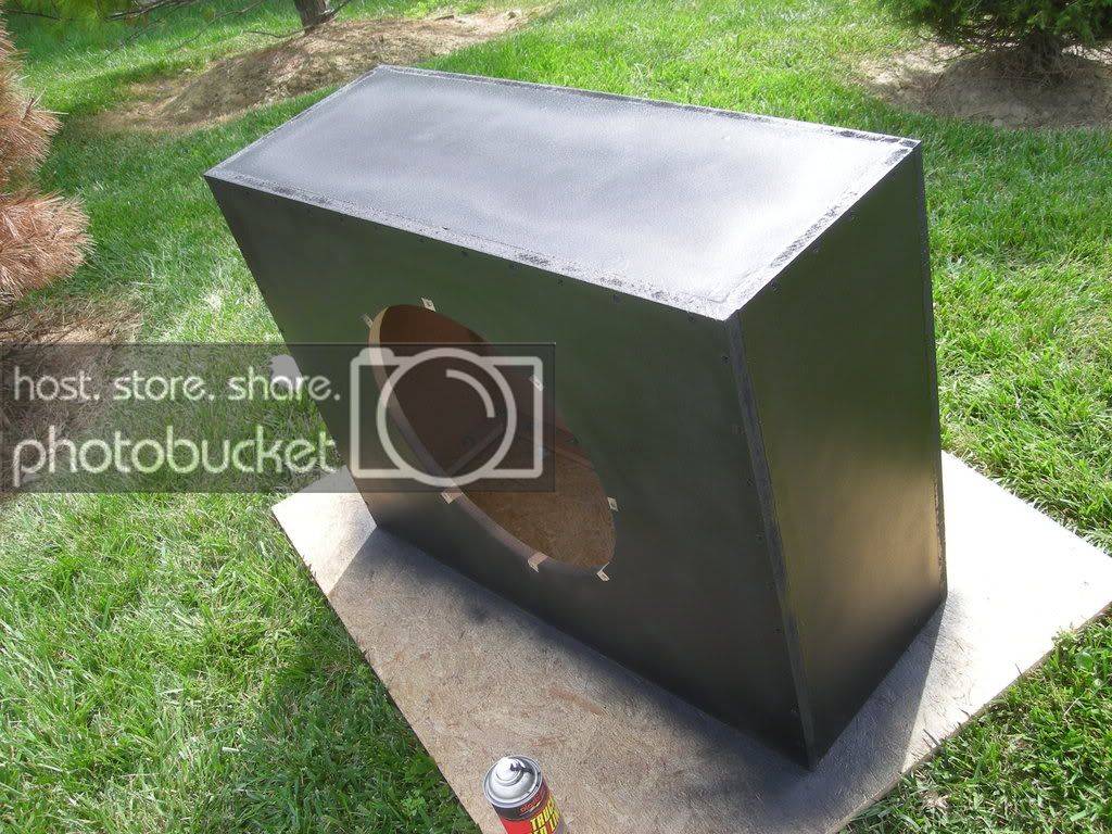

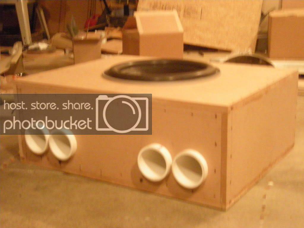

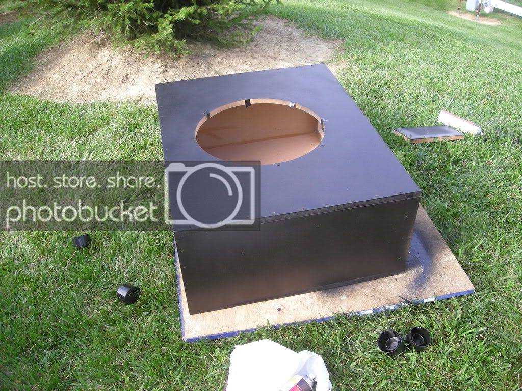

DONE...coated outside with truck bed-liner and the pipes with fusion black paint...

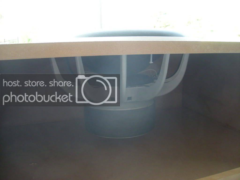

Will have more pics later with the sub in it and maybe a vid...we'll see
//content.invisioncic.com/y282845/emoticons/biggrin.gif.d71a5d36fcbab170f2364c9f2e3946cb.gif but im happy with the results...
I'll try but it most likely wont be a vid of it in a car though //content.invisioncic.com/y282845/emoticons/frown.gif.a3531fa0534503350665a1e957861287.gif because mines still in pieces...
Might put it in my friends backseat of his saturn and hook it upto his Sundown 1500 though...but the 18 will laugh at that power...it wants more! //content.invisioncic.com/y282845/emoticons/smile.gif.1ebc41e1811405b213edfc4622c41e27.gif//content.invisioncic.com/y282845/emoticons/cool.gif.3bcaf8f141236c00f8044d07150e34f7.gif
