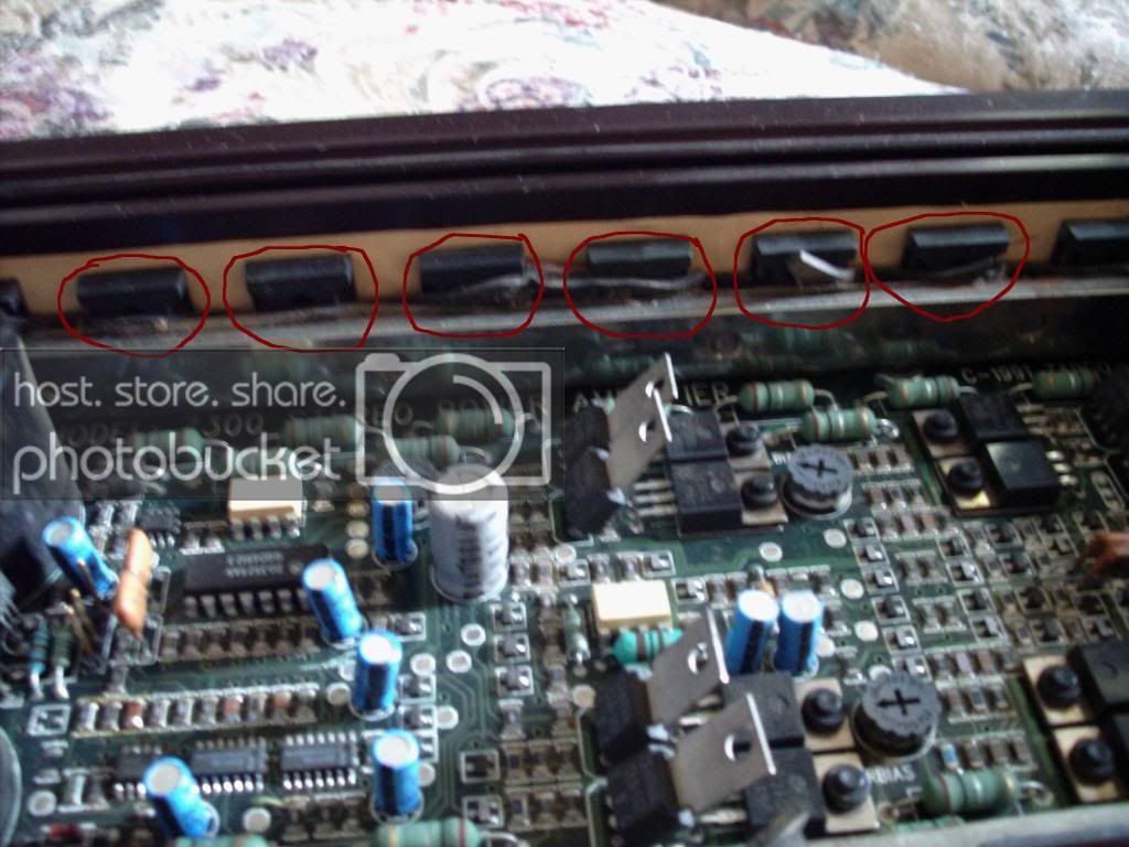

On each side of the amp there is a rail running down the whole lenght of the amp.. These are screwed down with allen bolts to hold down some square pieces that have legs soldered to the board (not sure what they are called) but anyhow they are clean as a whistle shouldn't these have that white thermal paste on the back side between them and the heatsink? I know originally it did cause I opened it up to look for burnt spots etc and couldn't find any.. I also have this amps little brother Z150 sitting here and it has thermal paste in the same location too...

Take pics man. If you don't have a camera, find some pics of another amp online and point out what your talking about (they all have the same parts)
Ok here's some pics behind the parts I circled there is a thin piece of plastic ribbon between them and the heatsink.. On the back of the ribbon there was white paste when I sent it in know it's clean and there is none.. My Z150 has the same ribbon and there is thermal paste between the ribbon and heatsink..

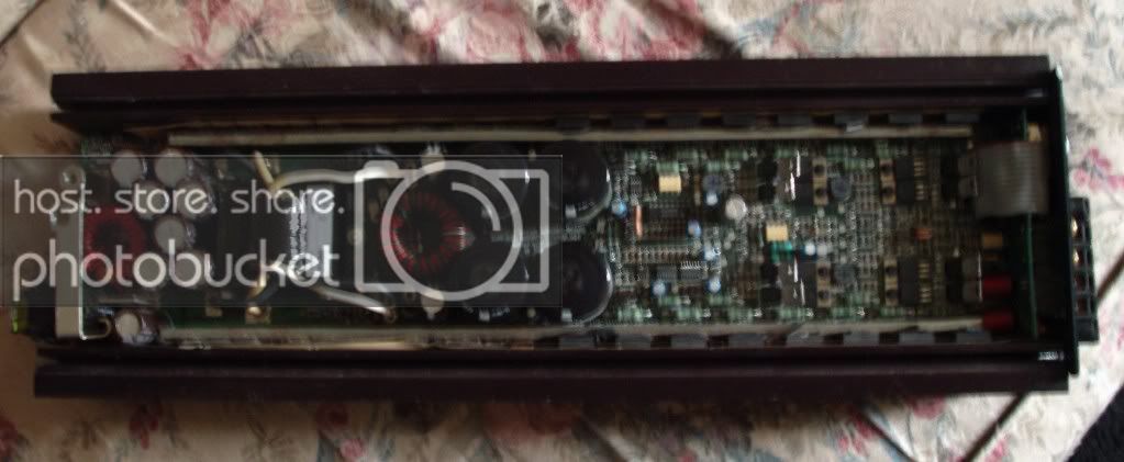

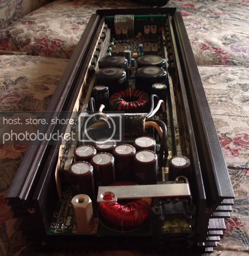

Figure I'll post a couple more pics while i'm at it...
Gut shots..

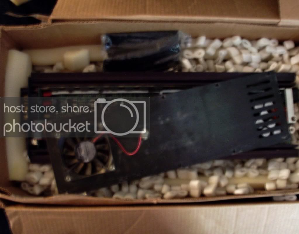

This is what it looked like when I opened the package.. except the amp was full of styrofoam peanuts and a large piece of foam cut to the size of the box was on top of the amp.
Well it kind of depends on what that material is behind the fets (what you circled are mosfets). Normally they come from the factory with sil pads behind them and lots of thermal grease. But we have some new heat sink compound at work that's a green sheet that has it's own strange thermal paste on it, it's a solid but it goes through a phase change at a certain temp and turns into more of a paste. But anyway, can you tell what that material is behind the fets? My guess is, he cleaned off all the paste to make it easier to work on and just threw some cardboard or something in there so he could test it without shorting anything out. Everything about this story just screams unprofessional and I would seriously be demanding money back if I were you.
