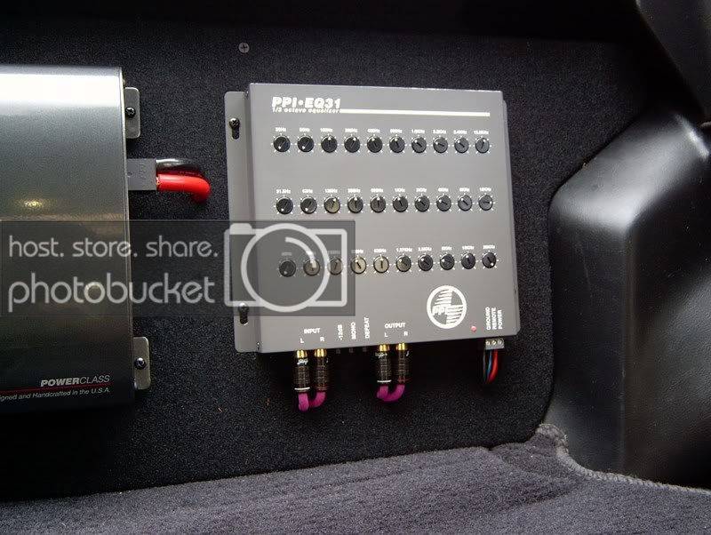

Head Unit: Alpine 7894

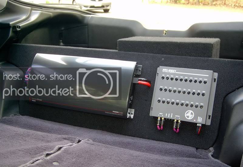

Amplifier: Precision Power PC650
EQ: Precision Power EQ31
Fronts: MB Quart PSD 213
Rears: MB Quart RKC 116

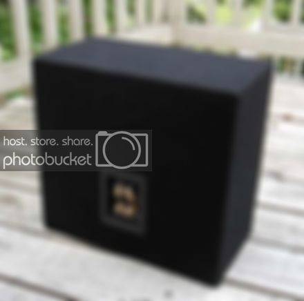

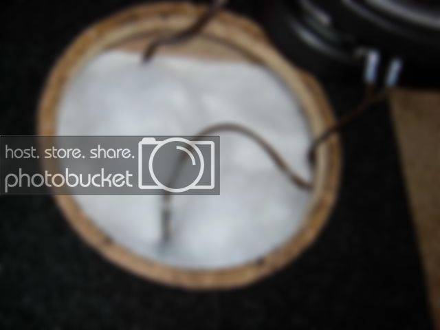

Sub: JL Audio 10w3v2
Head Unit:
Amp/EQ/rack:
Subwoofer:

Very clean and straight forward, excellent setup.....I love single foot print installs:thumbsup://content.invisioncic.com/y282845/emoticons/thumbsup.gif.3287b36ca96645a13a43aff531f37f02.gif:thumbsup:

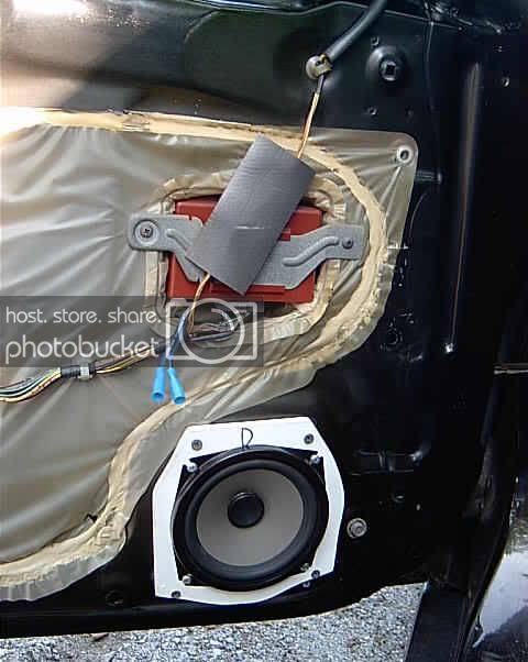

Front speaker install:
MB Quart PSD 213 component set with 5.25 inch mids.
I built plates out of 1/4 inch MDF, then painted them with Kilz to keep the wood from soaking in water and expanding/growing mold. Water manages to get to the back of the door speakers somehow.
Crossovers are mounted on the backside of the panel to the right of the sub box.
I used some Dynamat Premium inside the doors and on the door panels.

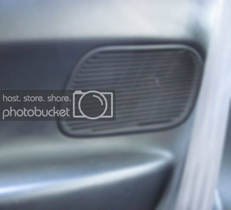

Rear speakers:
MB Quart RKC 116, 6.5 inch coaxial with suspended tweeter. They have a small separate passive crossover, the rectangular black box zip tied to the split loom to the lower left of the speaker.
