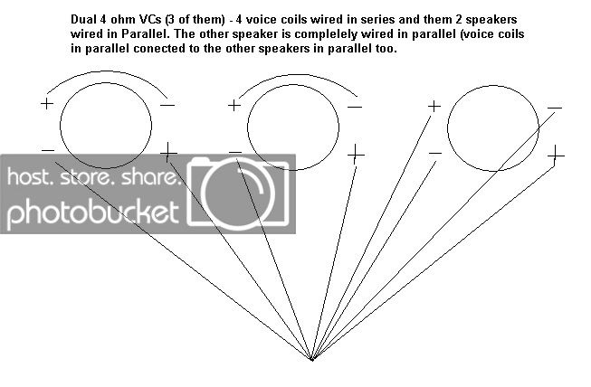

It would be cheaper to get an amp that's capable of about 1600WRMS-1700WRMS @ 1 ohm, instead of 1500WRMS @ 4 ohms. The reason you'll need about 1600WRMS-1700WRMS @ 1 is because you'll be introducing a 1.333 ohm load. If you run 2 of the subs in series/parallel, and then parallel the sub into those that is.
This should explain a little better. If you need help, IM me on AIM @BlacGrandAm

I'm pretty sure your not suppose to do that. im pretty sure the only way you can wire 3 dvc 4 ohms in any useful way is series one coil like you showed for 2 out of 3 but for all three and then parrallel the other and you get a final ratting of 2.67 ohms.

Let me explain this. (I could easily be wrong though.) 4 ohms with 2 ohms, makes a 1.333 ohm load. If you series 2 of the DVC 4 ohm subs, you get an 8 ohm load on each sub, if you parallel those 2, you will get a 4 ohm load. If you parallel a single DVC 4 ohm sub, you get a 2 ohm load. So now you have a 4 ohm load, and a 2 ohm load, if you parallel those, you get a 1.333333(continued) ohm load. Sounds right to me, but as I said, I could be wrong.
exactly and you gotta think amplifier doesn't just see final load it runs through the wires consecutively, with that load the sub on the right is going to be getting more power than the ones on the left which will mess everything up and tuning impossible
yea thats why you dont do that every sub should essentially be wired the same, cause the fact that ya you CAN do other impendences but your going to be feeding your subs weird amounts
o and to answer the original posters question you cant do 2 channel unless you get a specialized amp becaus you''ll be running at 2.67 ohms which is to low to bridge for most amps, best owuld be just get an amp that has the switching power supply so you get the same power no matter what resistance, or at least i thought those were around?
