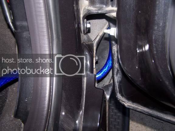

i went through the fender, but the door was off at the time getting painted so i drilled right there by the bracket and it ended up perfect, you cant see it with the door open or close. i clear coated the hole, and put a rubber weather seal. 4 years laterr no rust, and its ran into

g/l.... there isn't a better way.... unless you want to get laughed at (through the fender into the door... uber ghetto style)
hey now, I went through a grommet on the side of my car through the fenderwell
Only because my engine bay makes it almost impossible to run through the firewall. Common places for my car are through the steering column boot. Which i didn't want to do. And a mthyical "plastic" grommet that can be drilled out if you remove the glovebox. Well guess what, good luck drilling it out and getting anything larger than 4ga through it.
The way I did it the wire doesnt ever flex, the door never hits it, it runs into the car through a rubber grommet, from there its run under the carpet to the trunk.
