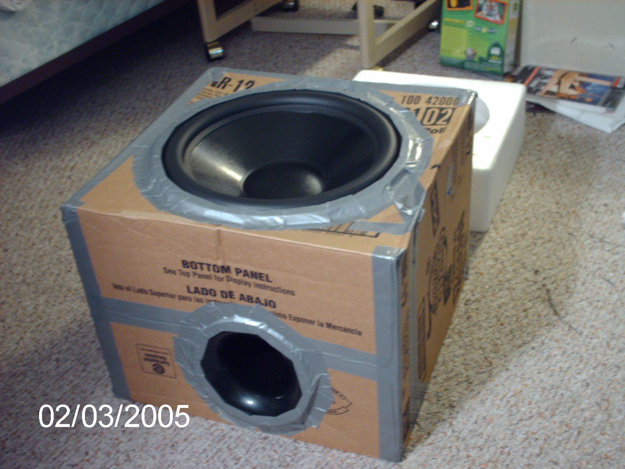

oh, sorry for the misunderstanding earlier
something like this
20x20x20
but no really Who the fuck cares, its a power acoustic, do you want it to hit highs or lows?????????
well its actually for a friend and he jus wants it to be loud
and the box atleast has to be made out of wood lol
ill jus tell him to put it in like a 2ft3 box and call it good
just make him a 2 cubic foot ported box and call it good. This is 2 cuft net, but probably around 1.75cu ft after displacments.
