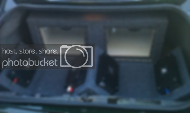

2 12's works great in those cars.....
Here is a quick setup we did for a friend at the shop. Just wanted to get the system up and running ASAP so this is what we came up with....
(we used existing wiring he already had and just tossed a box and amp rack together for him)
yeah that looks like 15's would be a squeeze. I'll look for a good pair of 12's then. Thanks Rabbit!
P.S. is that a bandpass or are the cones & ports facing into the cabin?
That is just a standard bass reflex enclosure. It will have a bandpass with 4 10's in it rather soon though lol.
The sub/port direction is dependent on a few things, but from what have had the chance to test with those cars sub/port forward worked the best overall. The other option was sub up and port to the side. We did that with a single 15 for a while in his car, but the amount of rattle was just insane and no way to fix most of it. It did sound good and loud in the car though.
The new setup will be a 4th order ported through the rear deck.
