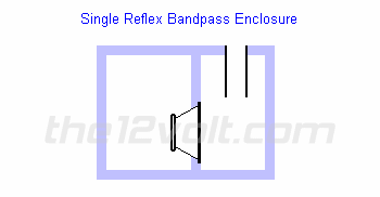

i was wondering if this concept was even viable. imagine a small (1.0 ft) sealed fiberglass enclosure tucked in the rear corner of a trunk. the majority of bass waves are trapped in the trunk and only find passage to the cabin through small openings in the rear deck.
question: is there a way to design ports for those openings to facilitate the passage of bass waves through them? basically, i think it's like designing a single reflex bandpass enclosure.

yep. basically the way i figure it is the trunk is essentially the second chamber of the enclosure. based on reading this pdf file, "as the ported chamber increases in internal volume the system becomes more efficient." however, as that happens "the bandwidth becomes thinner."
with my car, a '95 bmw m3, the trunk is very tight and i believe my alumapro bp-10 suffers from the "one note" bass mentioned in the pdf file. now, i understand to gain the exact appropriate port length would be impossible due to the fact the trunk is not sealed blah, blah... but my question is: does anyone believe the use of ports hanging from the rear deck (possibly tappered ones) would improve the range of bass.

You should experiment with various lengths of PVC pipes. Even though it will be difficult to impossible to calculate the tuning frequency, you could always experiment by ear to see what you think sounds best. I doubt it will work well but there is a pressure build up in the trunk which will excite the air mass in the port.
I would start with like 2 or 3 4" PVC pipes and start them with a length that is close to the max height you have available while keeping the ports about 6" from the bottom of the trunk. Then, you can trim them down and see how the sound changes.
Be careful though, as making small changes may make the differences harder to tell. You may want to have two sets and make one set your max length and make the other only about 4" deep each or so. Replace them back to back and see if you can tell a difference. It will only cost you around $10 at Lowes for the PCV pipping.
