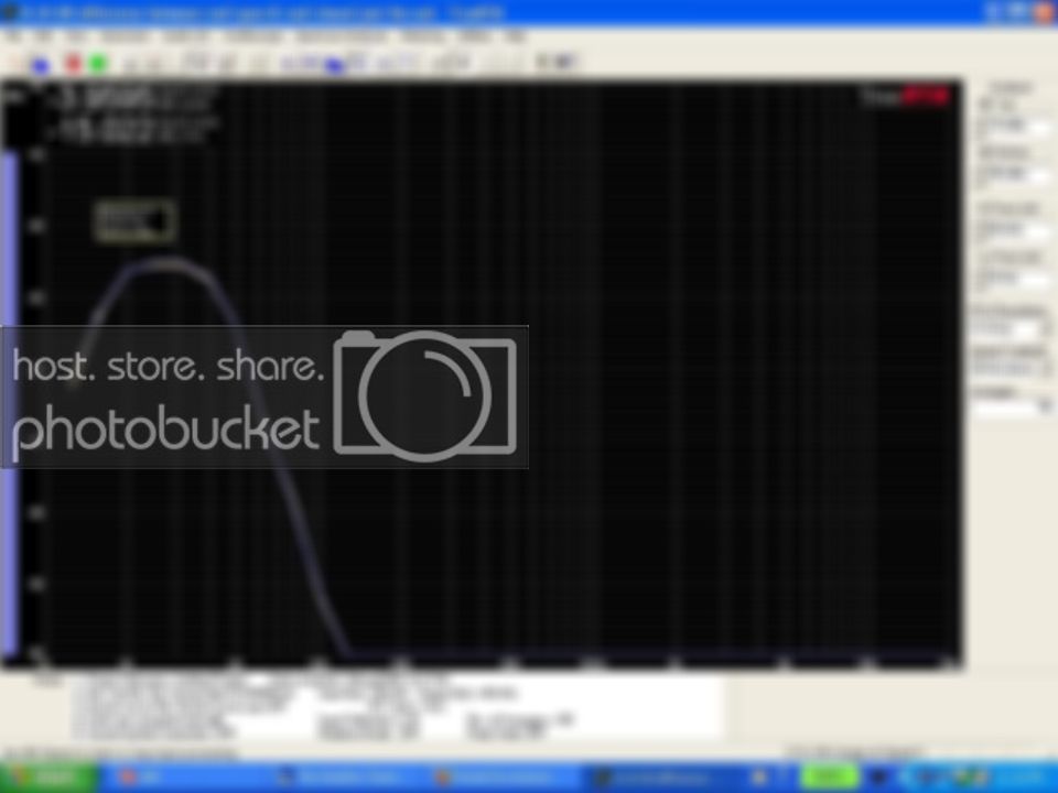

you can get flat response down to 20hz with a ported sub tuned to 30hz //content.invisioncic.com/y282845/emoticons/fyi.gif.9f1f679348da7204ce960cfc74bca8e0.gif no need to tune in the twenties.
