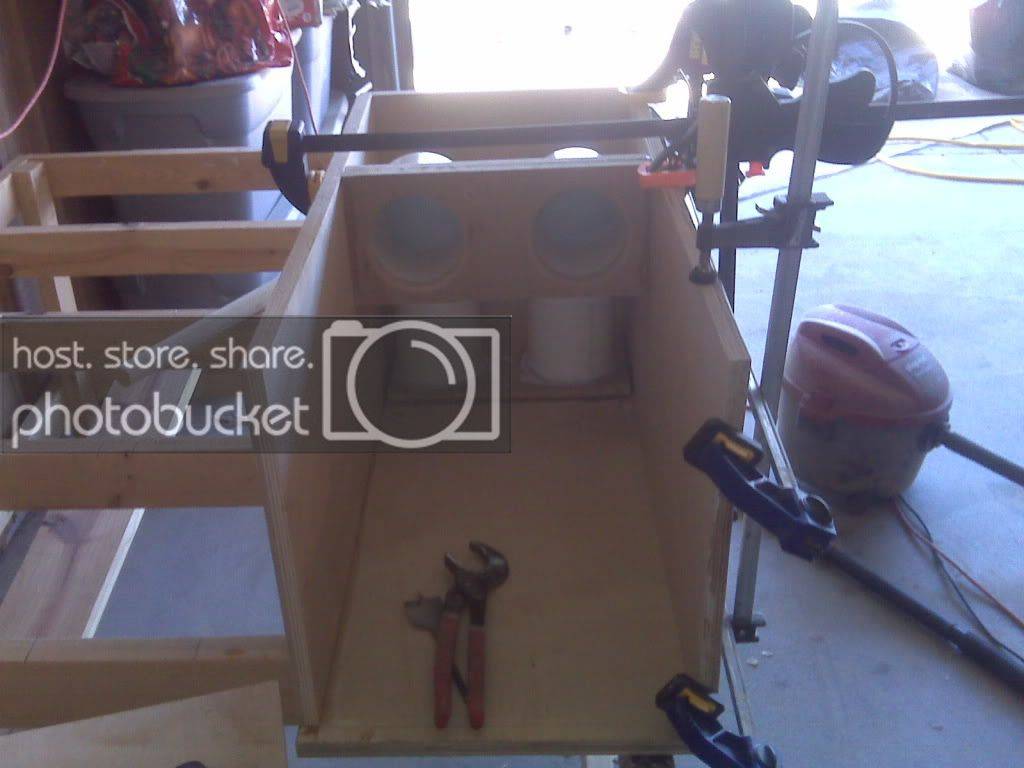

not easy to describe without pics....basically you take a small piece of mdf and cut 1 hole in it the size of the OD of the PVC and glue on. Then you glue that piece to another piece that covers the end of the PVC. Then drill a hole through the cover piece and use the router and a flush trim bit and router the ID of the PVC. Then use a roundover bit to "flare" the MDF....do that to both ends.
hard to see but thats what i did here
Do you do it to the outside too or just the inside? Or does it even matter? Also the length you gave me on the port length will that be the length minus the wood the way you do it?
