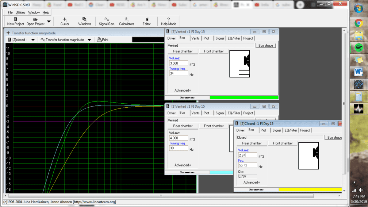

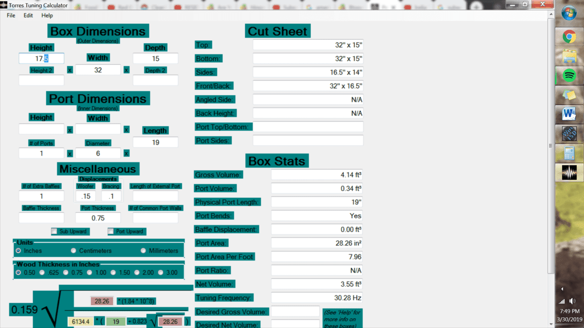

I'm guessing you are completely new to ported boxes.  The port changes depending on your cubic feet airspace, you dont keep whatever bullsh*t they recommend because its beyond stupid recommendations.  box size and port size, length have a direct correlation with box tuning, power handling, and bandwidth.  I'd recommend youtubing up how to use winisd and download torres box calculator and get proper box numbers with projected response graphs, rear air velocity etc... like so.  You just need enough port area to avoid compression and get the tuning you need which will be rear air velocity values on winisd. Too big of a port and too small of a box will literally make it absolutely impossible to get the tuning you desire and you'll still end up in the high 40s port tuning.
Yea i was gonna look at WinISD, i assume its gotta stupid price tag on it. However, im dealing with a circular area of yet unknown volume. I was hoping to measure it today, but it decided to act like the amazon rain forest during wet season. And yea, new to ported boxes, but with the space i have i might have to stick to sealed. Im just obsessing over the potential lack of volume potential with a single sub and 500w to it. It may well be more than i need, but ive only had experience with two 10's and around 200-225w and that was about 18 years ago.
