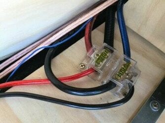

I have 2 amps a 1000w 4 channel for the door speakers and a 2 channel bridged amp for my sub, the thing is while running the sub amp in bridged mode it’s perfect but when I add a second sub and use it as a 2 channel amp I get a loud POP when the system shuts the amp off! Both subs are 2 ohm and the amp is supposed to handle this setup! It doesn’t matter if the volume is all the way down or 1/4 1/2 3/4 I get the pop unless I bridge the amp with just one sub? Any ideas is it the amp do I need a new one or is there a filter I can use or do I need a Cap? to stop this it’s loud enough that it may damage the subs eventually.
