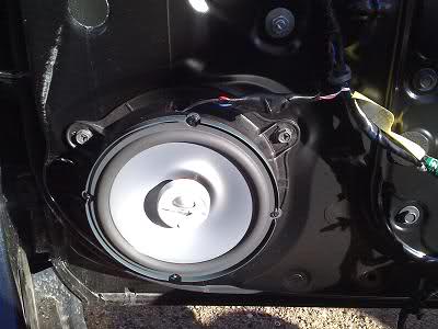

Here are the actual MB Quart speakers just to be handy:
I've already taken them out of the wooden mounts they were in (they were put in these wooden mounts to fill the space in a 300ZX where the old very large (due to being self-amped) Bose speakers were.
things to be careful with and to pay close attention to when installing the new speakers. the link you provided fell short in a few areas.
here, we see they neglected to seal the hole where they ran the wiring through the stock plug
i am not against reusing the stock mount, but you need to get good seals.
here we see there is no seal between the speaker and the door panel/grille. this allows sound to get behind the door panel which will cause a multitude of issues.
the best thing the stock system had going for it was factory seals and optimized speaker selections.
i don't run rear speakers and I have a 4-door sedan. Amplifier selection will strongly determine sound quality, as will speaker choice. Based on the discussions above, I expect you will be both happy and disappointed no matter what you choose.

Good catch -- I can definitely seal the top gap where the factory "plug" went into the speaker "spacer/bracket". Appreciate the eye.
The stock mount actually provides the best seal compared to aftermarket solutions that are a bit generic and don't fit as good as this does.
Hrmm. The factory speaker didn't have a seal between it and the door panel/grille -- The speaker Grille covers pop off from the outside, and that 'gap' you see there is there from the factory.
That said, I'm sure it will sound better sealed. You see how that is offset a bit,.. what would you use to make that a better seal between the speaker and grill? I could use sound deadening material packed around there and some good tape to fill the open area? I'm not a master fabricator so fabricating a perfect piece to fit in there probably isn't going to happen,.. but if you have any ideas.. or if my idea of the sound deadening and some good tape would help a great deal that's a fairly simple solution.
Believe it or not the only seal the factory had this picture doesn't was that white square plug that is now an open "hole" on top of that spacer/mount.
