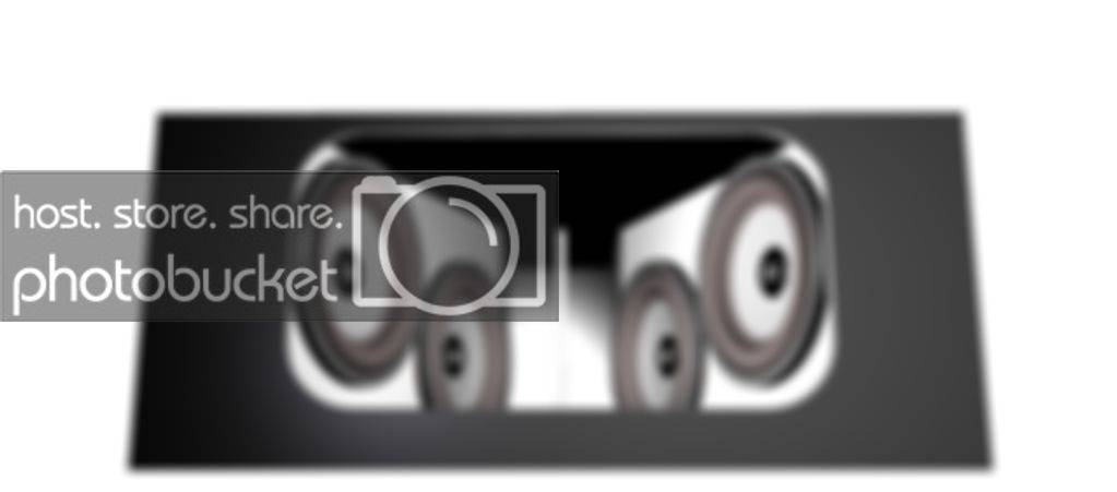

POLL: Invert mount or no?
Invert two subs or leave them all normally mounted?
  • Yes! Invert two of them.
    Votes: 5 33.3%
  • No! Mount them normally
    Votes: 10 66.7%
  • Total voters
    15
Supergumby5000
Project: F350 begins...
Give me a sec to get the poll up with this laggy *** forum.

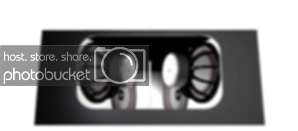

Two pics provided, vote inverted or not inverted.
Sorry for the crappy rendering, i was too lazy to put any better detail or flip the DC logo.
One benefit to consider being gained by inverting one driver per pair, is the reduction of harmonic distortion created by any non-linearity in the suspension. It's called push-pull and it sometimes yields a dramatic difference. Even the best drivers don't always offer completely symmetrical Cms plots. The downside might be that some drivers have large amounts of mechanical and turbulence noise that may negate that effect.
