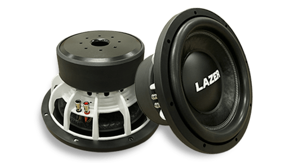

The only advantage to using plywood is the weight or when doing IB walls, kerf cuts for certain ports where you have to use plywood. Good quality birch ply is around $85 to $120 for a 4x8 sheet of furniture grade ply. 3/4" MDF with quality construction using braces (as would be the case with plywood too) is more than adequate and definitely cost effective at about half the price.. On another note, why that Sub? What little I could find indicate it is recommended for a sealed enclosure. Additionally, the FS on it is around 36, not very low at all. There are a lot of subs out there for that kind of money ($500 ea) that would work better. That sub is designed for competition and around 5000 watts rms, 2 up to 10000. You are going to sacrifice sound quality and efficiency to attain those kind of power handling number's. THere are a lot of very capable and worthy 12s on the market that I would get before those.

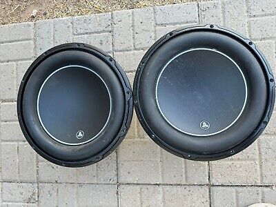

A pair of used JL Audio 12W6v3-D4's $1050

Really, didn't see that they were that far out. I found the driver in Bassbox 6 pro, looks like is really likes the sealed box. I could not find one site that had recommended enclosure sizes or recommendations. The 2 cube box looked to be tuned very high for a sub as well, in the mid to upper 40's. The best curve looks like Net 2.75 per sub, tuned to 33hz. Dual chambered for strength, each chamber needs to be 2.75 (net) cu ft, each chamber needs a 4" round port that is 8.5" long. That will give you the most volume and a 31-33 hz tuning. that's frigg'n big box!
