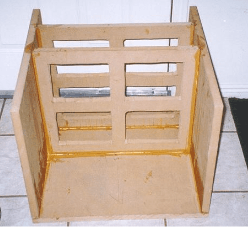

The port and the subs should be on the same side (Yes, that is the speaker baffle). This allows the sub and the port to couple acoustically. In instances where you can't, then the opposite wall would be the next best thing. 2 evenly spaced (unlike the picture) braces should be placed equidistant from the middle and sides internal internal braces would be fine. Like this (but spaced as noted and with the sub placement in mind, at least one in the middle):

For around 1k rms I’ll double up 1/2” for a 1” thickness all around. If doing a flush sub look I’ll add another .75” baffle depending on how tall...
