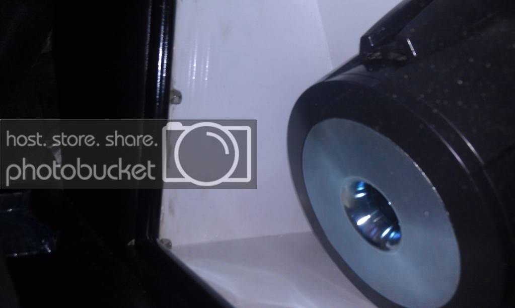

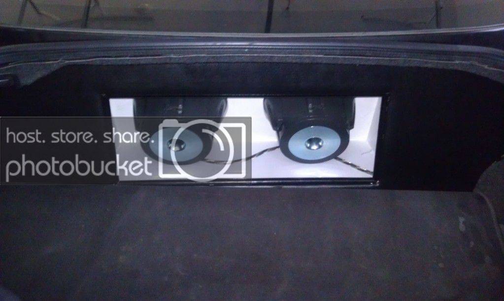

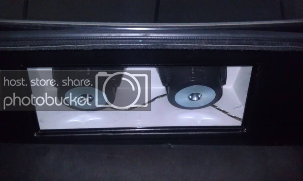

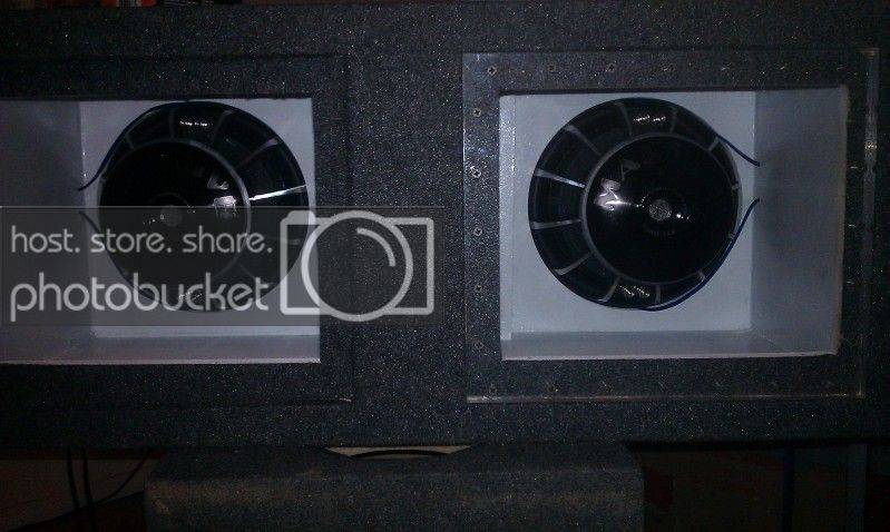

Ok so heres the problem. I have a 12'' x 24'' window of plexiglass. I tried liquid nails to hold it first..... bad idea. Then I bolted it down with nylon nuts and philips bolts. The thing still rattles and its pretty much the only thing that rattles in the car. You cant hear it in the car but the second u open the trunk u hear it go crazy. Yes i silliconed the outside of the plexi so no air gets through. Before i take off my vinyl again and take out the window again I need to get an idea of what I can do. So my question is what material can i put between the plexi and the mdf that will stop the rattling. It needs to be thin as well. I was thinking headliner foam because I have extra but I think the type rs will still pound the plexi though it.
PLEASE HELP! this will be the 4th time taking this stupid box apart lol
How thick is it? Is it flexing? Do you have any pics? I can give you a few ideas on how to fix it.
Most of the time it is best do your glass like this...
It broke..that tells you something right there. It was flexing and broke that bond. Now it rattles.
If you want it to flex but not rattle then put something between it and the wood. I suggest redoing it with thicker plexi though.
**** i dont wanna wait for another plexiglass piece. what if i were to take it out clean it up and re liquid nail it with the bolts in place as well so that it couldnt flex off the bond?
