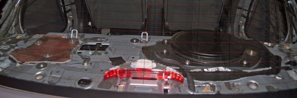

I did the same thing with a 10 on my rear deck. Since there wasn't a flat surface I built one up using fiberglass. I bolted the mounting plate to the rear deck with butyl adhesive between them. It made the entire structure much stronger and completely non-resonant. Also built a fiberglass cover for the empty stock speaker hole on the other side of the deck and mounted it the same way. Added more strength.
Lousy photo:
