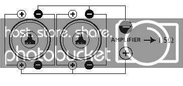

Hmmm, I dunno what kind power they need to get going honestly. I'd think that if ya wired em at 1.5ohms to like a 1200d and a proper box, that you'd be good to go.
so i would wire them like this to a 1200d (are you talking about an Orion amp? are orion amps decent/ will they work well with the JL subs? i don't know anything about them.)
if you are talking about an orion amp, it would be a mono channel amp - rated at 1200 watts into 1 ohm - how much power would this be sending to the subs at 1.5 ohms? ~800 watts? how many watts are each of the subs drawing at 1.5 ohms - if they are 300 watts rms at 6 ohms, what is the wattage at 1.5 ohms?
im just confusing myself some more.
The possiblilities are endless as far as what amps to run. But since you are already talking mono just stick w/ that. At 1.5 ohms you would be getting greater than 1000 watts. Orion is quality product and you will not have any issues with it. You will have to be very careful not to over power the subs though. You may want to consider a slightly smaller amp if the max power handling on your subs is less than 500 watts each. The subs will handle 300 watts RMS no matter how they are wired.
so basically any amp that is 1 ohm stable and provides around 600 -700 watts at 1.5 ohms will work - ill just wire the two subs in parallel and ill be good?
