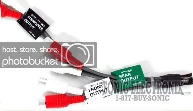

im thinking about ordering that hu but my question is i saw in the product pics that it have 3 sets of rca cables front, rear and subwoofer i understand the sub one but how am i going to connect my front and rear speakers into female rca plugs ? do i have to buy an amp or is there a wiring harness that also comes with it
not to say your dumb or anything but the question is, your contradicting yourself.
ofcourse its going to come with a wiring harness for you to wire your unit up, and the rca output sub/front/rear is there to hook up an external amp, you need cables to hook that up, rca's that go from the headunit to the amp. based on what your asking thats the best way i can put it. Not all pioneer models have built-in RCA outputs on the back of the unit. Some have em and some have the RCA ouput cords, just like the one you have. I believe the 780,880,980 have rca cords.
