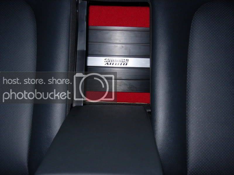

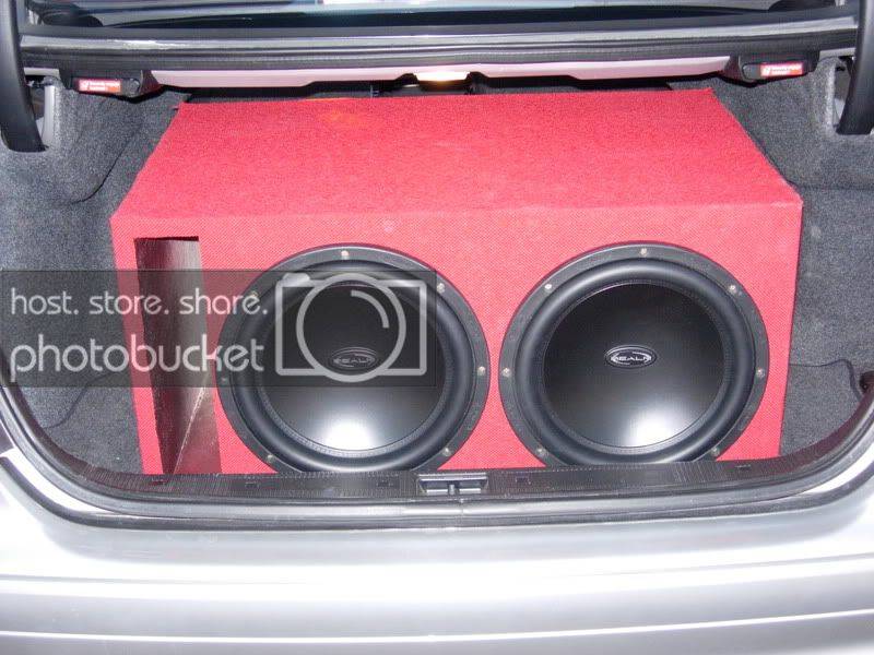

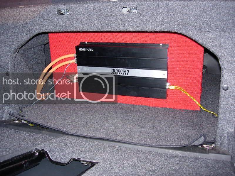

Well, I've been on this forum for some time now and I finally got everything in to where it's presentable. What I got:
2 Realm Audio 12" D4, powered by a Sundown 1500
EclipseAVN 6600 HU
Batcap 800
STOCK 150 amp alt.
I would like to thank a few people that have helped me out with this:
Immacomputer for talking me back into going ported and designing my box, really great asset around here; box: 2.7 cu. ft. tuned @30hz.
Sundownz for selling me this GREAT amp back in OCTOBER!! (it's taken a while to get everything and all the time to become avialable)
scissors for these AWESOME subs!!!!! These are the BEST SQ subs I have EVER owned!!! Right up there with the best if not a better SPL/SQ hybrid.
Well, here are the pics and vids. I would love to hear (see) some feedback! All work & build done by me; nothing show stopping but fairly clean. I don't know about the sound on your computer, but I tried my best. On a TL, I think it would be somewhere in the 143-145 range. SQ is amazing and hits everything accurate, quick and will get low.

What type of material did you cover the enclosure with? The texture looks interesting but the color isn't really my thing!
I'm glad you're happy with the setup and the install looks pretty clean. Did you ever try the MMats subs in there? I am curious about how the two compare.
Yeah, I figured a box should be something "out of the norm" in color plus red looks good with silver. The material is tweed and is a ***** to work with! It doesn't cut easy and if your glue is not completely dry it will seep through because it's so thin.
I did try the MMATS subs and they did get loud and sound pretty decent, but NOTHING like these Realms. It seriously is like night and day especially at low to mid volume levels. These subs sound really natural to what you are listening to and the box doesn't breathe either so response is on point with no grouping at all in frequecy changes.
If you don't have them already, I highly suggest rubber feet on the amp having it mounted to the enclosure.
Otherwise, looks great //content.invisioncic.com/y282845/emoticons/smile.gif.1ebc41e1811405b213edfc4622c41e27.gif Glad you like it!
those puppies are moving alot off that one sundown
These subs are 400 RMS and 800 Peak. According to my DMM settings, they're seeing about 12-1300 watts (35.5v).

so by ear you thinking its doing a 143-145 thats incredible especially for 1500 watts @ 30hzs....
Try and get it metered and see what the number is //content.invisioncic.com/y282845/emoticons/wink.gif.608e3ea05f1a9f98611af0861652f8fb.gif
none the less nice install
