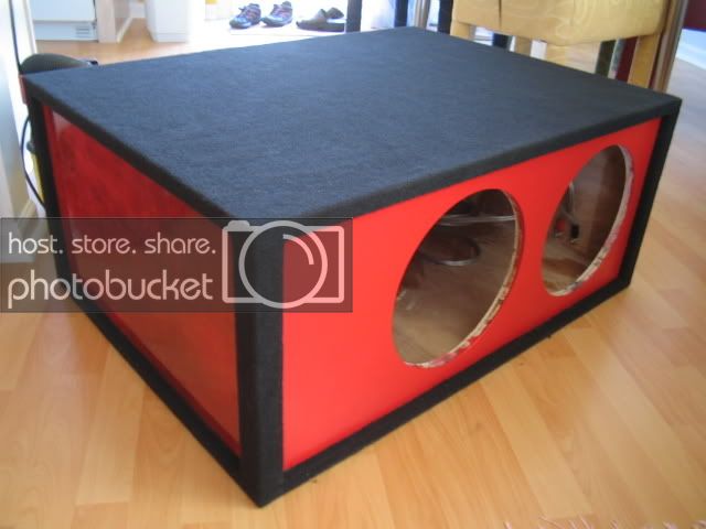

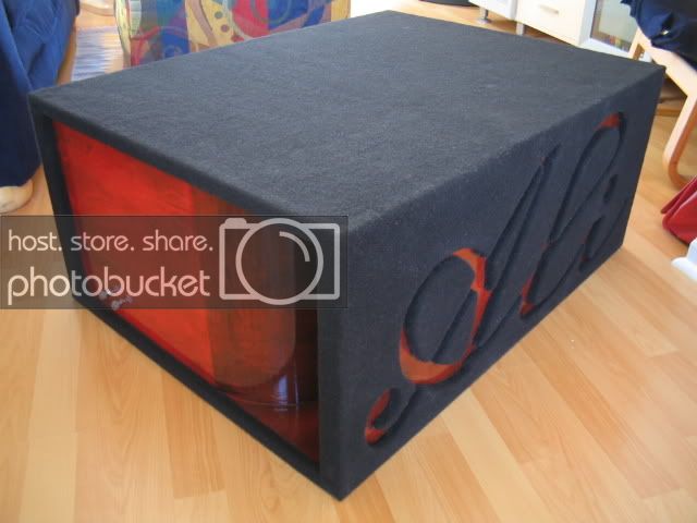

You could do subs forward and ports to the side....that seem to work pretty good in trunk cars, something like this
One of Belunts boxes:D:D
Very nice box.. I MAY try that, although I still worry about the air space from the face back.. its very blocked off.. I will have to see what I have to work with.. thanks a lot man..
