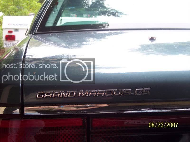

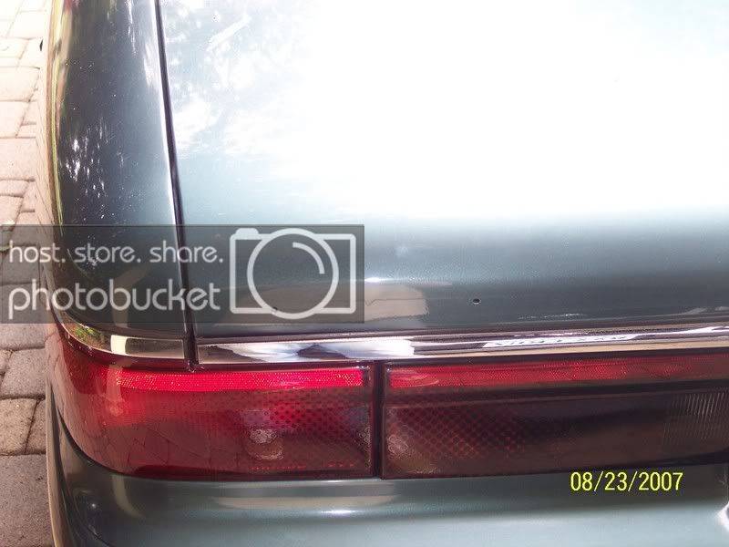

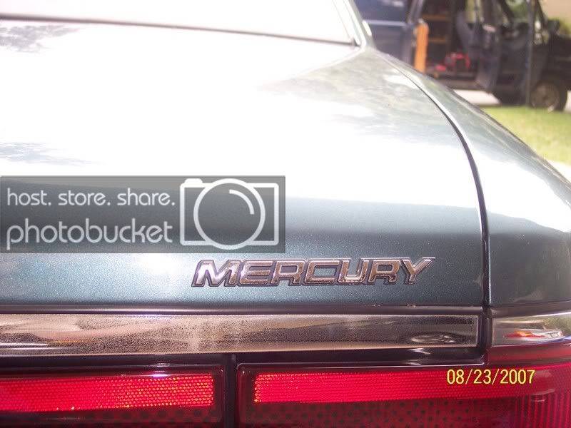

I want to debadge the back of my car, It seems like they are stuck on my two sided tape, I dont know if there are holes in trunk lid or not, Is there any way to find out before taking them off? If not How hard is it to fill holes? Just use bondo and sand/Paint?
Sorry If this is a dumb question, The **** emblems are faded bad now..Just want to take them off since I cant find standard one's...Anyone know where i can get them actually?
I would like either crown Vic or Maruader badges!
Thanks for any help, if its a dumb question, Whatever, Gotta ask them to learn

Most Fords have little post on the back of the badges that line up with holes in the panels.

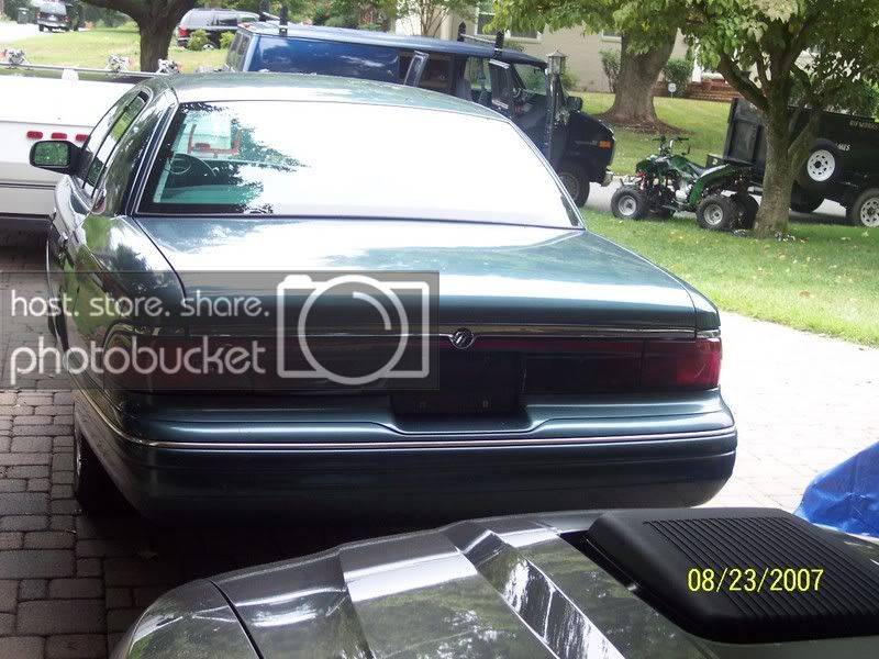

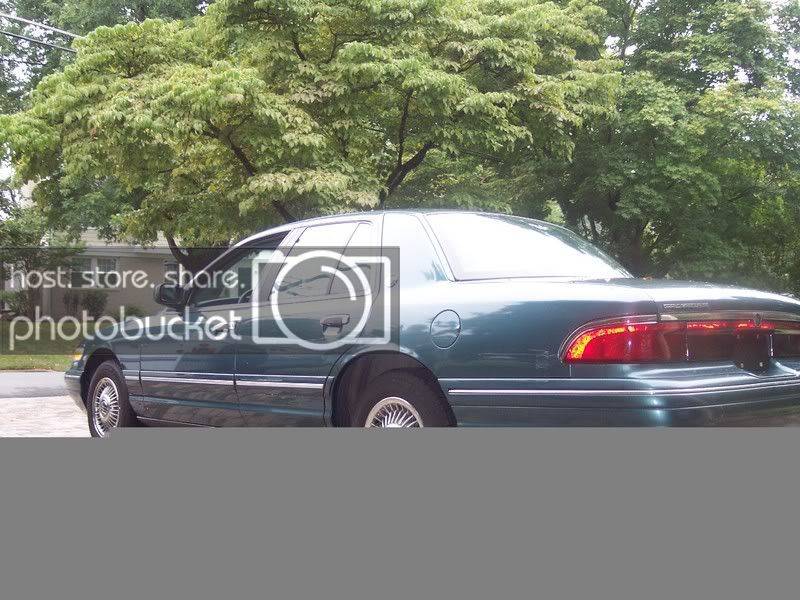

The Victim....
Bondo to come next, The whole car will be repainted soon, Have a couple dings to get out, and some sanding, and fabbing to get Marauder bumpers, and front end to fit on.....
