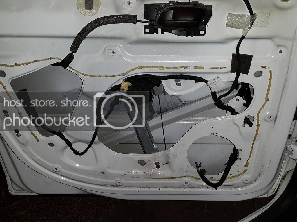

The Big holes....... Are there any disadvantages to just covering them with sound deadening? or should i rather get me some thin aluminium plate and knock it into shape, then cover it with sound deadening? ive taken a photo for reference.

Ok so with the "Professional install" Chipboard speaker ring still in there i noticed the window when rolling it down pushed against the JBL speaker if i held in in there so obviously i need to space it even further out so that the window doesnt make contact. but that has me wondering that if i have two spacers stacked and sealed on each other, will i lose sound quality because i am lengthening the tunnel in which the speaker sits? (for those wondering, yes ill make proper MDF ones)

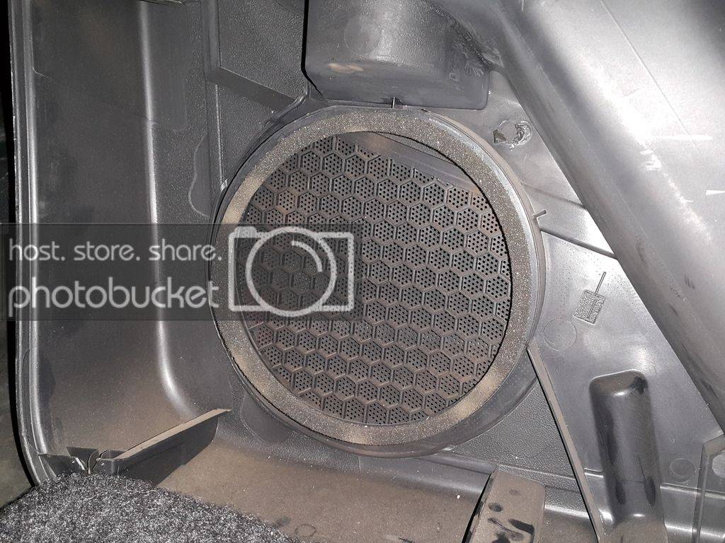

then came another question as i was checking if there will be enough clearance to the doorpanel from the front of speaker, and after some measurements and looking in the gap with the door panel semi fitted i realized ah hell no! the door panel speaker grille is miles away from the speaker! which made me wonder if sound quality gets lost in the door panel if the speaker does not seal up against the grille?, i mean what else is the foam surrounding the grill for? ive attached a picture of the inside of the door panel with the foam surround. is it a good idea to put some SD strips on the plastic panel also?

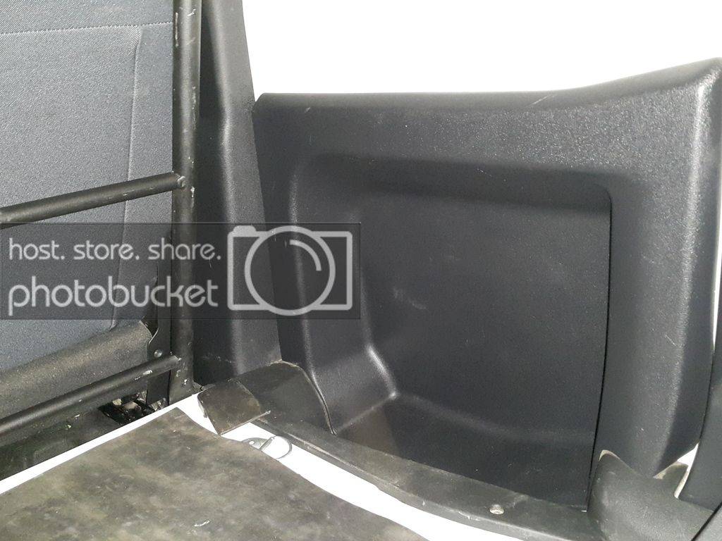

Placement and box build For the placement i found a nice spot right behind the driver seat that wont obstruct anything and conveniently for me is deep enough for my woofer. so if i measure the liters correctly i can make something nice maybe with some fibreglass and effort here. I also plan to adding some SD where ever i can without going balls to the wall inside the tinny cargo area. any input and tips are appreciated obviously //content.invisioncic.com/y282845/emoticons/smile.gif.1ebc41e1811405b213edfc4622c41e27.gif

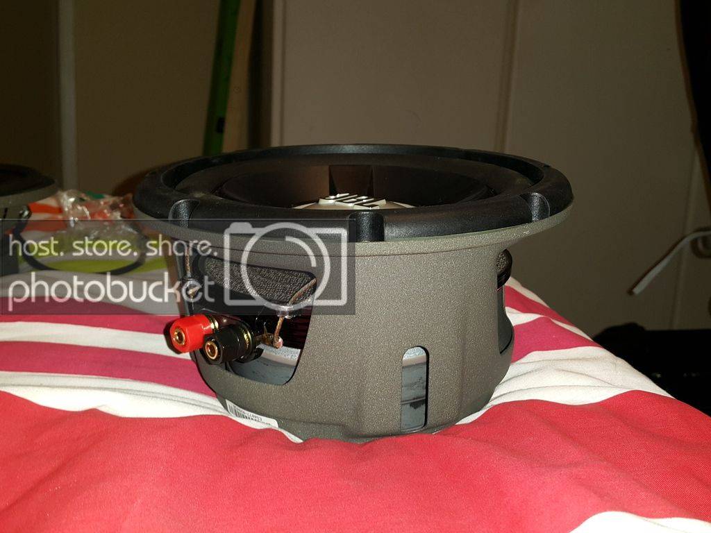

also attached some pics of the subwoofer and also the place where i want to mount it.
Planning to go sealed here.

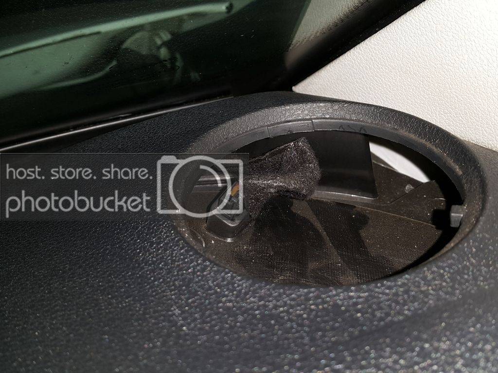

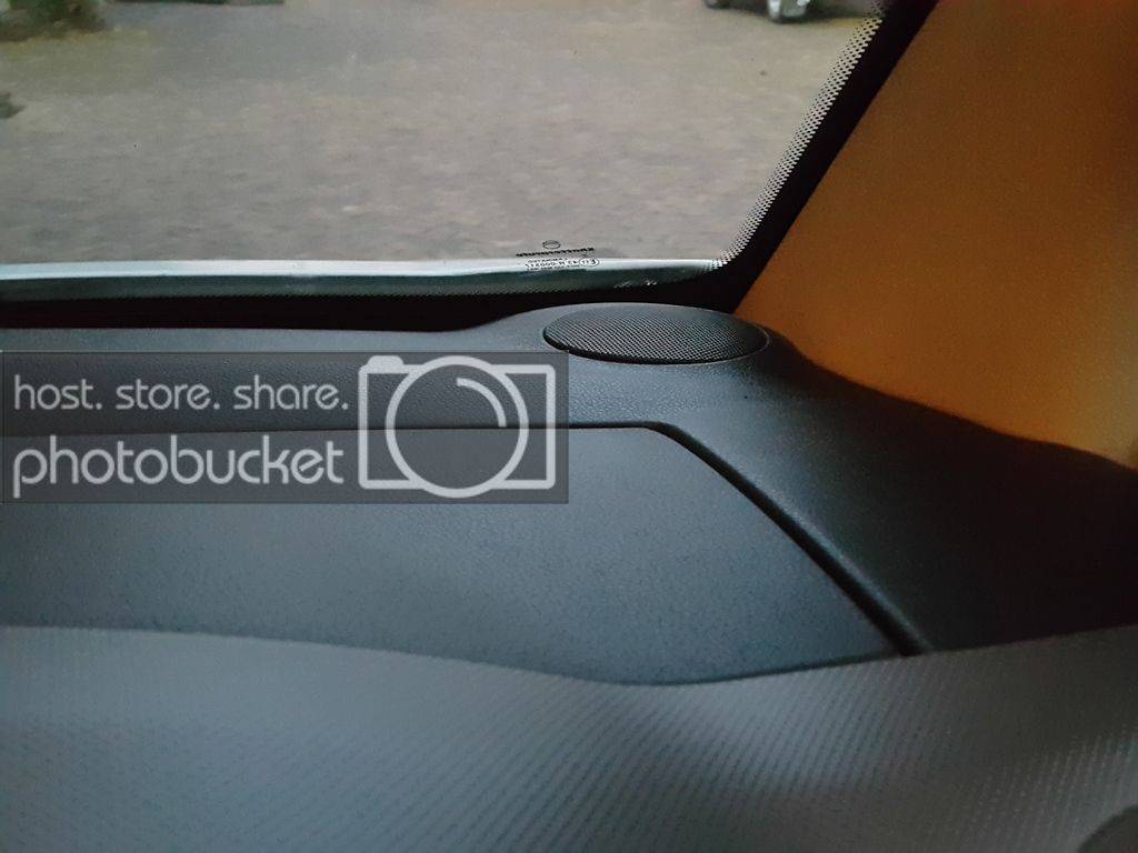

The Tweeters
So should i mount stock or make a mod? unfortunately i dont have vast experience in what tweeter placement sounds good but thats why i have you guys right?! the stock tweeter locations seem to be firing upwards into the glass. i suppose the idea is then that the glass reflects the soundwaves to the person behind it OR peugeot could not give a **** where it is, as long as it has a place to go? //content.invisioncic.com/y282845/emoticons/laugh.gif.48439b2acf2cfca21620f01e7f77d1e4.gif regardless i dont know how they will sound because there are no tweeters under the covers anyways haha.

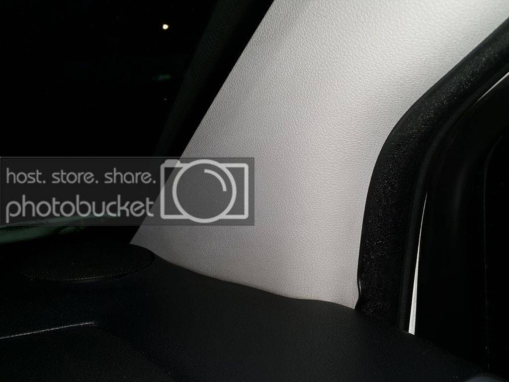

If you guys think i should mount the tweeter in the a-pillar, then could you please give me a nice link with some fabrication tips for such a thing? also took a pic of the pillar for those interested.
