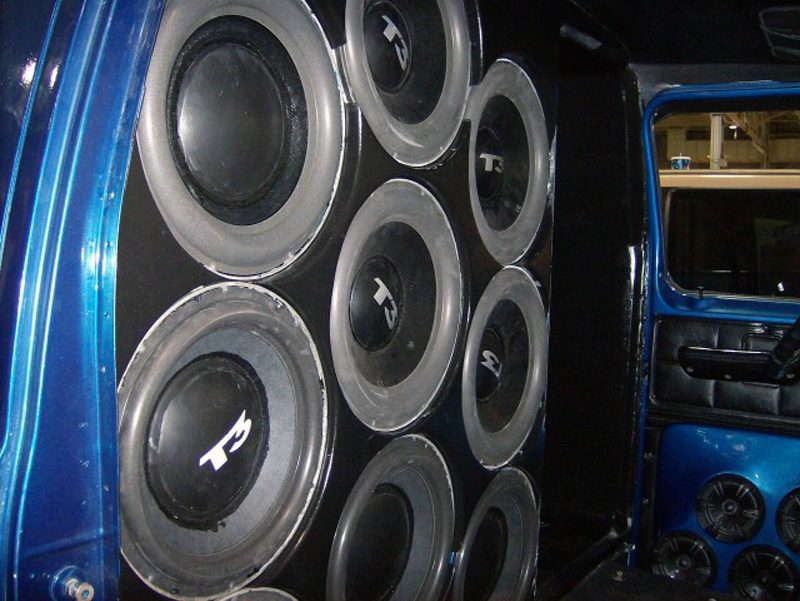

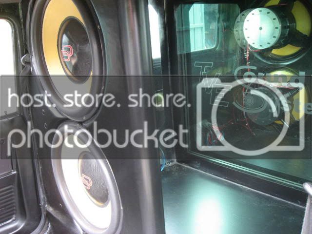

Just incase you really are living in a dream world heres a few pics of the loudest vehicles inthe world with the port on the opposite side of the sensor...in various classes aswell just so you dont think its based entirely on one class lol //content.invisioncic.com/y282845/emoticons/rolleyes.gif.c1fef805e9d1464d377451cd5bc18bfb.gif Ur a piece of work.
Bob Perillos Van superstreet 5+ 168.7 db sealed on the TL
Peter Augustijnen Superstreet 5+ 169.7db sealed on the TL with only 6 amps
TVE Soundsystems Superstreet 1-2 169.7 db sealed on the TL
Car Audio Performance from Greece. Street Max 165.7db sealed on the TL
and even in a no-wall class its louder on the passenger side.
Team XS SPL Jeffrey Superstreet no-wall 164.3
To answer the question to the original poster...start buy putting the port onto the far drivers side. Guaranteed once your port is tuned that you will gain quite substantially. Id estimate probably 3 or 4 db right away. A 4th order or even a 6th order bandpass would also be an interesting build to try aswell considering you have the space.
