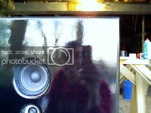

This one didn't come out like I wanted it to but it still looks decent. It's not blotchy but it doesn't have that "perfect" mirror finish.
dang thats some serious orange peel you got there.
