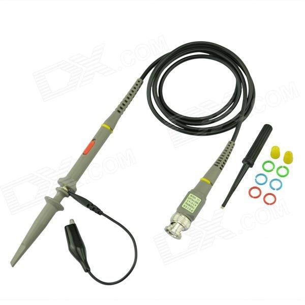

Could we take one of these. Which is a 10x probe with a weird connector.
then use an adapter so it fits into our nano.

nah they measure up pretty high and come with a 100x probe thats mislabeled as a 10x probe usually. looks just like the first pic you posted. keep in mind these are likely mass produced in china and sold on ebay for as cheap as possible.

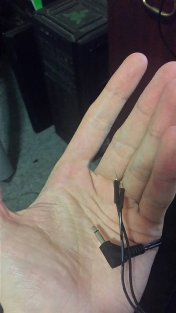

My dso nano v3 came with these dinky "probes". Nothing close to the probe in my pic. With those i cant even see my subs full output at 1k.

you got a ****** probe then lol i mean you are changing the y axis to fit higher voltages right? you can always buy a replacement probe like the one in the pic i doubt its more than a few dollars

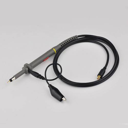

What does your probe look like?
This is what mine looked like. I wasnt able to go past a certain gain on my 1k before i hit max setting.

Not following you ? You mean to run it in the dash and to hook to speaker wire ? I dont think the connector is the same as yours ? Mine is like the one on the second prob pic i sent ya ?
