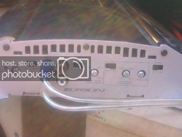

ok here is the pic i hope it all works right
[/img]
it is set on gain... i found that this switch doesnt make alot of difference
second switch is on 24
low pass is at like 80 or there abouts
hpf is on set at right above 30 hz
intelliq is a little more than 1/4 of the way up still sounds like i have a 10 in my trunk...
