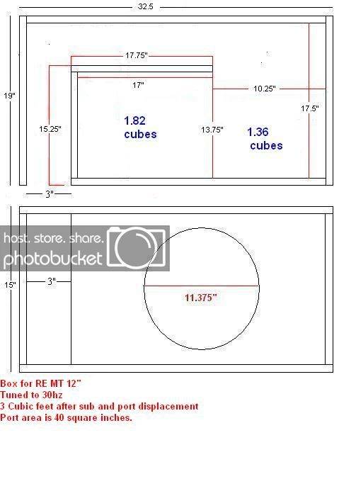

I have a orion 2500d also and just ordered a 12" RE MT
I dont want to have the same problem with my box as he is having.
Any suggestions?
Here is a pic of the box I was thinking of.
Maby I will get You to build me one.
