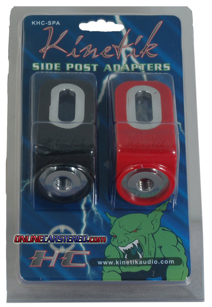

hmm looks like i have a plan B if the optima fails.
Here is a LINK for $23.
